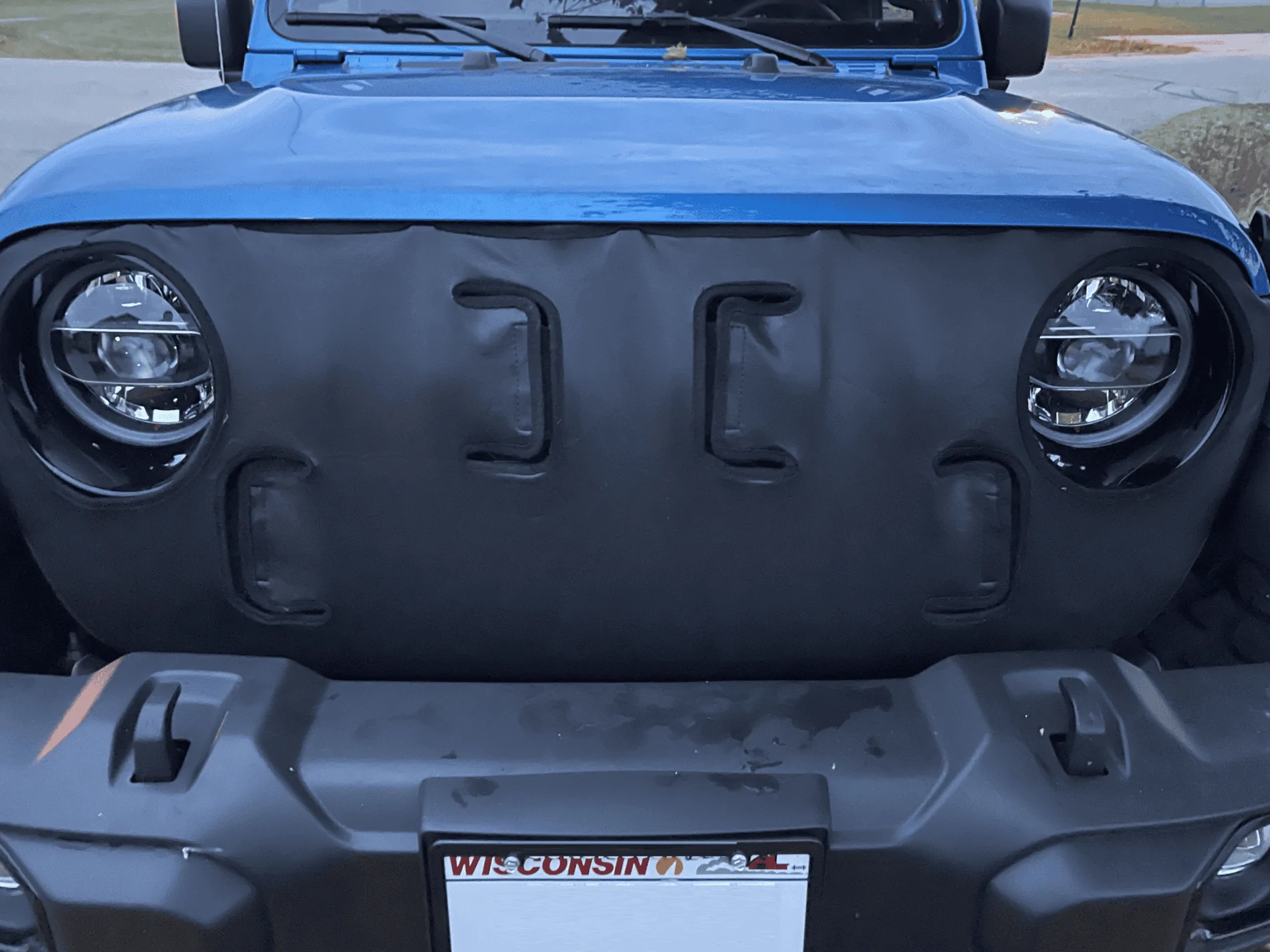

Literally right after I buy this ugly nostril cover I find this post!
I'm going to assume the extra cold in WI over Kentucky justified this purchase lol.
I'll buy it off you if you make me a deal :LOL: In Michigan right now and it's getting cold.
But back on topic, heating of the cabin is a non issue especially with remote start and heated seats + steering wheel. Also one of the posters is right, the diesel comes with an extra heating element. I think you can find it in your build sheet.

Cold weather update and findings:
1) Currently in MI. Car starts easily in 20s and 30s outside temp even overnight
2) Idling 10-15-20min in freezing temperatures does not decrease oil temperature. Tested down to 25F now
3) Car warms up very quickly when started dead cold and driven with low load. Oil gets up to temp quickly and doesn't go down
4) Car can reach 220F oil temp very easily in the cold. This hasn't been the case even with gas engines I owned
5) All of this data is low load only, no towing. People/stuff carrier
All in all I think this car is totally winter proof. They run hot even in the winter which is consistent with what diesels like. Along with the block heater they are great winter vehicles. For now there is no reason to buy the grille cover
