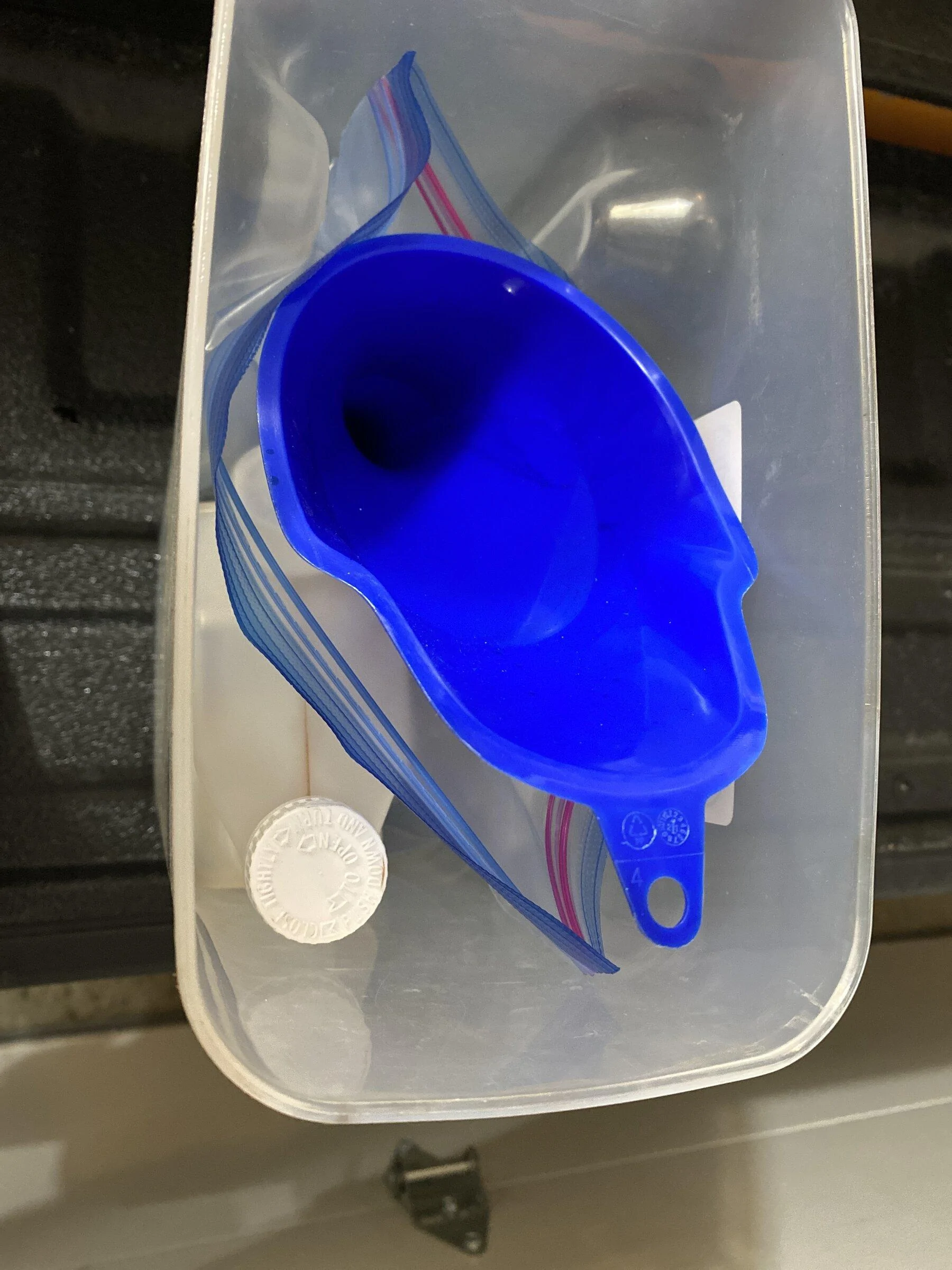

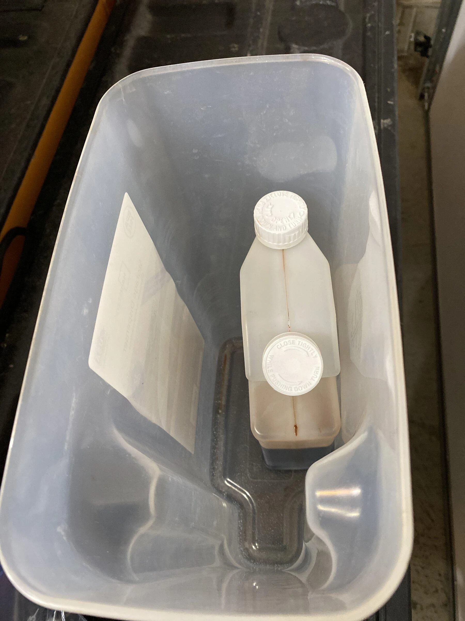

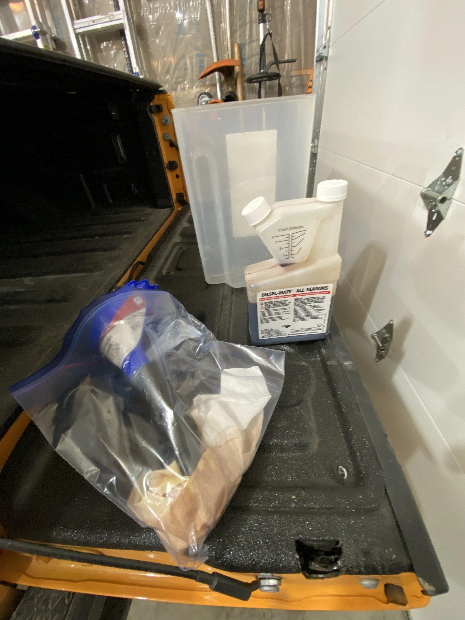

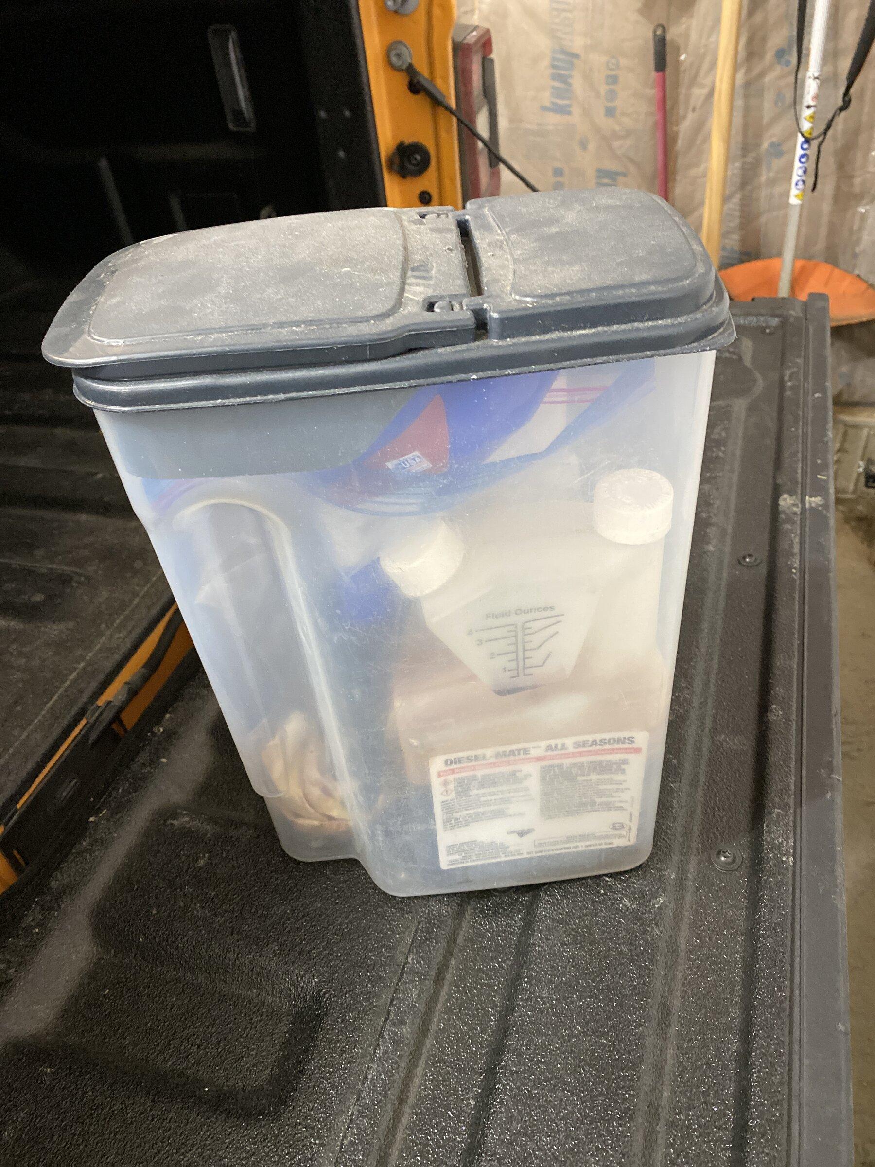

About 2.5 to 3 depending on how fricking cold itā€™s going to be. I fueled up on Monday after work and went with 3 oz to full tank (was on ā€œEā€) as the high for Tuesday and today was sun-zero without windchill. Will be -15* tonight.
Summer time closer to 2.5ish for full tankā€¦mostly for the additives not dealing with pour point suppressant.
Just remember to put in before you fill the tank so it gets mixed in and to use it in ratio ( cut in half if just filling 10 gallons for instance).

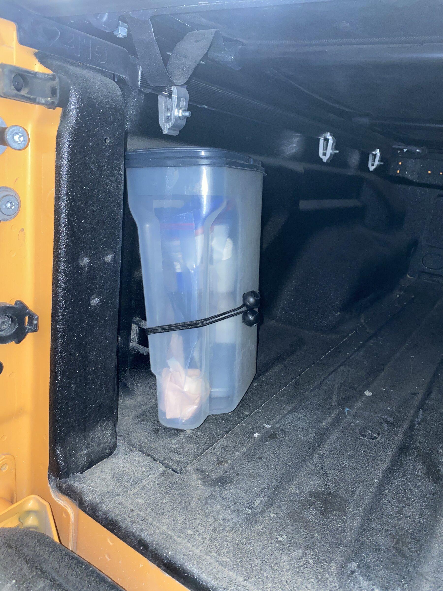

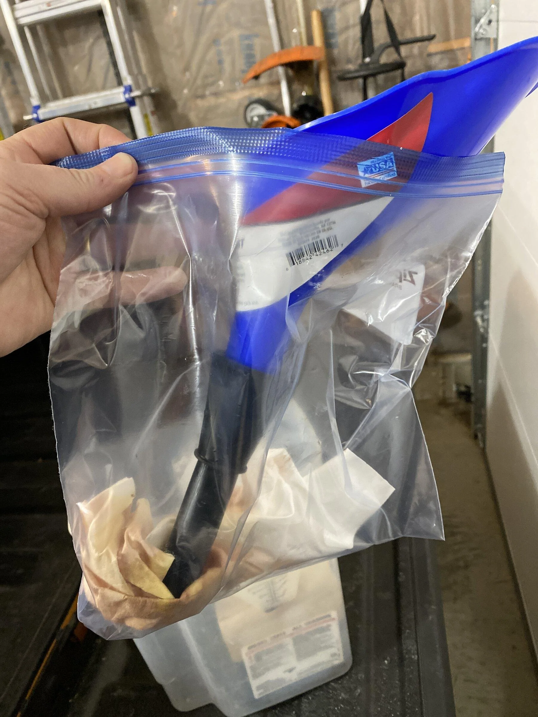

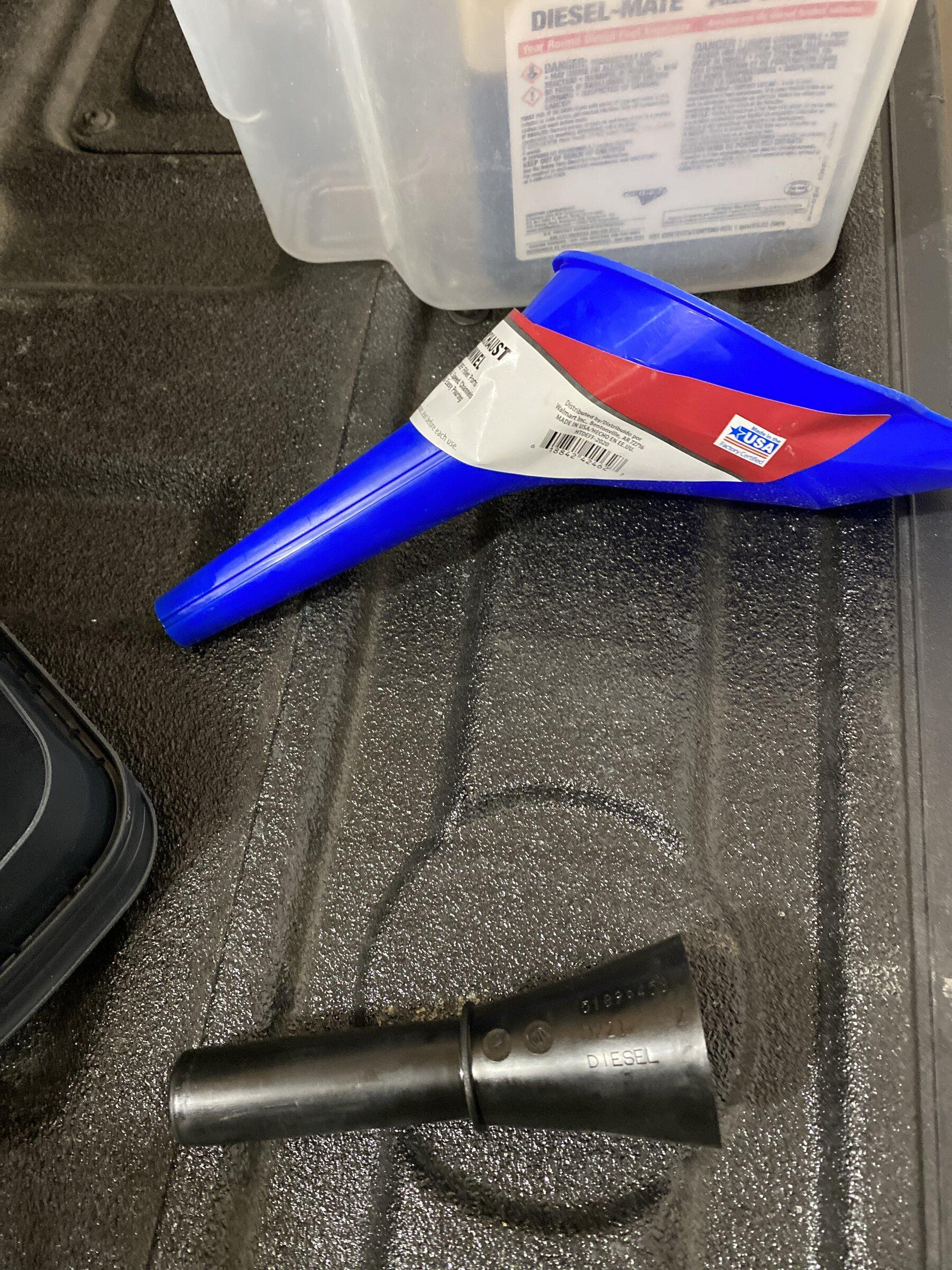

You WILL NEED the little black funnel under the rear seat, and I found a funnel with longer spout to go into that one helpful as the factory one doesnā€™t give you much angle to work with when pouring from bottle to funnel. I keep funnels and additive bottle in ( donā€™t laugh) a Tupperware container meant for loose cold cereal as it is tall and slim.
I put a folded paper towel in a gallon ziplock back so it keeps dropping from funnel contained and separated from additive bottle over time.
The overall container keeps all potential spills contained and smell to a minimum if it does.
As I donā€™t haul a lot of stuff around, I use bungee cord to keep it in place by drivers tailgate tie down for easy access when needed.
See pictures
