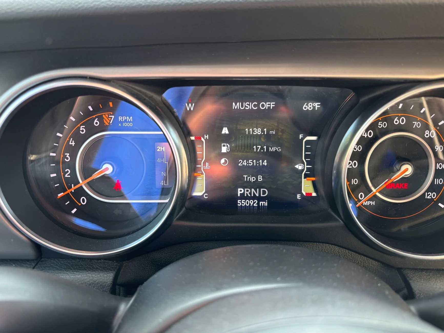

Changes from previous trip were approximately 375 pounds with passengers, luggage, gear and cooler. Trip was driving on interstate, state highways and rural backroads with little change in elevation with undulating terrain. Average fuel economy on the way down with 125 miles driving an average of 56 MPH, sustained speed of 70+ on interstate roughy 85 miles with very light traffic, and 45-60 MPH on state highways and backroads the remainder. Trip included 7 stoplights that I stopped or slowed down for and 5 stop signs. I had a regen 21 miles in and no significant wind. Average on computer was 24.6.
On the way home today we had significant headwinds. Cold front coming in. I didn’t reset the computer but the average fuel economy dropped to 23.6 by the time we got home. Hand calculated for entire trip was 22.9.
