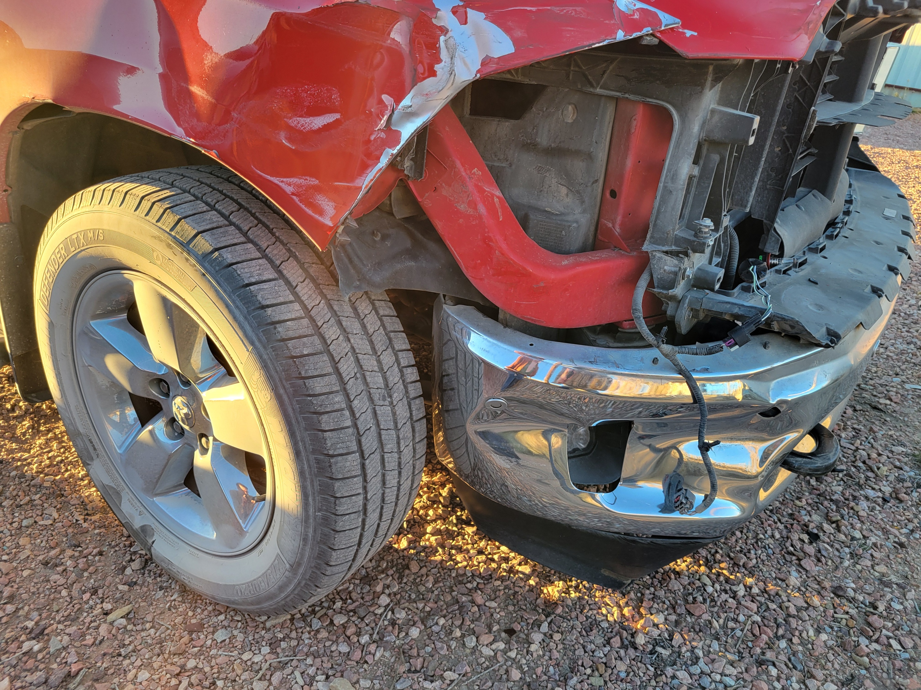

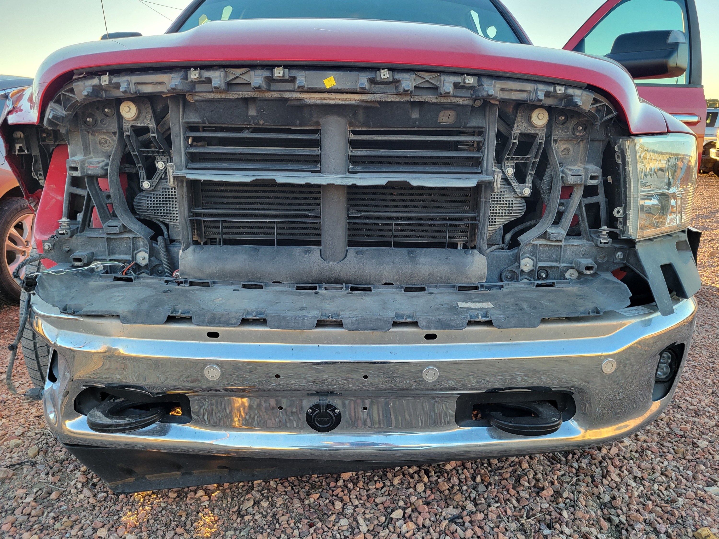

Our 2015 EcoDiesel was taken out of commission back in early November (pics below). It probably won't be out of the body shop until the middle of February. So, the 2023 Gladiator EcoDiesel has been our daily driver for the last 3 months. The Jeep is driven 8 miles one way daily, then 8 miles back home. I plug in the block heater and BatteryMINDer every day when I get home. Is that required? No. That's just habit on my part and both cords are waiting for me when I get home.

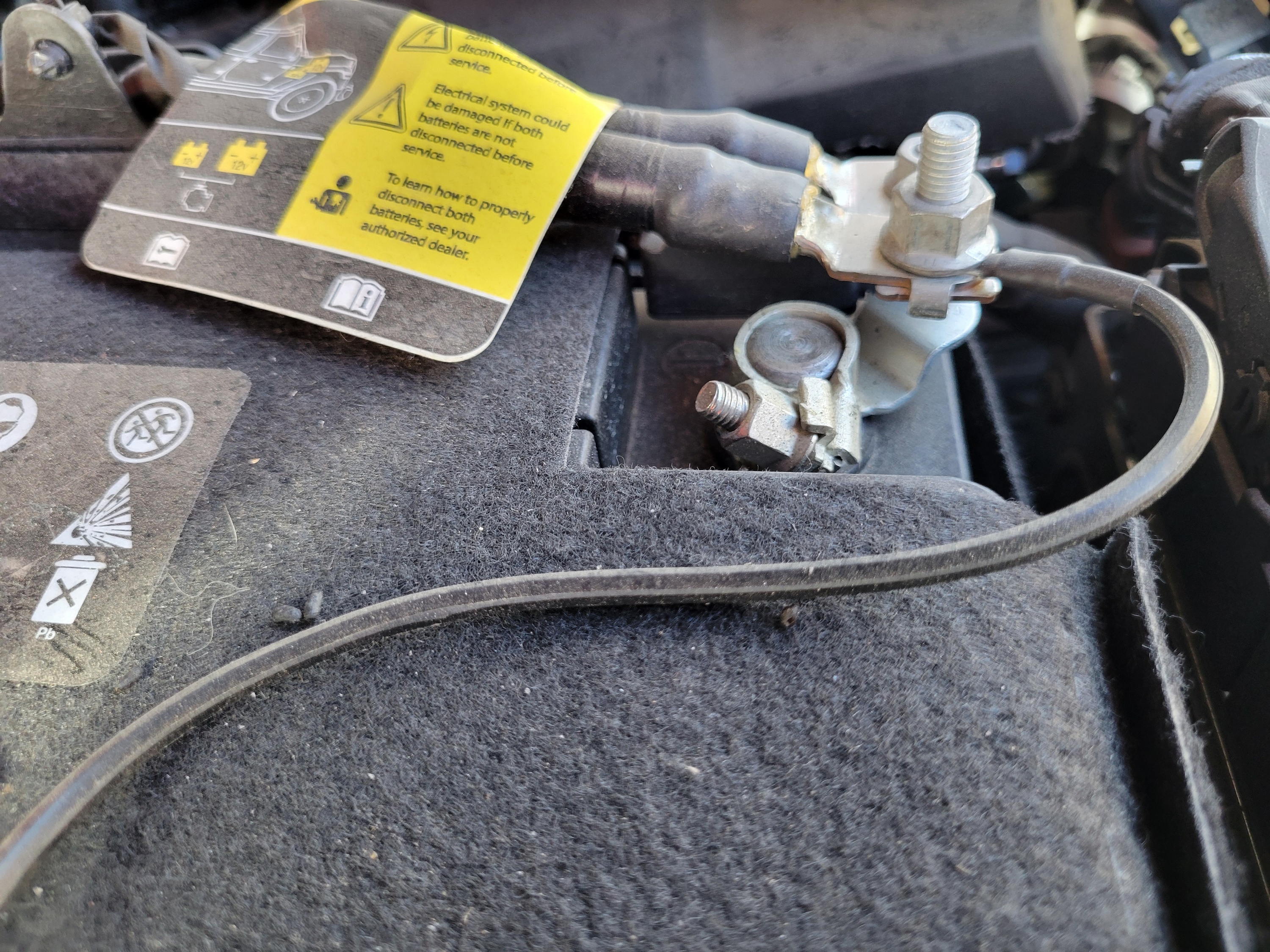

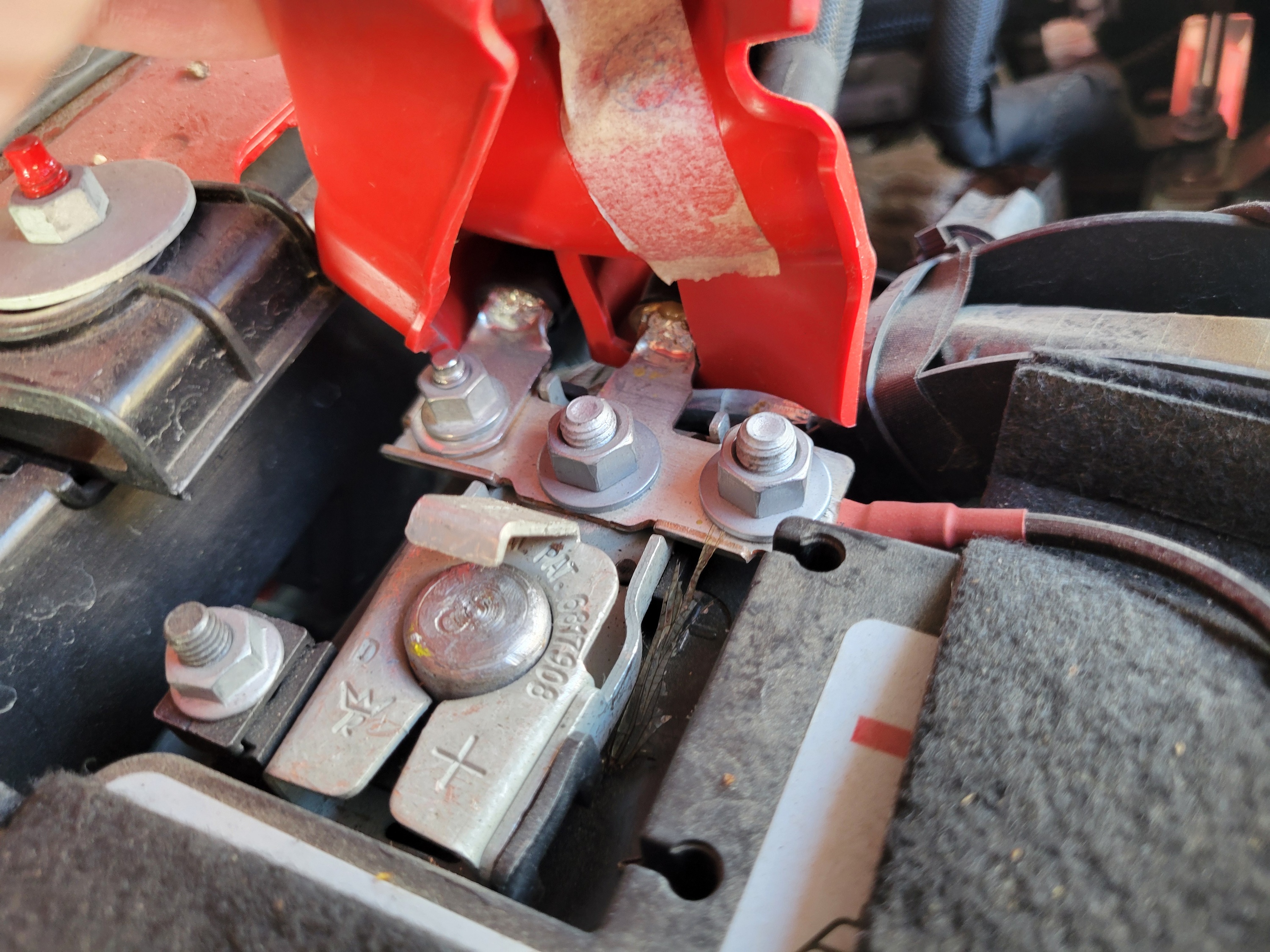

Before I forget, regardless of charger/maintainer/desulfator used, make sure you go through the IBS. If you bypass the IBS, then there will be a false reading. In other words, the IBS can't track amperage going in and out of the battery.
