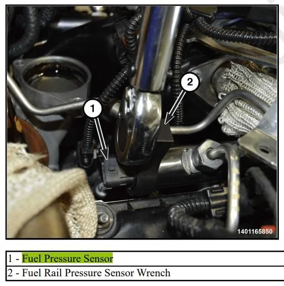

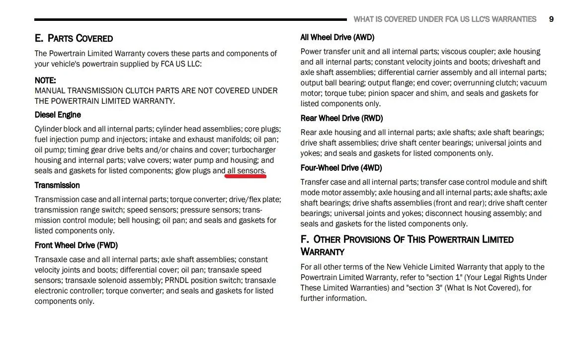

While the sensor isn't cheap (approx $450 list), that job is in no way worth $1400 in my opinion. We're talking almost $1k just for labour there for what I'm reading shouldn't be more than one hour of work, tops. Not to mention, the way I read the warranty booklet, it should be covered under the 5/100 powertrain warranty.
Jeep Gladiator Cold Start Issues diesel warranty
Jeep Gladiator Cold Start Issues diesel fps
That's the same sensor that the Banks Derringer plugs into.

i was able to get the dealer to submit for a goodwill warranty cover and just have to pay $130 deductible now. Better than paying $1400, but still curious why this wouldn't be covered by the 100k mile powertrain warranty.
