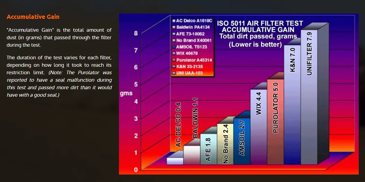

They let too much dirt through, they are among the very worst for dirt allowed to pass. They also fill to capacity faster than most, meaning you have the advantage of freer flow for a short time, then they lose their free-flow advantage, and let dirt through in the process.
This isn't just internet lore - it's based on ISO dyno testing.
Other similar dyno testing showed that the only flow advantage was up in RPM ranges most people would never see unless racing. How often to you drive with your engine running over 4,000 RPM? On a Ford pickup, the advantage was over 5,000 RPM. Even the LS in my chevy didn't see 5,000 very often.
Here is one chart showing the dirt that PASSED THROUGH the filter, into the engine, before the filter reached the restriction limit- it shows that K&N allowed the second most amount of dirt to pass, and it's possible it came in second worst only because it "plugs up" faster.

Because it's true. Check out all of the times I've posted test results, official dyno testing done to ISO standards. They are marketing hype trying to appeal to high performance people who want higher RPM horsepower. People buy into that "cool factor" too easily. It must be good, because I was told it was good and they say it boosts HP.
If you drag race, go for it, if you keep your engine RPM up over 4,000-5,000 RPM and like to clean filters quite often, go for it. You might gain a HP or two, but at the cost of letting dirt through.
Ya know how they can tout better air flow? Bigger holes.
I like my cars and trucks. I'll use filters proven in legit testing, not company sponsored marketing hype, to protect them.
Why use a filter that lets more dirt through for zero gain in performance? Why?
