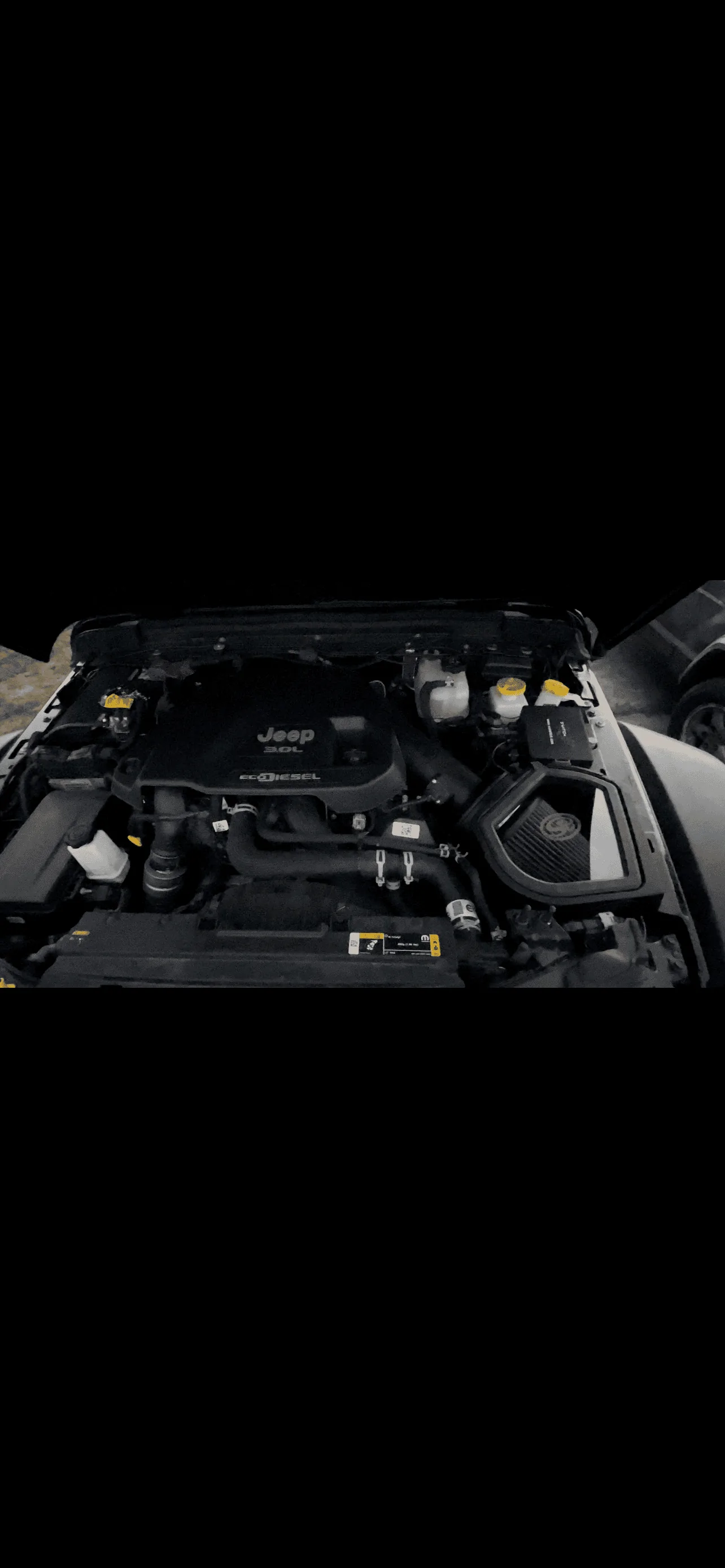

Had the S&B installed about two weeks now. No check engine lights. It's noticeably louder at low torque / early turbo spool, but it has been too short of a time to tell any differences in mpg, or anything else for that matter. Though anecdotal, the old seat of the pants measurement doesn't notice anything different on the pro or con side of the house.

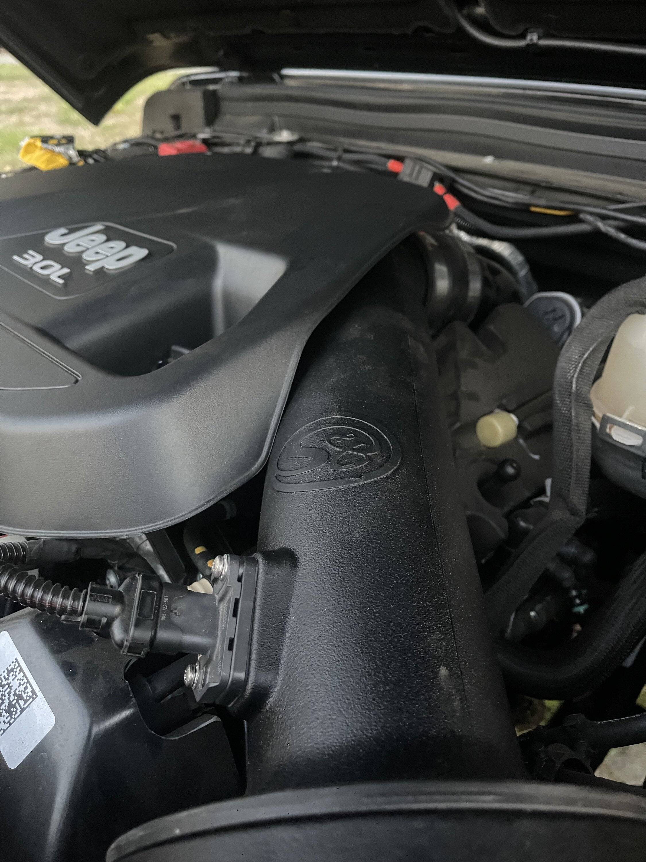

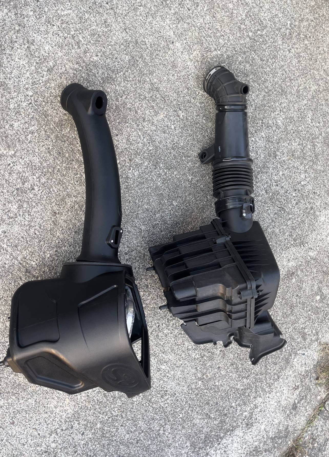

Just got mine installed. I noticed during the install the clearance is tight between the cover and the ccv hose and the intake tube.
Jeep Gladiator S&B COLD AIR INTAKE IMG_8994
Jeep Gladiator S&B COLD AIR INTAKE IMG_8991
Jeep Gladiator S&B COLD AIR INTAKE IMG_8997
