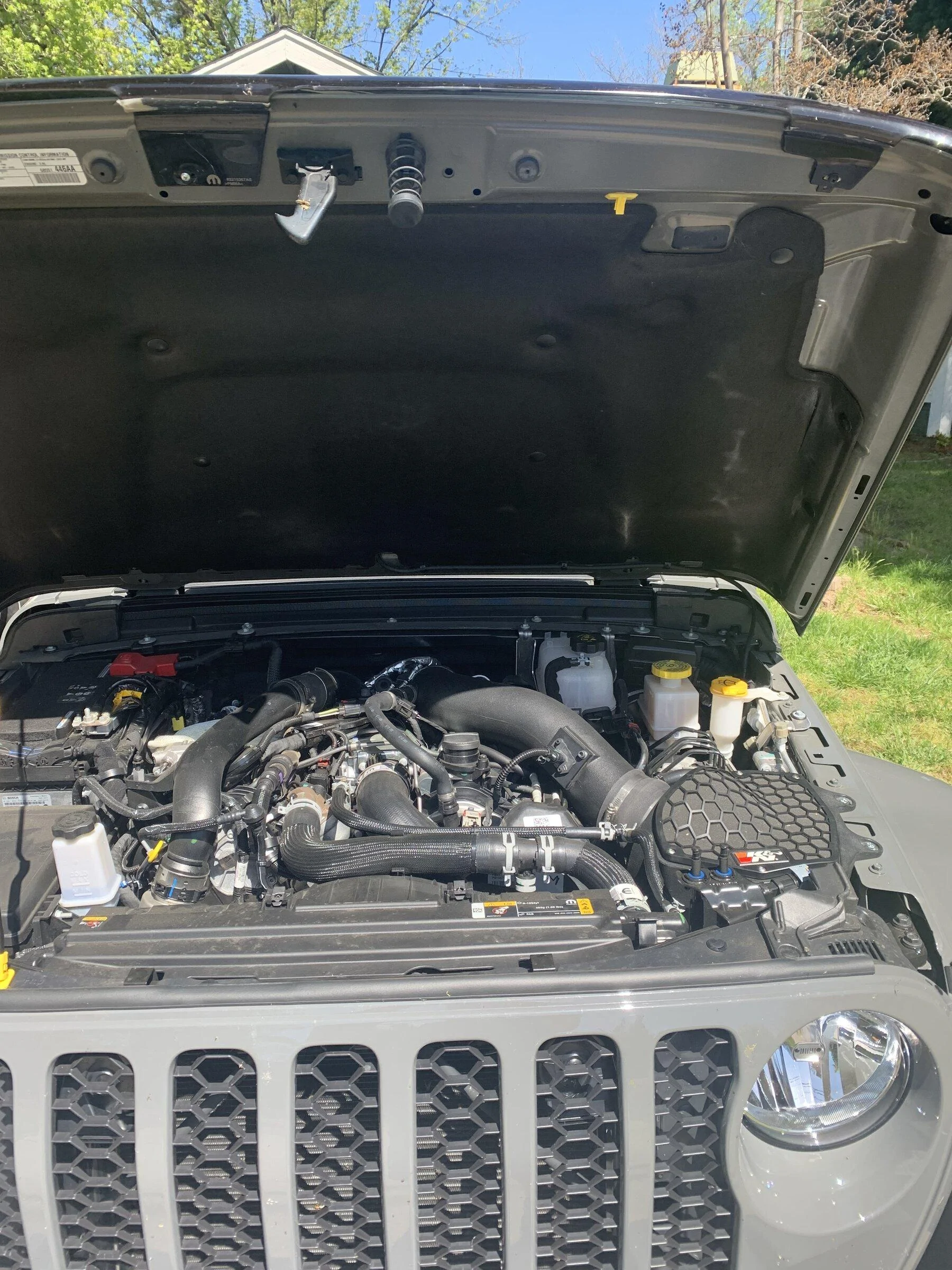

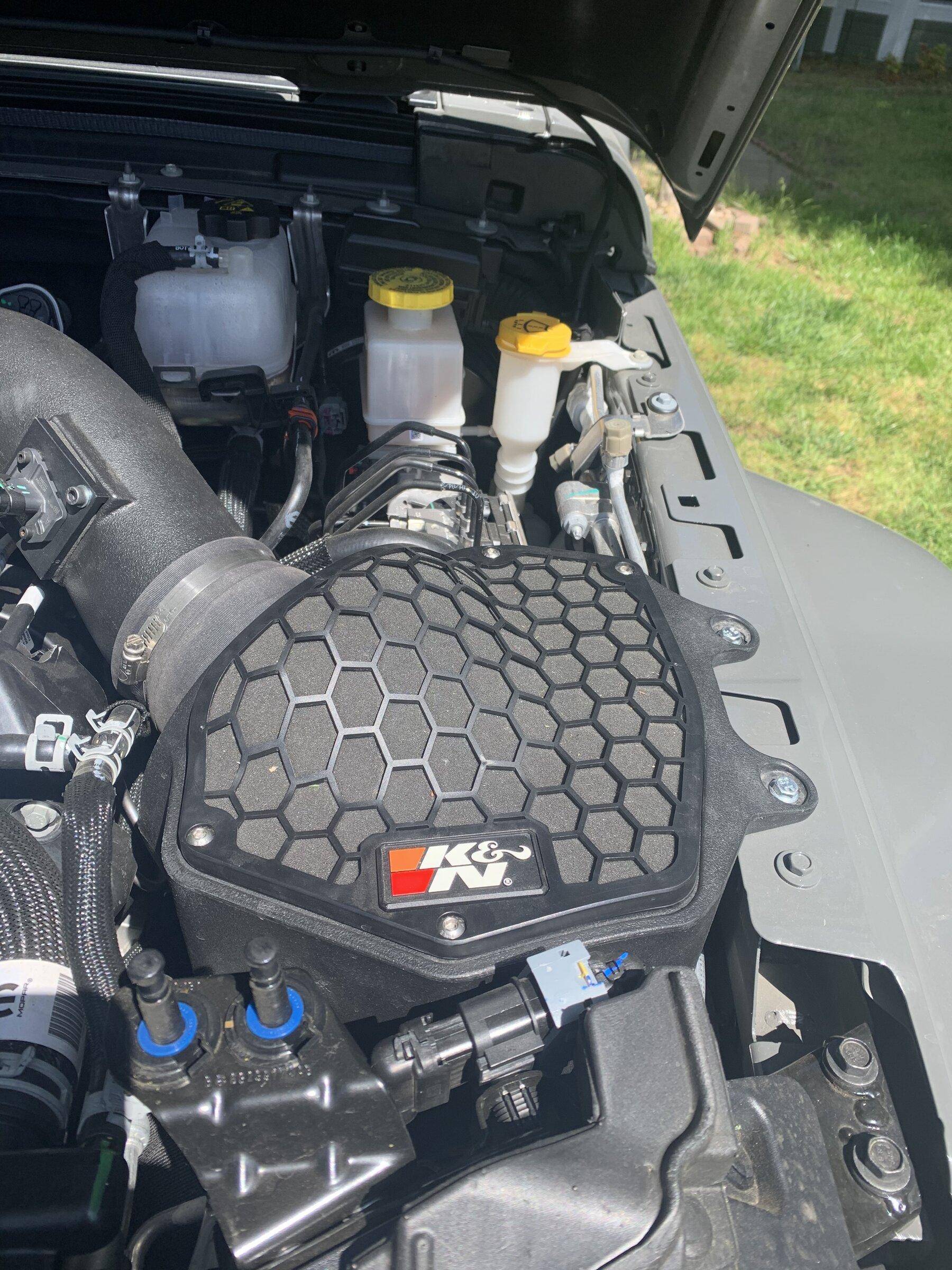

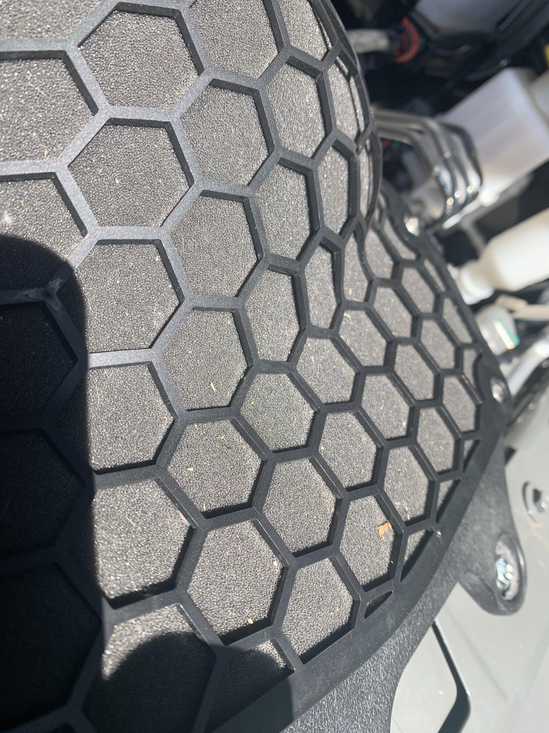

Looks like the pre filter is filtering. I’m going to grab some notoil filter material and upgrade the pre filter.
Jeep Gladiator K&N cold air intake 4FDFE39F-423C-44C4-B227-9770A4986E5D
Jeep Gladiator K&N cold air intake 59AAAC01-E367-41FC-A324-D5DF18927CB4
Jeep Gladiator K&N cold air intake BDA60669-0F17-4DB0-A454-1A1955CCE5A0

How are your IAT before and after ?
There is no change really. There isnt a power increase BUT when you first roll the throttle on prior to a downshift it spools up and hits full boost a bit quicker.
I imagine with a derringer it will be better. I am going to definitely look into pulling the CCV tube OUT of the intake stream a bit. It sticks WAY into this intake. Likely to prevent a CEL due to the larger diameter intake tube and less vaccum on the ccv?
Something to look into for sure.

That being said the one pictured above looks like a better system than the cone filters alone I’ve used in the past. If you could continue to report future findings it will help the community make informed decisions in the future. Thanks for posting the pictures!

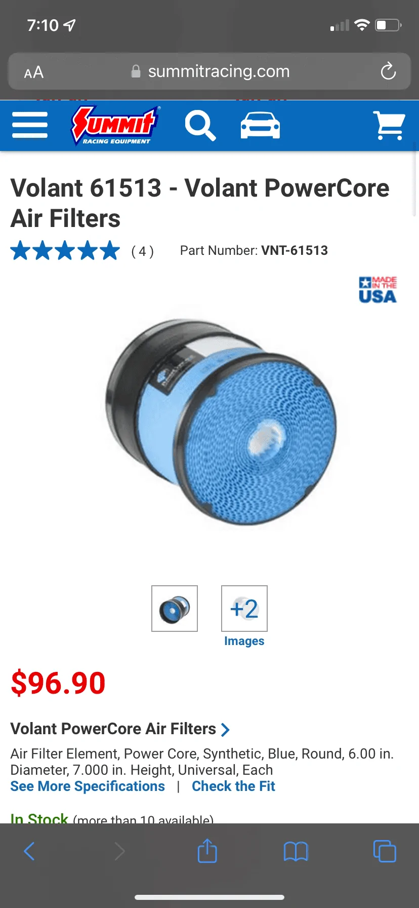

FYI everyone scared of KN filtration. This Donaldson power core fits ?
Jeep Gladiator K&N cold air intake A6B393B3-039B-45D7-9322-BF54B7BC8DC5
