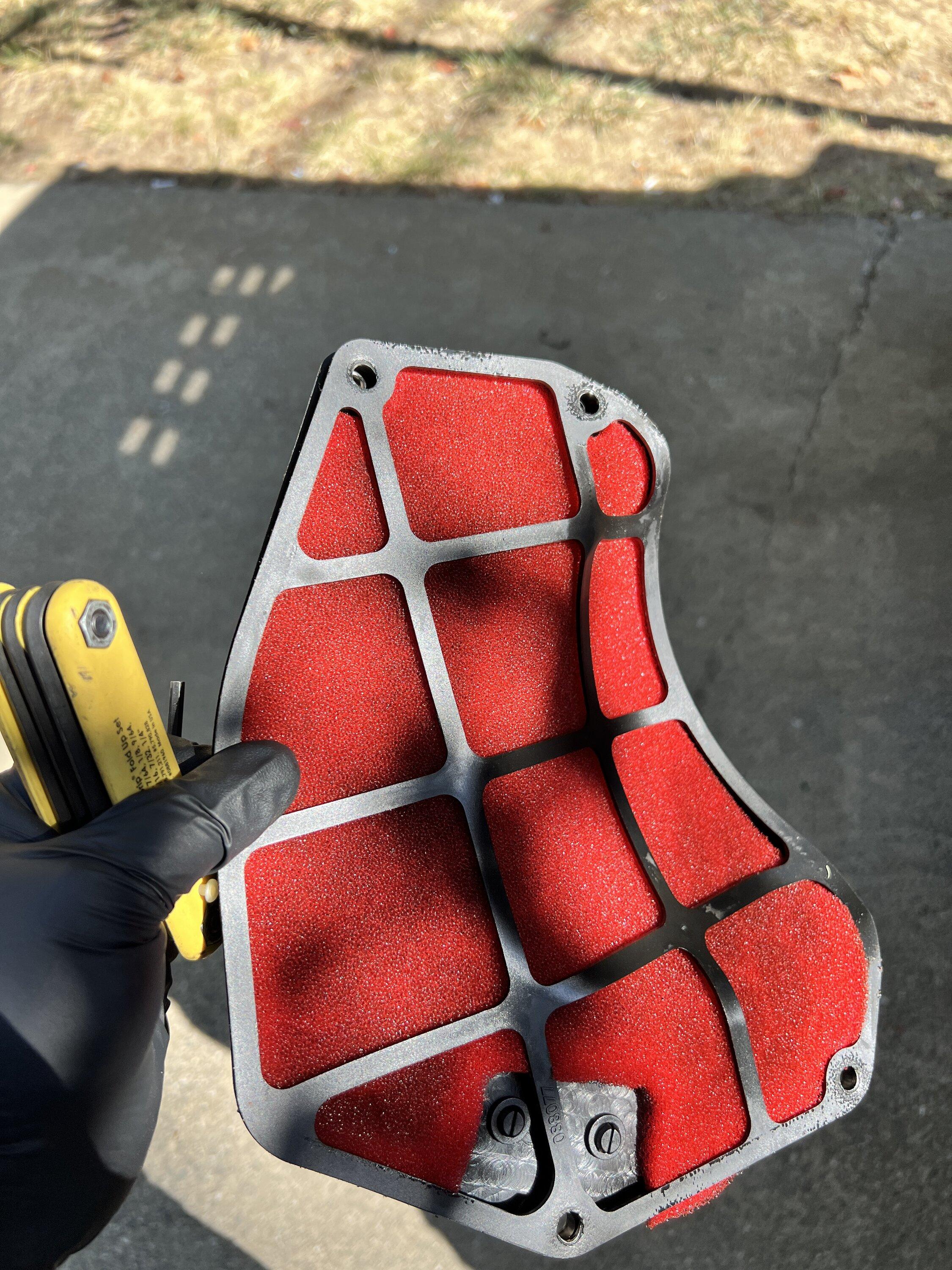

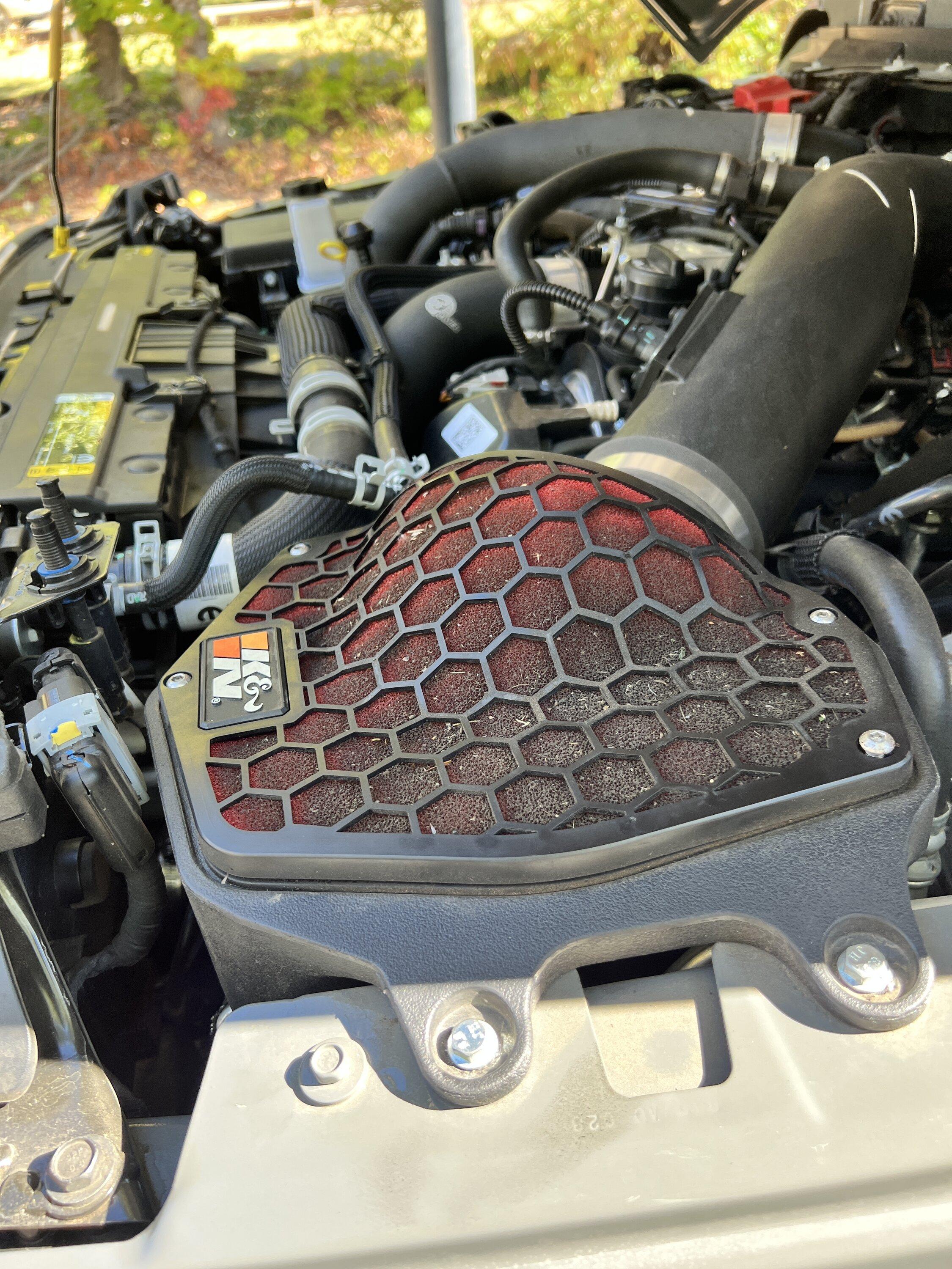

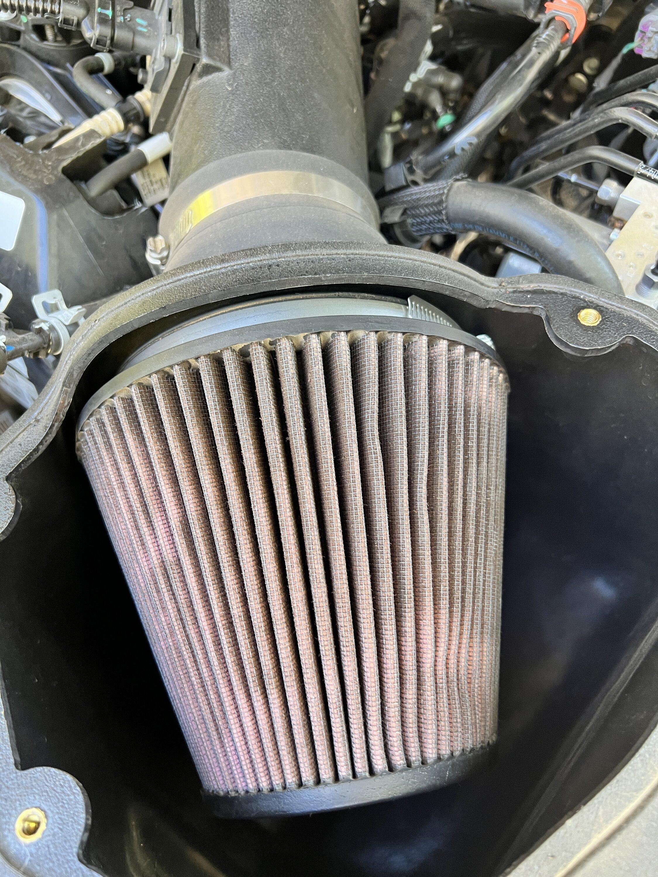

I’m at 15k miles.
the uni foam oiled works! No dust inside the intake pipes.
I clean it every 5k miles or after a off-road trip. Friends have had their stock filters clogged with dust after a day of fire roads and my Kn still looks clean?

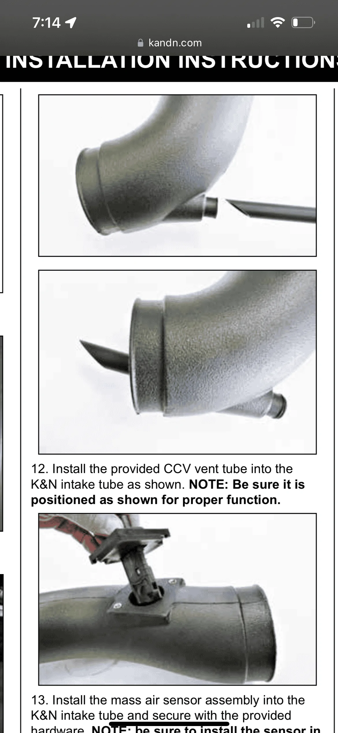

I just got mine. That tube they send with the 45degree cut physically doesn’t fit in the tube. Did I get a defect or am I doing something wrong?
Jeep Gladiator K&N cold air intake imag
That tube goes into the intake tube by the turbo with a grommet. A hose attaches to it from original ccv.

Yeah. In the directions, it’s in the tube im
Holding it next to. Clearly not even close to fitting in there.
