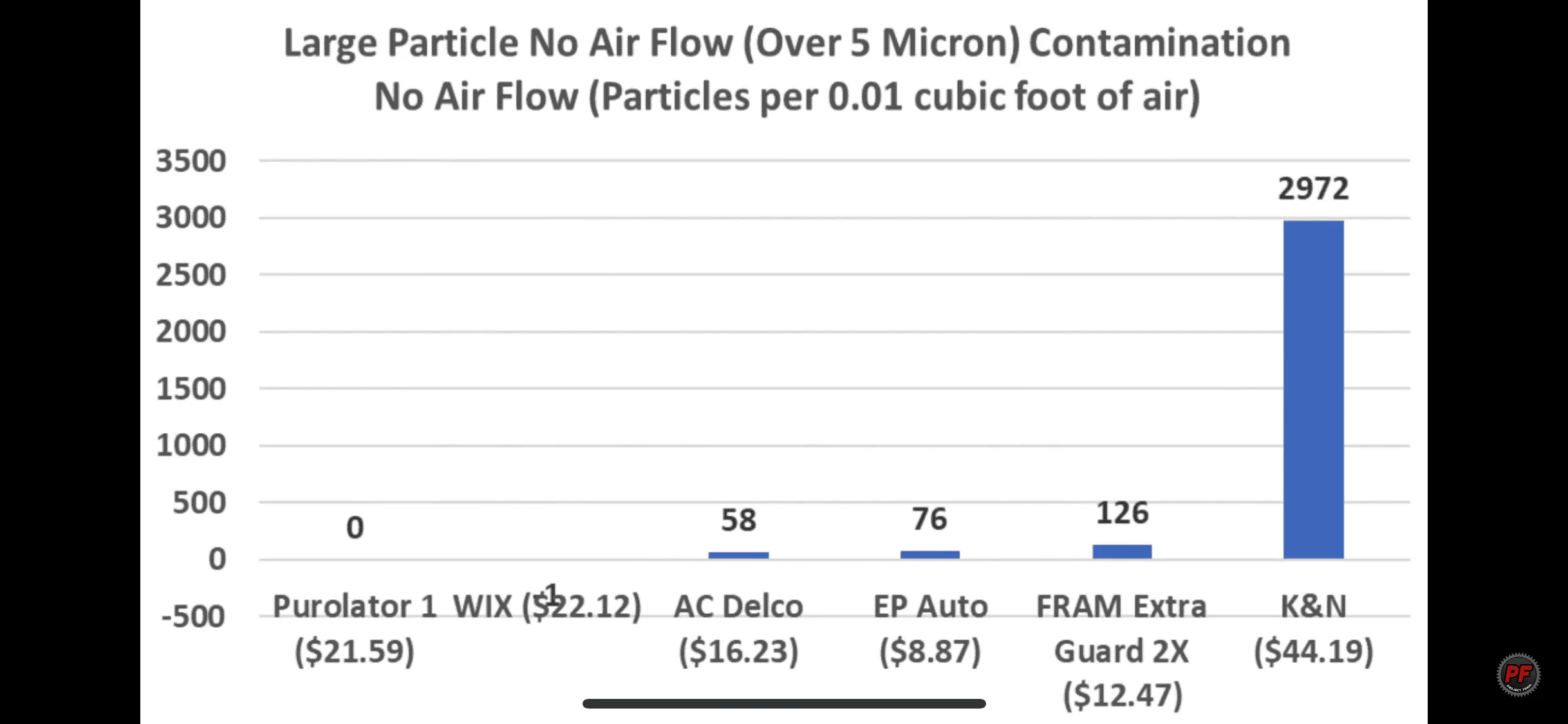

For those wondering just how bad K&N is here is some actual proof. It’s beyond bad.
Project Farm did a great test on this.
Yes the filter on its own does not filter as well as stock paper filter does. It also flows significantly better than stock paper and helps the turbo spool up quicker. This has an additional foam filter on the lid. I’ve changed mine out with uni dirtbike foam and oiled it. There’s not much getting to the KN filter at this point. It still flows far better than factory which ons. Turbo engine is important.
For a limited time. Test after test shows, proves, that the flow rate is only better for a short period of time - not long at all. Then it's more restrictive than almost any other filter. It doesn't take very long to reach that point and the whole time it's passing a lot more dirt.
But the fanboys and K&N marketing will keep on insisting it's better on the whole.
You believe what you want - I rely on science and ISO testing.

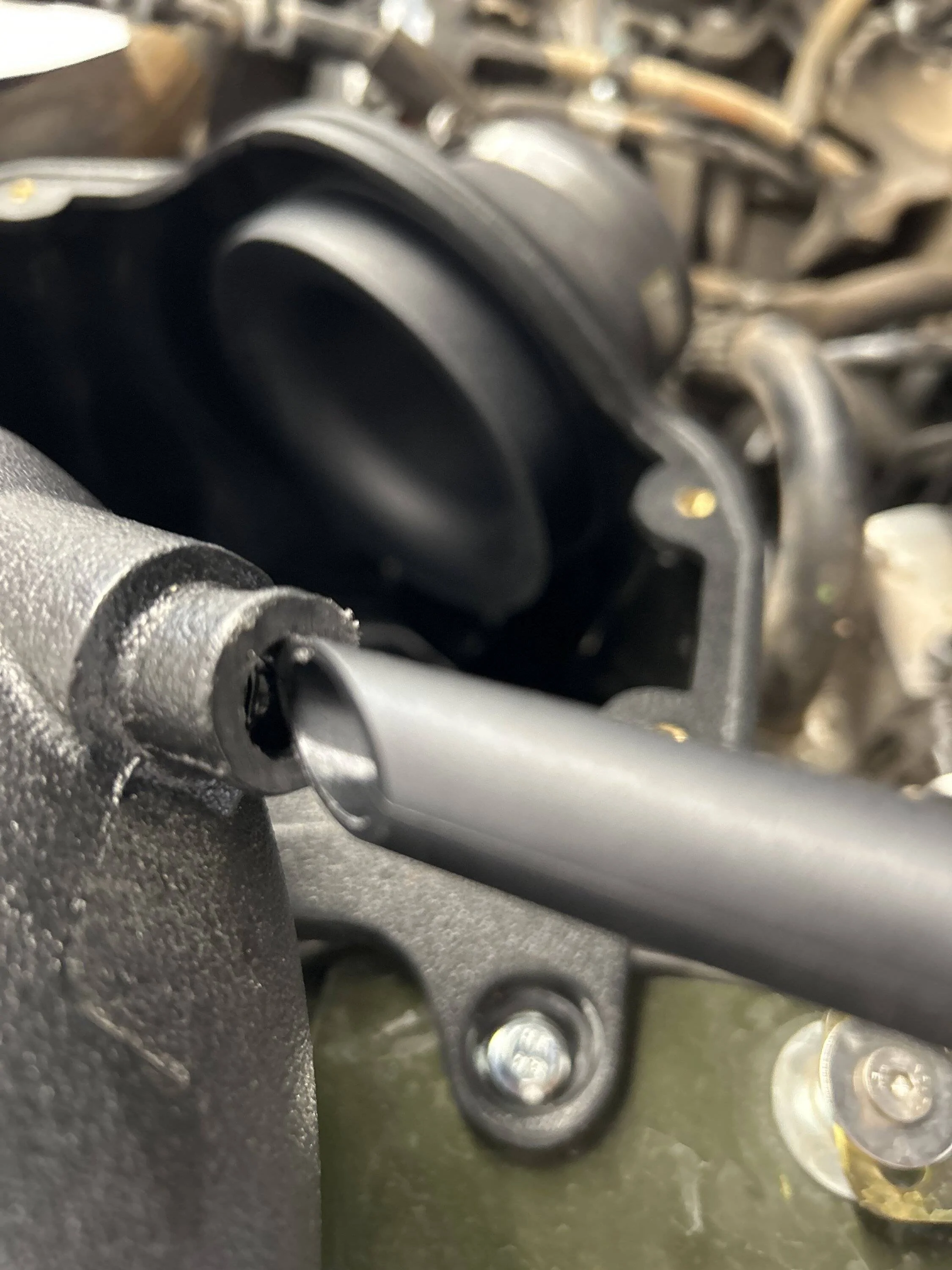

I just got mine. That tube they send with the 45degree cut physically doesn’t fit in the tube. Did I get a defect or am I doing something wrong?
How did you solve this? Just ran into the exact same issue.

Well I have worked/built countless 7.3/6.0 Powerstrokes and every one that had a K&N had silica in the intake tube to the turbo and showed dusting of the turbo impeller. I also have a background in clean room HVAC design so I understand making air clean. K&N's are junk.
40,483
53,972
I have images of the ISO testing showing how junk they are.
