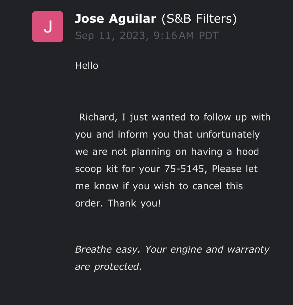

Just canceled. No scoops to reduce air intake temp is a pretty mute point for me. Factory tune is going to allow for the required air to be drawn through the factory filter. I looked at this as an option to reduce air intake temps- which is NOT going to happen without the scoops.
just an FYI for anyone else who had the same thoughts.

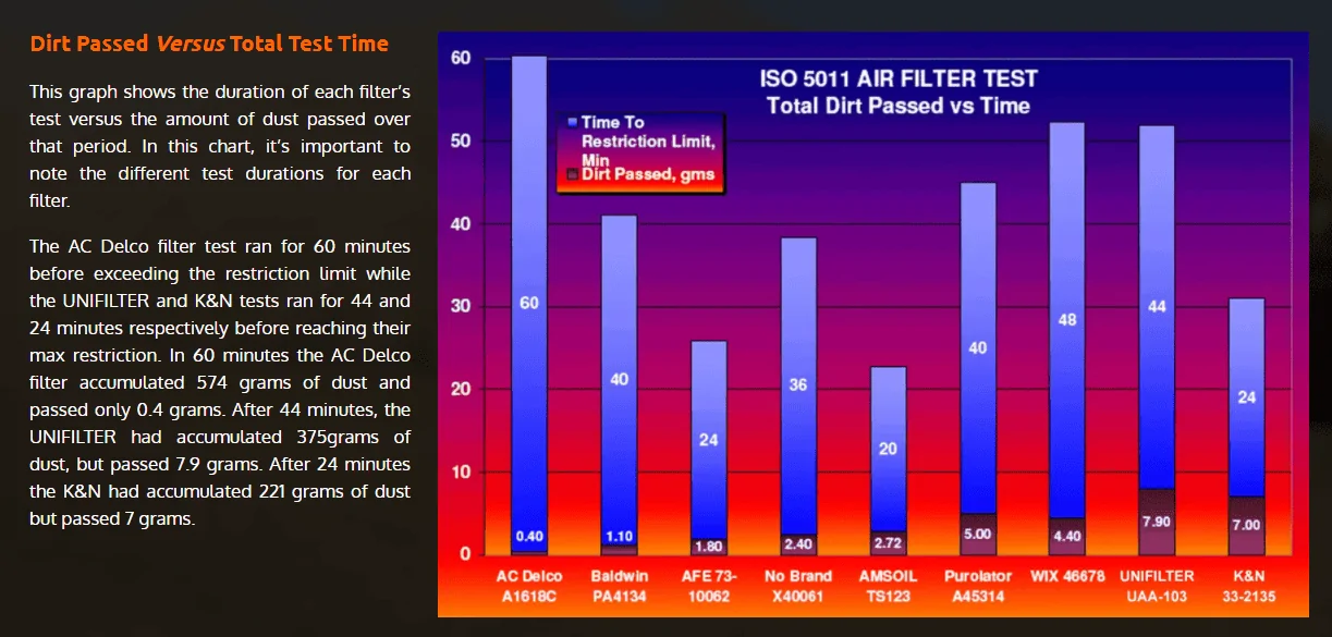

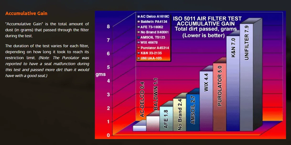

Maybe I should post my charts on how poorly the oiled filters (K&N specifically) actually clean the air..........
Jeep Gladiator S&B COLD AIR INTAKE total-dirt-passed-2
Still want a wet filter? reaches higher restriction sooner and passes more dust.
Good for the short term, racing, very high RPMs and high air volume, but.......... long term health?
I've just thrown three of them away.
How does the dry perform?

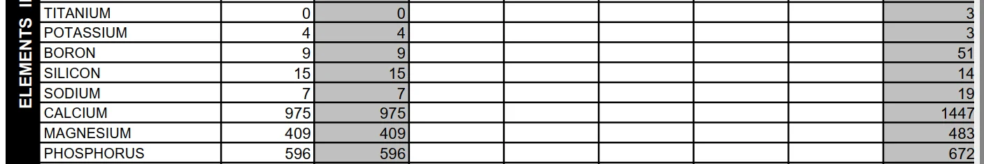

What is the air filter you use? What is the average silicone level in your oil analysis?
40,440
53,854
Stock to this point - may see if AC/Delco has a replacement. They've been good filters over the years even without looking at the charts I have.
I'll be doing another analysis after I drive a bit more with this oil as I towed several hours with the oil that's in it.
These results are from the second oil the engine had in it.
Jeep Gladiator S&B COLD AIR INTAKE 1694714008418
