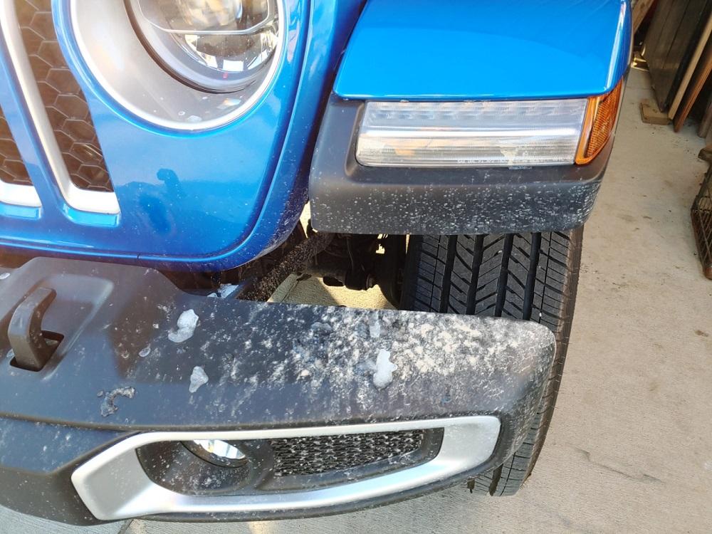

I wish I had them because mine literally tosses stuff up there and it blows back onto the windshield!
And this example is the LEAST dirt it's thrown lately - I washed off the caked mud that was sitting up there.
Today it was really throwing sand and mud. I've had to run the windshield washers to keep the crud off that flies from these areas and gets blown back.

Then in my case, the mud and dirt tossed not only onto the bumper that you have to SCRUB off because it's textured bumper ends, and then onto the windshield like happened with me. (costing windshield washer fluid)
