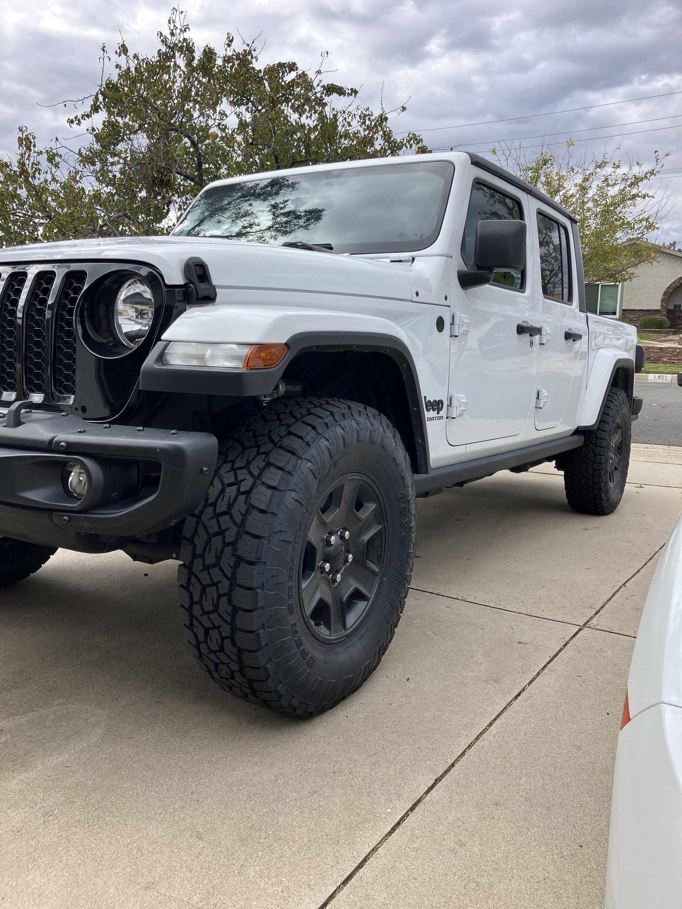

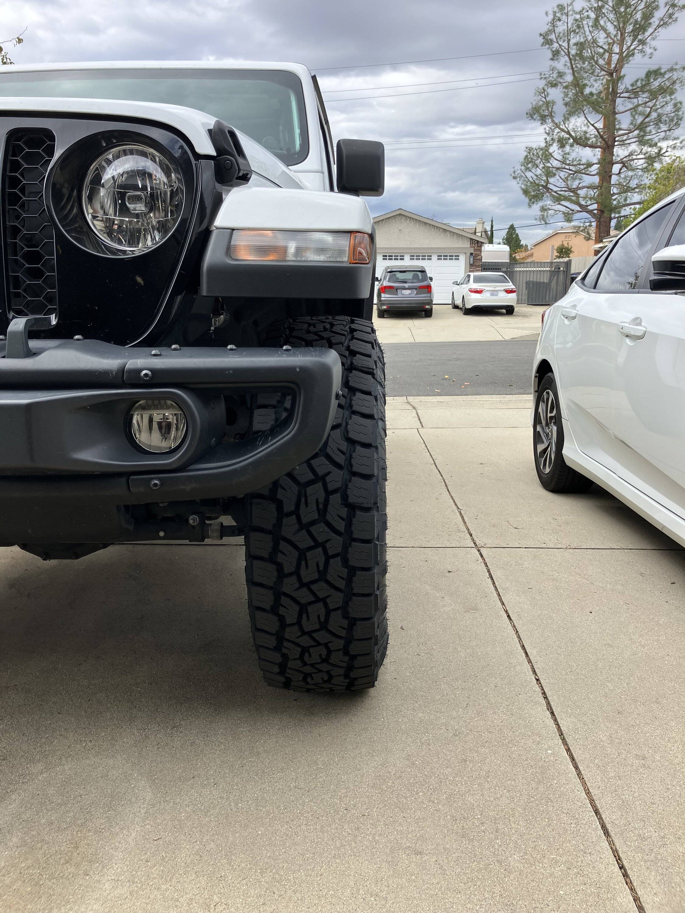

Just got a set of 35x11.5r17 Toyo own country at 3’s. They ride great and site flush with the fender. This is with Mojave wheels also

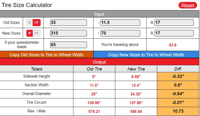

@Crossbones55 forum members that have the Falken Wildpeak R/T 01 say it is surprisingly quiet for a hybrid type tread design. BFGoodrich currently does not make the 35X11.50R17 but the 315/70R17 is just slightly wider.
