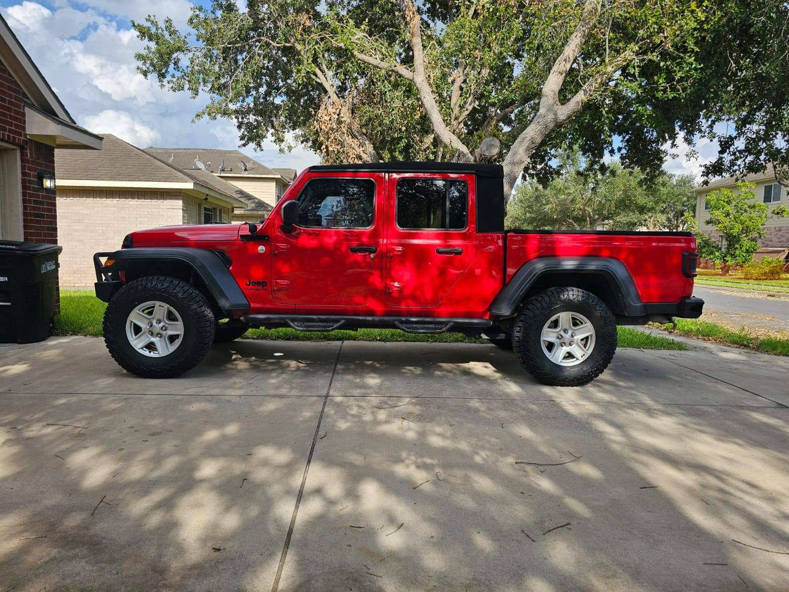

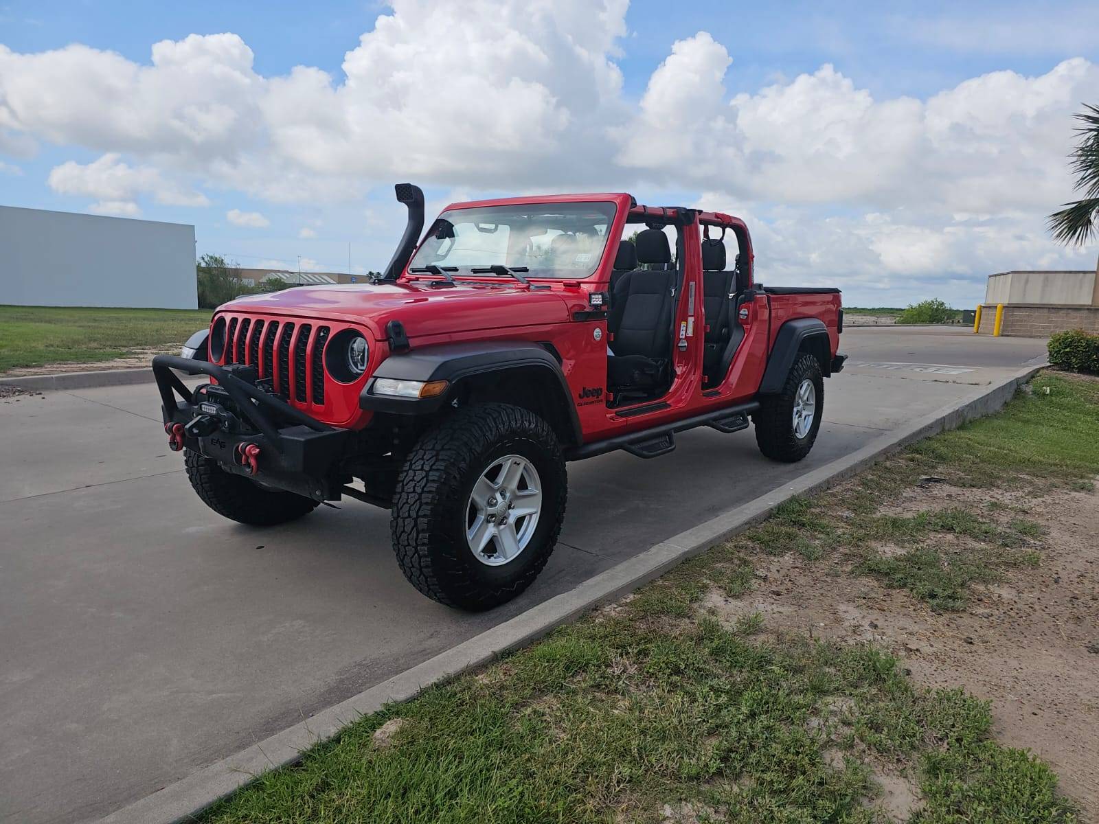

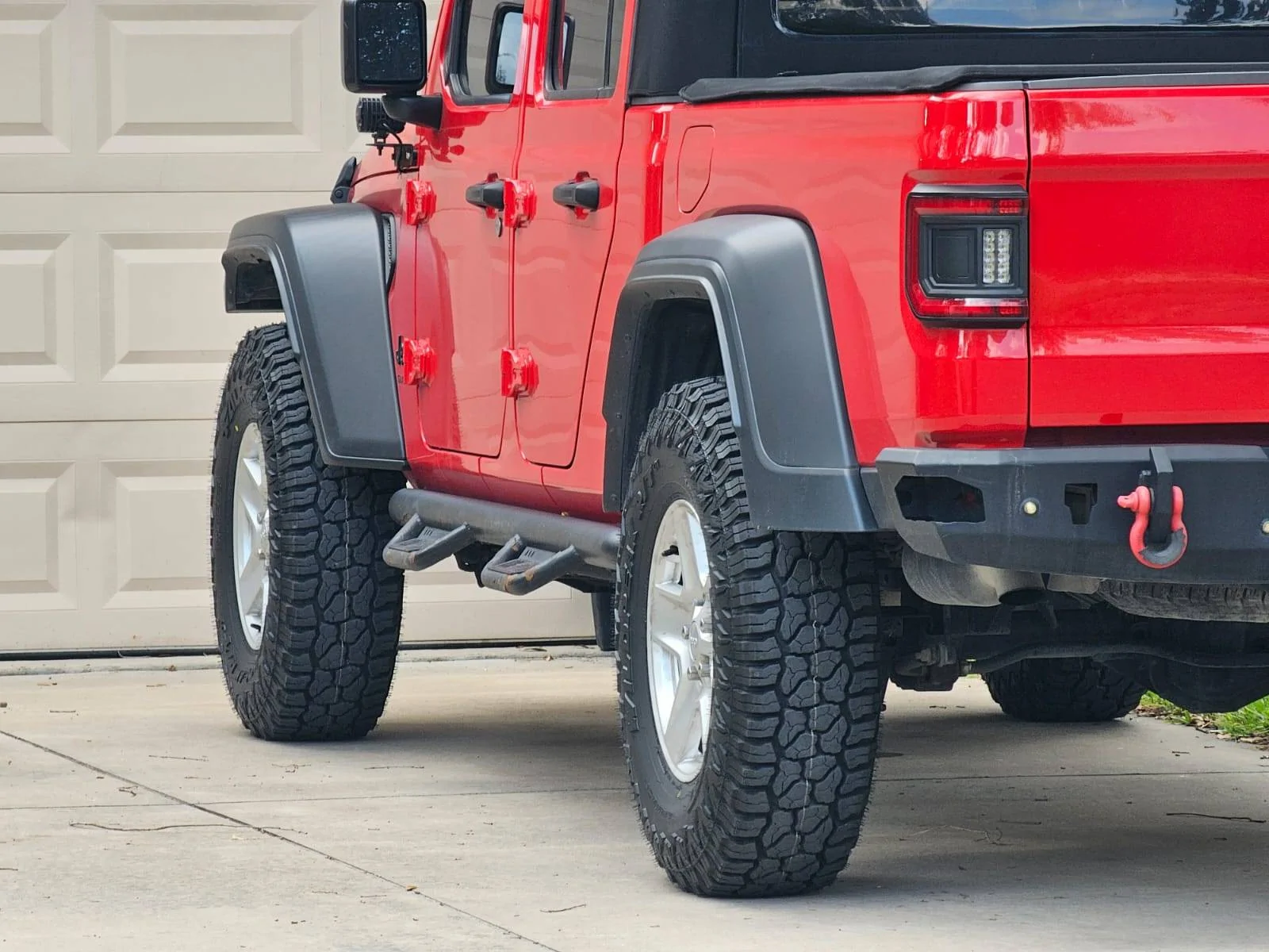

With your 4.10s in your rubi should be able to handle the 35, just make just to reprogrammed with that tire size, here are how my Sport S looks with Rubicon Suspension swap, 1.5 front lift kit and .75 rear lift kit. Falken Wildpeak R/T 35 x 11.5, (choose 11.5 width to make it good to install on OEM wheel)
Jeep Gladiator 35's instead of 33's - Need to Choose A Tire Please Help WhatsApp Image 2023-11-27 at 10.16.55 AM
Jeep Gladiator 35's instead of 33's - Need to Choose A Tire Please Help WhatsApp Image 2023-11-27 at 10.16.56 AM (1)
Jeep Gladiator 35's instead of 33's - Need to Choose A Tire Please Help WhatsApp Image 2023-11-27 at 10.16.56 AM (2)
