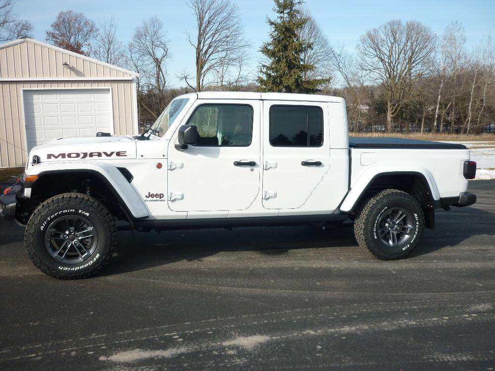

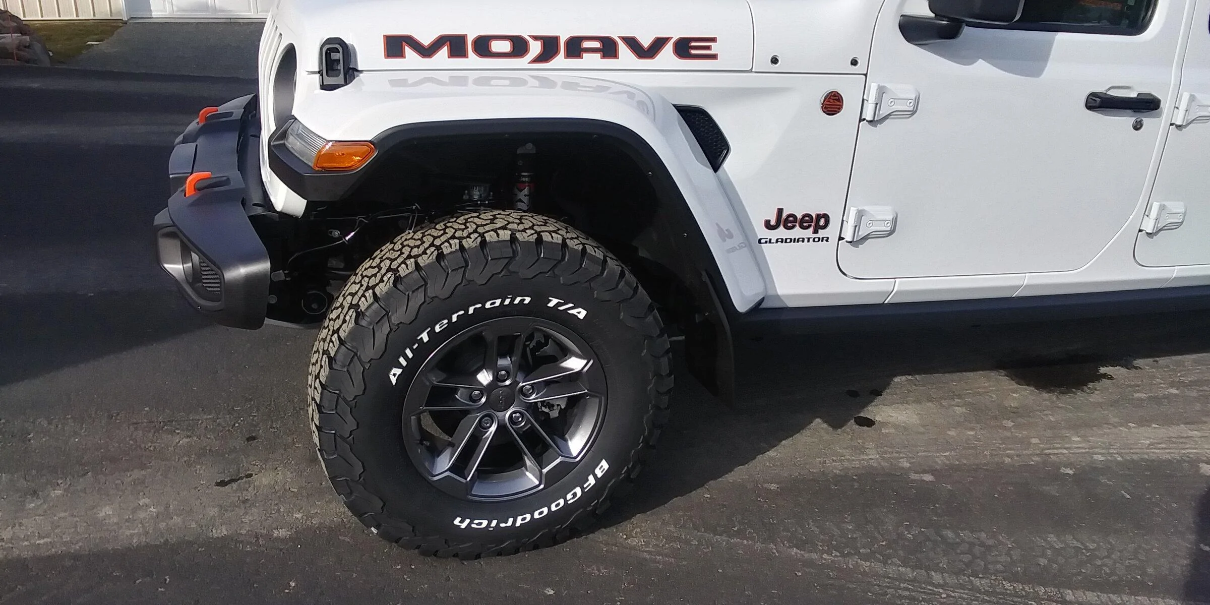

I went with Quadratec Gunmetal 41's and matching "Jeep" center caps to maintain a close to stock look. They have a +12mm offset. I stayed with the stock 33" tire size my JTM came with but with KO2's. Tire poke is only about a half inch compared to stock +37mm offset wheels (25mm difference from stock). Although I don't have a side tire poke pic, I think the profile is perfect for me.
