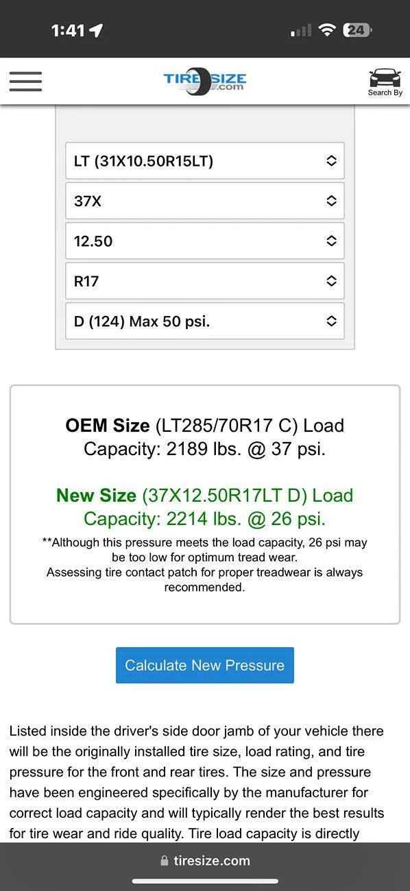

I hate to touch this again, but I’m looking for a starting point from those that have done it. Siri was no help.
Tire pressure: I ran the following numbers (picture) and came up with 26psi, but it has a disclaimer, which makes perfectly good sense. For optimal wear what have others found? These are 37x12.50R17’s.
Jeep Gladiator Help me understand- It’s been a long week IMG_0488
Currently, I have them filled to 32 from when they were installed and they looked decent with a little bit of pooch at the bottom just kinda like you want a radial tire, but I haven’t had a chance to do a chalk test yet and really don’t want to put too many miles on them until I do.
