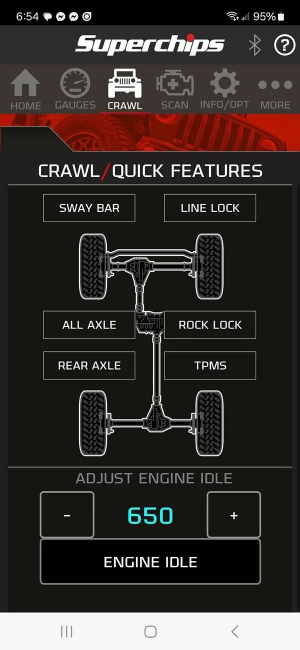

You can change rpm for winch use with the Flashcal+ also. Very easy to use.
Jeep Gladiator Confused - Need Help Deciding on JScan, Tazer or Other Screenshot_20250521_065439
