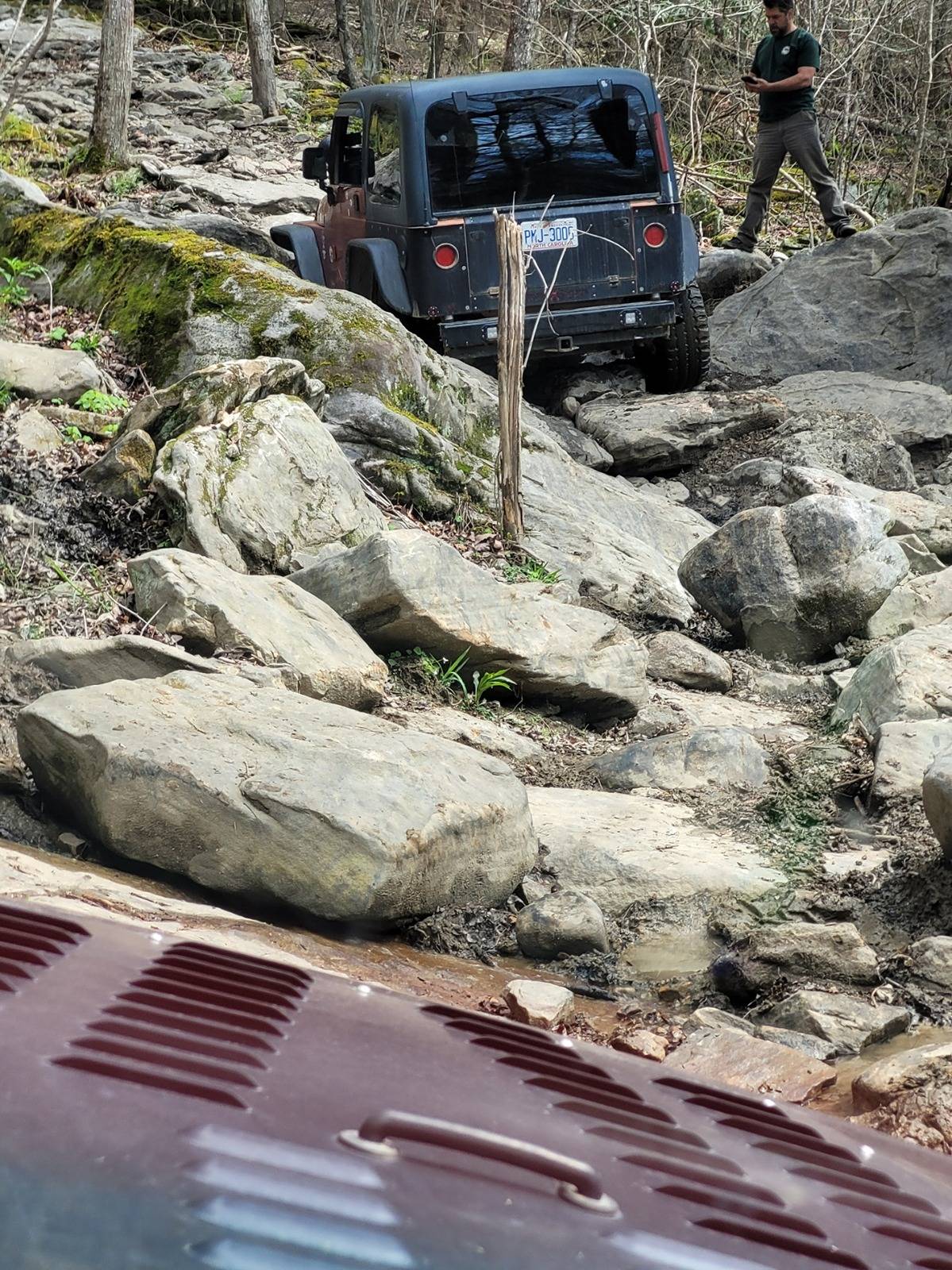

From experience on my JK, the Correctlync stuff is junk. It didn't hold up to rock crawling. Tie rod ends wore out quickly, the tie rod bent easily and looked like a pretzel within 3 months.
Currie told me to pound sand when I contacted them about my problems.
I went with Fusion 4x4 aluminum stuff in the JK. 7075 aluminum that just flat out works. They now have JT steering. It's a bit pricey but they are well worth it.
This is the type of stuff I wheel in with the JK. Many times I have had the full weight of the JK on the tie rod. It's got a few scrapes but it's still straight as an arrow after 6 years of abuse.
