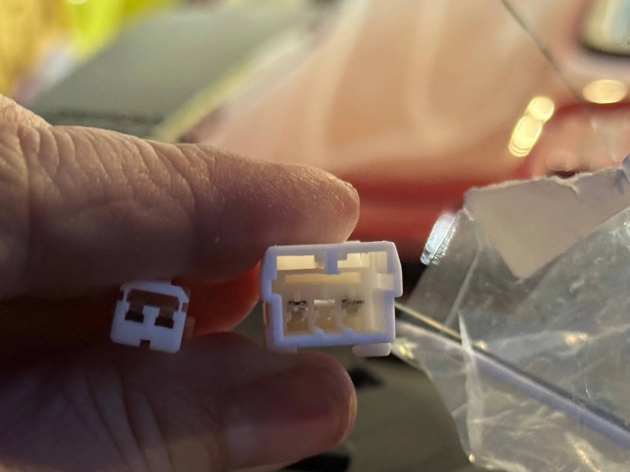

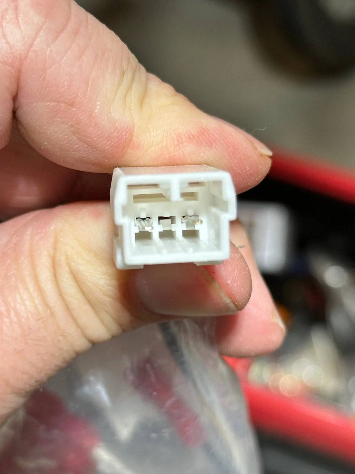

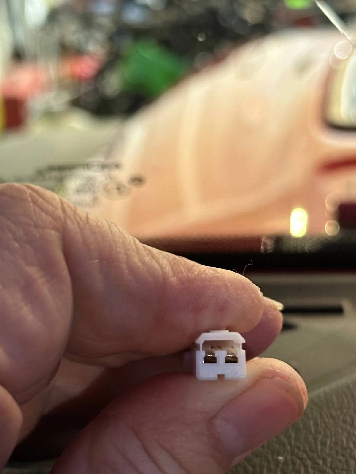

Don’t have an answer but a couple pictures may help with more accurate advice.

Good suggestion. The small one is what’s in the truck, the big one is what the internets say the adapter is
Jeep Gladiator Dash Speaker Adapter IMG_5840
Jeep Gladiator Dash Speaker Adapter IMG_5838
Jeep Gladiator Dash Speaker Adapter IMG_5839
