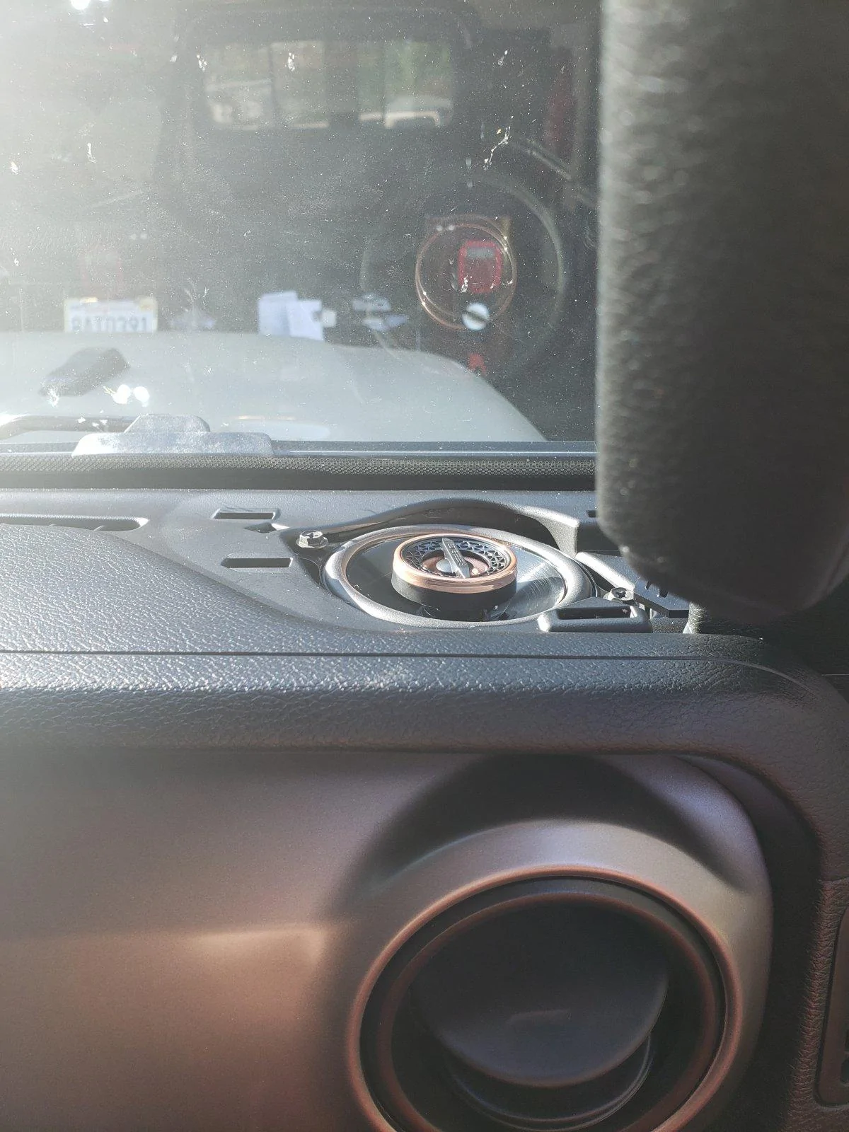

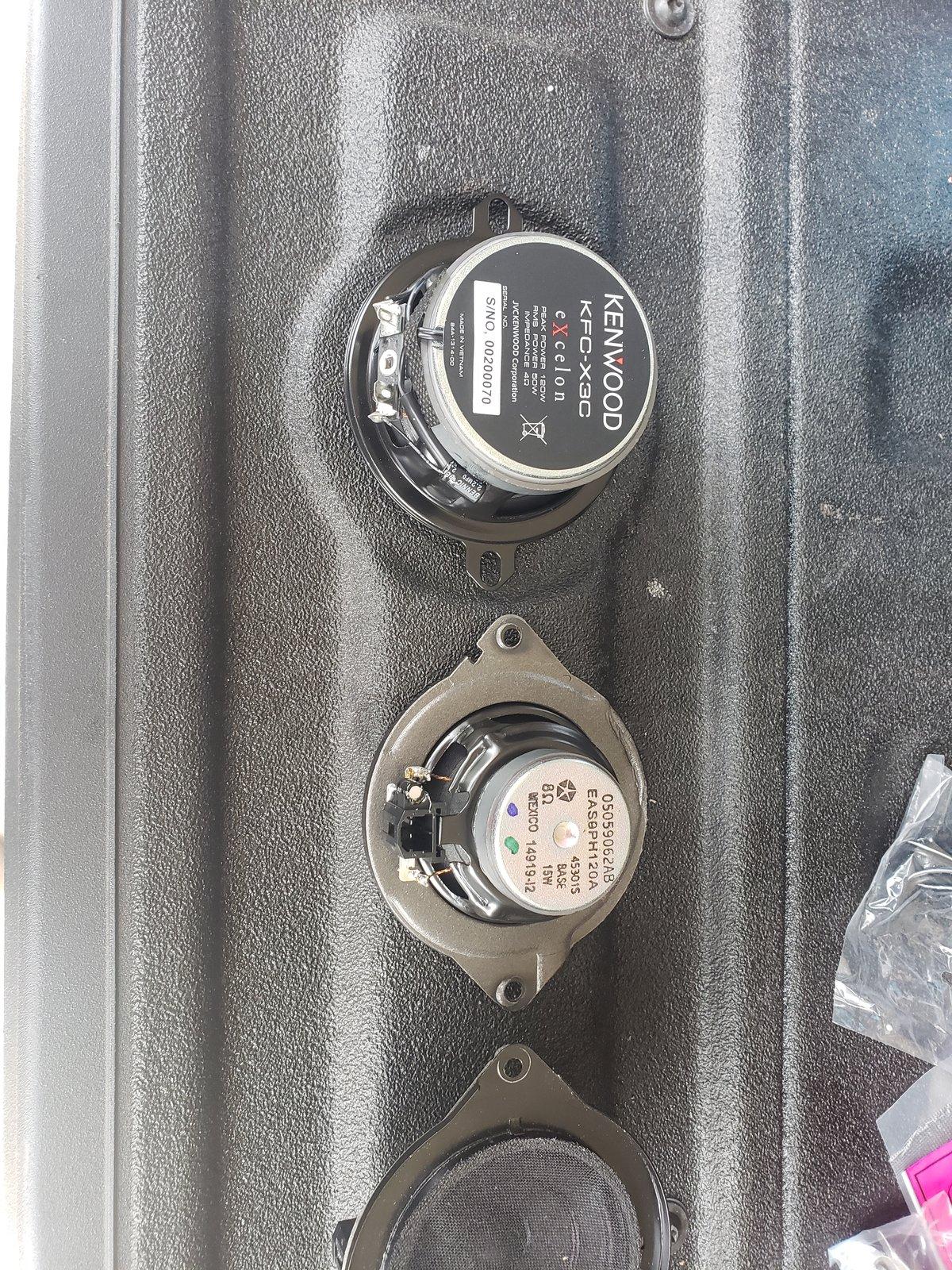

Bought the Kenwood excelon replacements from Crutchfield. Took 20 minutes to replace and made a 60% improvement
Jeep Gladiator Dash speakers 7" No Alpine 20200403_173825
Jeep Gladiator Dash speakers 7" No Alpine 20200403_173815

So those are drop in replacements for the dash corner speakers? How come you went with Kenwood? Noticed there are a few choices on Crutchfield.

They are a very popular drop in for the U connect in many Chrysler cars. They work well with the crossover and do not need the included ones in the box. Anywhere you read about them the reviews are positive.

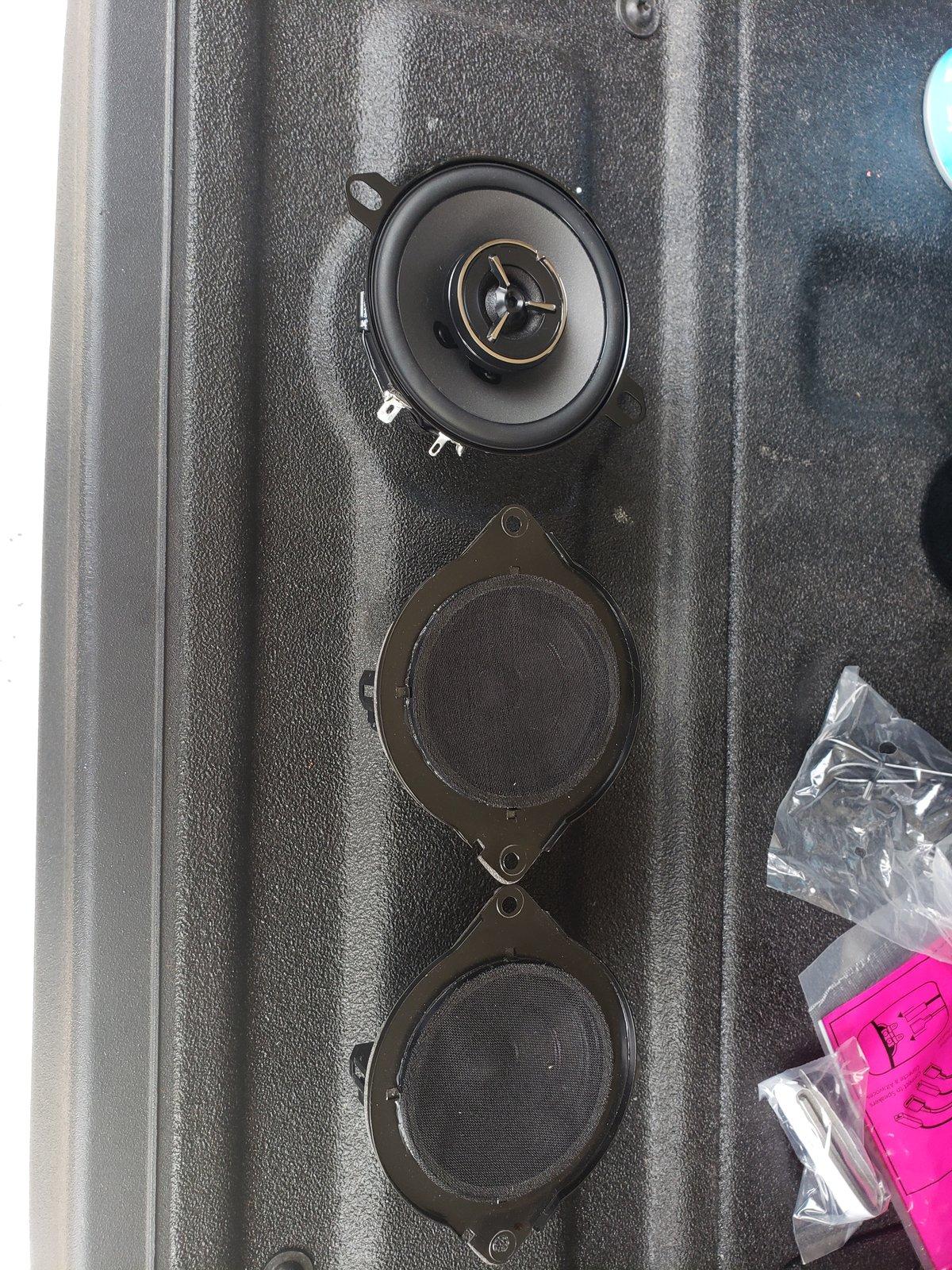

are they 3.5"? I thought we had 4" in the dash? I have the 7" and would like to replace the front and roll bar speakers.

Yeah, these Kenwoods fit, but just barely.

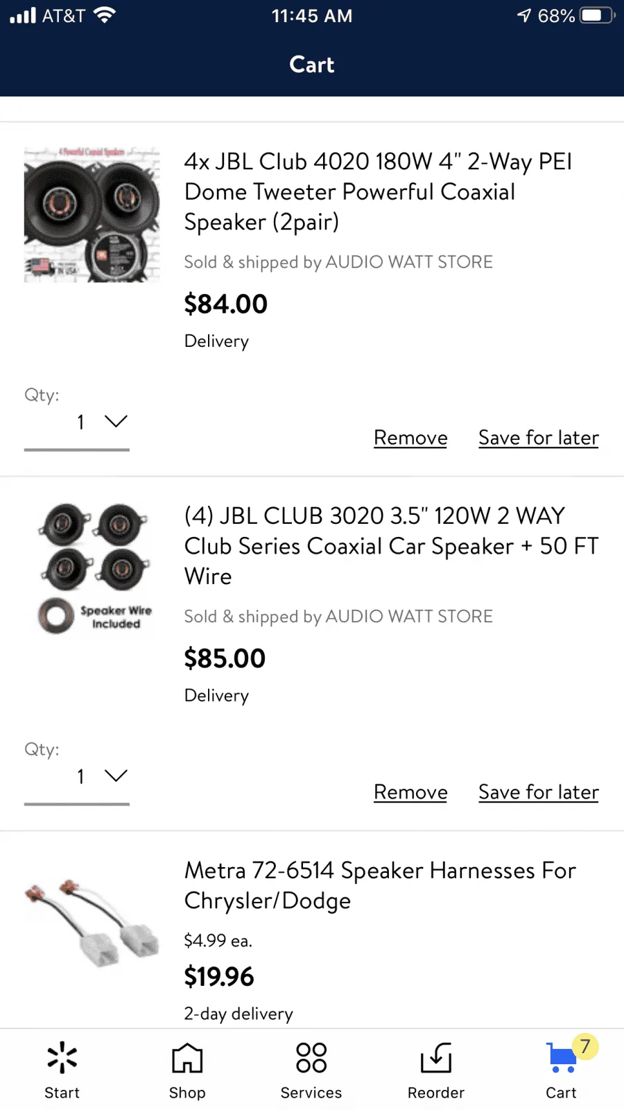

I ordered a set of these for the front dash also. Has anyone done any changes to the roll bar speakers?

I’m placing this order today. Hope to notice a difference.
Jeep Gladiator Dash speakers 7" No Alpine 6F7D0F83-A8D1-40FD-B06D-D0841A93F37E

Curious why so many speakers. I think you have the right sizes. 4" roll bar and 3.5" dash uppers.

2 in the dash. 2 in the knee panels. 4 (2 of each) in the roll bar.

Just do the 3.5's first and see how you like it.
Jeep Gladiator Dash speakers 7" No Alpine 20200416_175511
