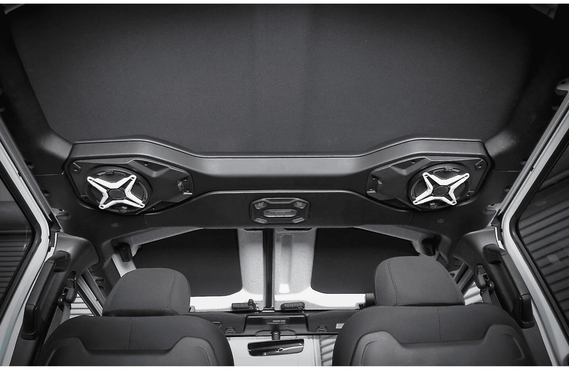

I personally would NOT go through the trouble of replacing the soundbar speakers without upsizing them; the stock size/3.5-inch is TERRIBAD and regardless of the manufacturer you're not going to get full range sound without a full range sound-sized speaker, like a legit 6.5-inch. Buy this SSV adapter from Crutchfield (they also have the Metra wiring harness) and REALLY upgrade your system for what it should have came with, at least size wise, for starters. This was one area they really took a step backwards from the JK platform...

Would you say these leave enough room for a component 6.5" set with a separate tweeter and room for the crossover?
First a correction; I misstated the size of the stock speaker, it's a 4-inch not 3.5-inch but my observation about getting quality sound out of a speaker that size in that location stands...
From the looks of this picture:
Jeep Gladiator Factory Alpine Premium Audio - MB Quart Dash / Soundbar Speakers? 1631809884215
...it looks like it's set up for a 6.5 or 6.75-inch speaker only, as stated in the product description. There's NO shortage of speakers that size which will perform very well, although arguably not as well as a component system of course...
The SSV Works JJT-SA065 has room for a small tweeter. If you search for it on the JL forums and on the Crutchfield reviews you will see where people have mounted the separate tweeters just inboard of the 6.5s. I'm not sure if there is enough room for a crossover to fit in there. I figured that if I installed component speakers I would simply wire the tweeters to the 3.5" plugs and the 6.5s to the 4" plugs.
