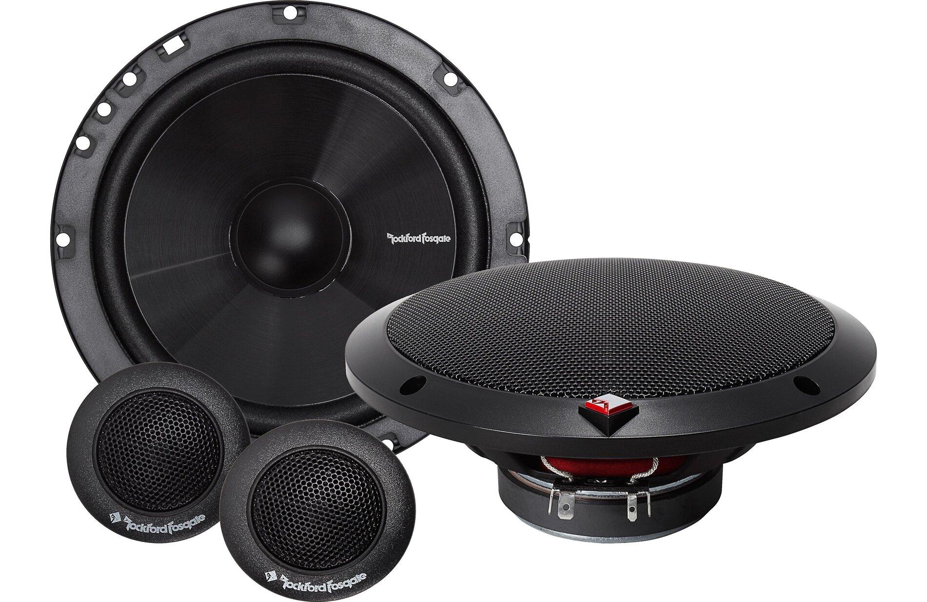

I got a chance to have my local stereo shop take a look at and offer solutions for the Rockford Fosgate R1675-S 6 3/4" component speakers I waited over 2 months for and used to replace my "Alpine" speakers. He was surprisingly, much more knowledgeable than the "professionals" at Crutchfield.

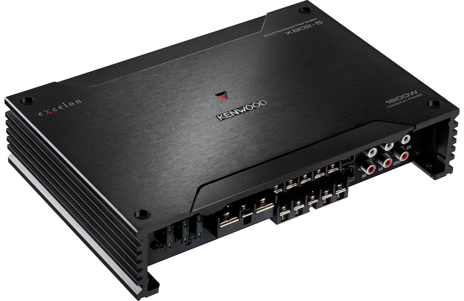

He suggested a Kenwood or Rockford 5 channel amp so I picked out the Kenwood Exceleon X802-5 which currently has a $80 discount at Crutchfield, but is also on indefinite back order. This amp has 50W RMS x 4 at 4 ohms and 500 RMS x 1 at 2 ohms for the sub (that we will have to turn down the gain on a bit). This should provide a huge improvement in sound without breaking the bank.
Normally, I do all the work on my cars and I have installed lots of head units and speakers before, but never an amp so I am going to open up the piggy bank and pay my local stereo shop to do it to avoid the headache of trying to wire everything and set it up correctly.

Kenwood Excelon X802-5 amp: https://www.crutchfield.com/p_113X8025/Kenwood-Excelon-X802-5.html?tp=70137
Jeep Gladiator Factory Alpine Premium sound system g113X8025-o_other1
Current Rockford Fosgate R1675-S Prime 6 3/4" speakers: https://www.crutchfield.com/p_575R1675S/Rockford-Fosgate-R1675-S.html?tp=105
Jeep Gladiator Factory Alpine Premium sound system Rockford Prim

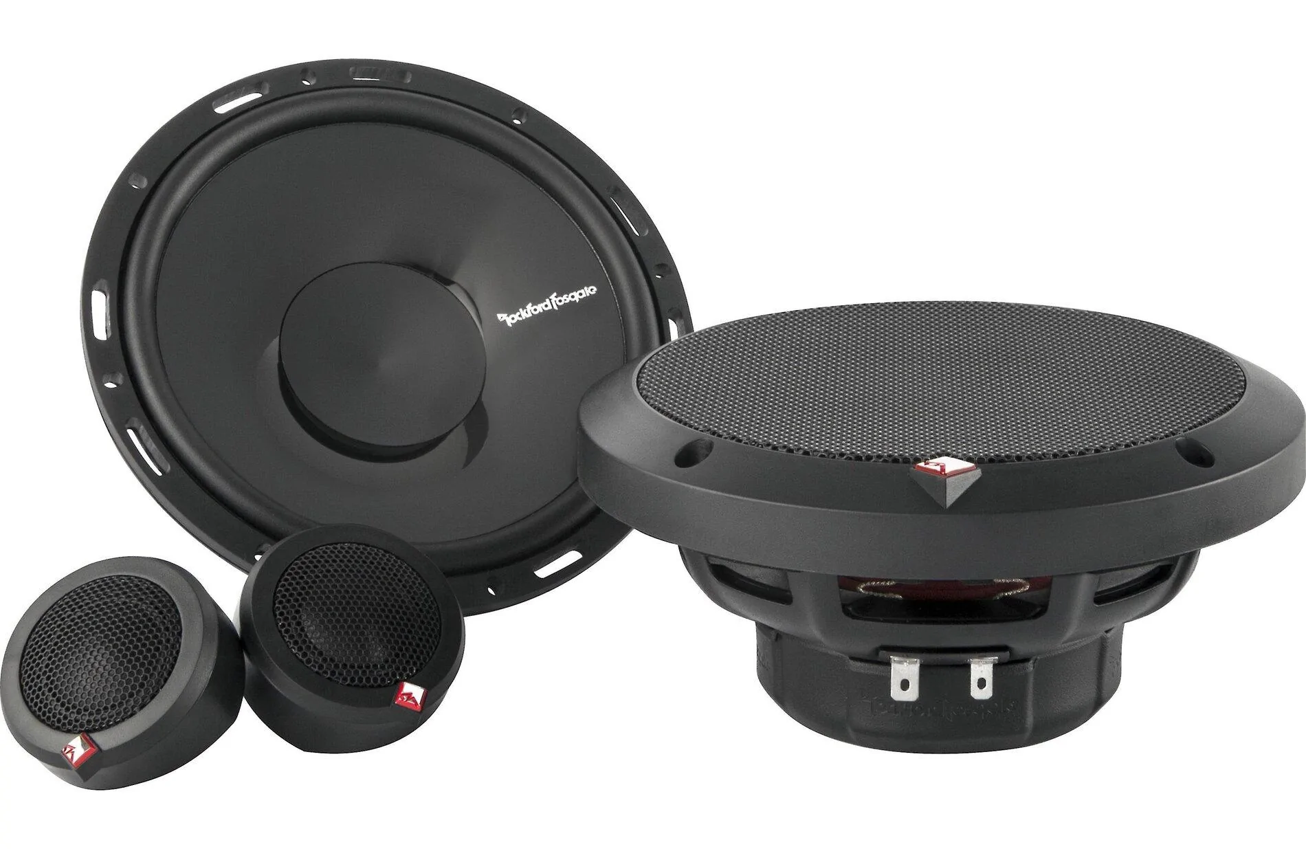

Possible upgrade to Rockford Fosgate P165-SI Punch 6 1/2" speakers: https://www.crutchfield.com/p_575P165SI/Rockford-Fosgate-P165-SI.html?tp=105
Jeep Gladiator Factory Alpine Premium sound system Rockford Punch
