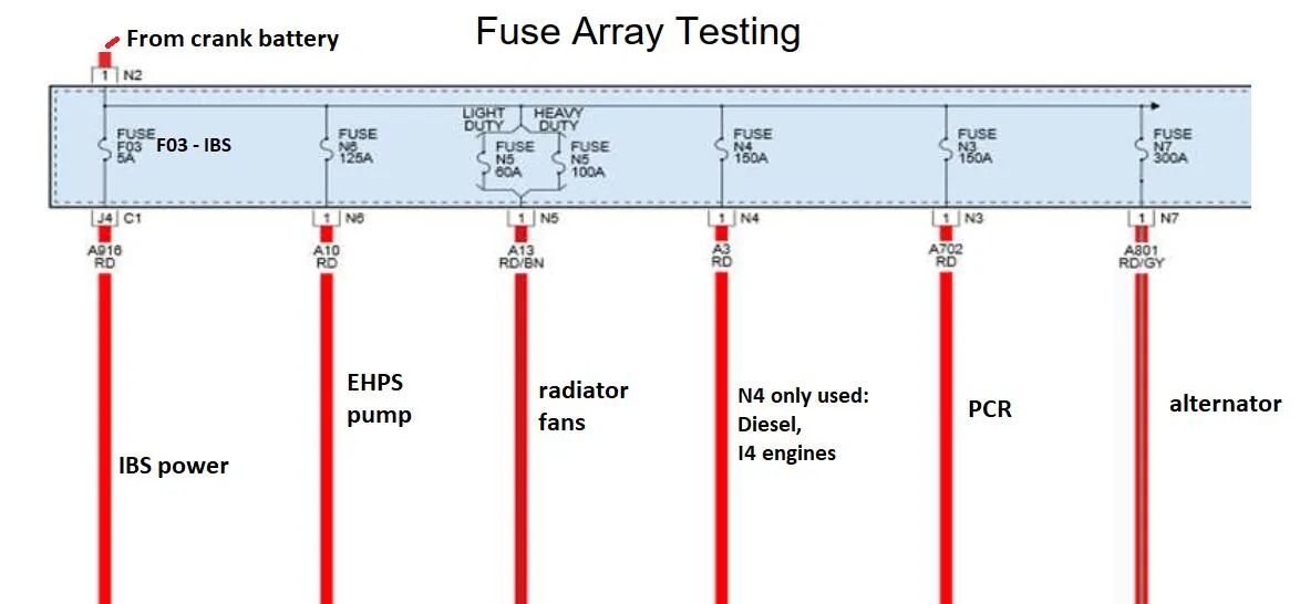

A definite question about on this subject. . . As I'm stuck in a parking lot with dead battery(s) I replaced the starting battery and no juice or anything now. 🤬 😳

Nothing at all? No brake lights and so on?
You probably don't have a meter or test light with you to check power at various points -
We can pretty much count out the high current fuse array, I suspect, because that's only fused for the EHPS, fan, alternator, that sort of thing. Straight power for everything going through the "fuse panel".
If you had a meter - check the aux battery voltage. (you know the drill about the ground cables and so on, which is which.

Nothing no power to anything.

Yeah. The battery light s came on vehicle will shut down ect ect coasted into Walmart as everything shut down. Then started trying to drop in Park.

Definitely try to check voltage at each battery individually - unless you already did a bypass of some sort.
It sounds like self-preservation mode - low voltage, so it wants to shut things down.

A dead aux battery and a blown N3 fuse results in no power to the electronics. Connecting a jumper from the main battery positive to the N1 terminal will bypass the N3 fuse and allow you to start if that is the problem. Or move the cable from the N3 terminal to the N4 terminal.
Yeah, that works.
If N3 is gone, it can still operate until the aux goes dead.
That's why I wanted him to check the voltage of the aux battery.
But if the aux battery is dead, then a blown N3 is a big problem as it can't feed from the main battery.
IF it's fully charged, or even a decent charge, it would run until the aux was drained if N3 was blown.
N4 is unused on the gas engines and is a 150 amp just like N3 so that's a solution until he can get a replacement high current fuse array.
A check of the aux battery voltage would be a good test - and moving to N4 if N3 is blown is a get by solution until he can resolve it.

Two new batteries installed, would start at 12.7 v but start dropping off to 10.5 and all the check engine lights traction control, transmission, brakes p.s. ect ect.
Got a lift home went back in LJ, pulled both back out and have them on charging now. The batteries were definitely fighting "stealing power" from each other, they were warm when I pulled them out. Main battery was at 75% when I hooked to charger.
I'll definitely be checking some of that out. when I can get it home or started that second battery is going to be high on my list of getting rid of. I downloaded that info years ago. :headbang: but when you need it on side of road not the time to start looking.

Check the high current fuse array, esp the N3 leg.
If both batteries were fully charged when installed, there's no real reason for either battery to be "hot" or "warm" unless there was a lop-sided drain on things.
If the voltage dropped like that, makes me wonder about the alternator!
You said it started at 12.7, then dropped - does that mean the voltage was at 12.7 when you started driving and constantly fell?
IF that's the case, they aren't charging, otherwise the alternator would have kept the voltage up while it was running - unless there's a blown fuse.
