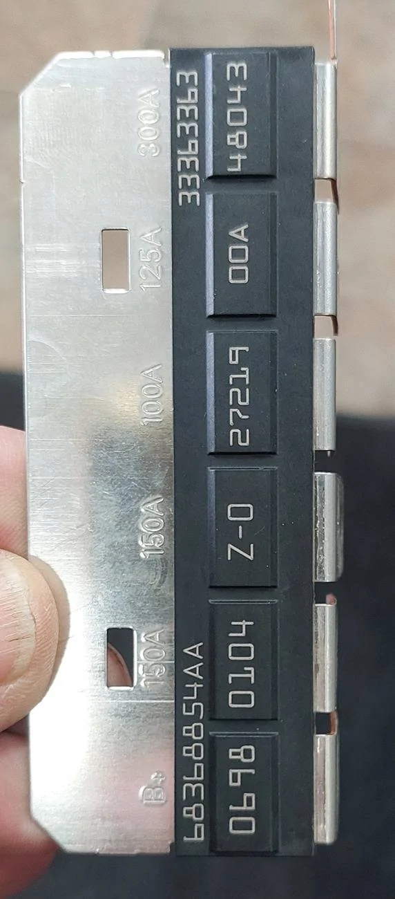

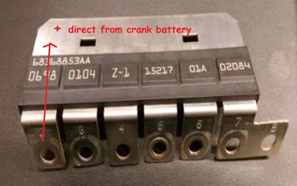

EHPS is N6. That line goes right to the pump. What controls the pump would come from the BCM, via the fuse panel.
If you short the wire leading to the pump, you'll blow, or hopefully/should blow, N6.
N6 is directly on the main bus from the main/crank.
So it's from main + to the high current fuse array bus bar, out through N6 directly to the pump.
That part I've got.
N5 is the fuse for the fan and also comes directly from the battery +.
So there's a cable running from N5 to the fan controller and on to the fans.
Power comes directly off the main + to the bottom of the high current fuse array - via N2, then out through each fuse in the array.
The main battery + goes to N2, which is a direct connection, not fused, to the array bus.
N2 connects to the bus as shown by the arrow, there's no fuse where the "0698" numbers are printed in this example.
So anything fed through this array, gets power very directly from the crank battery.
