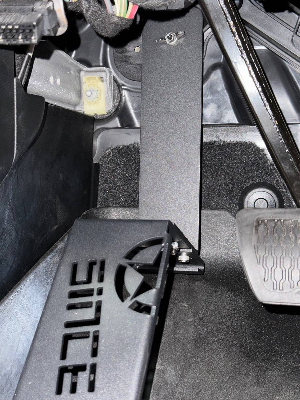

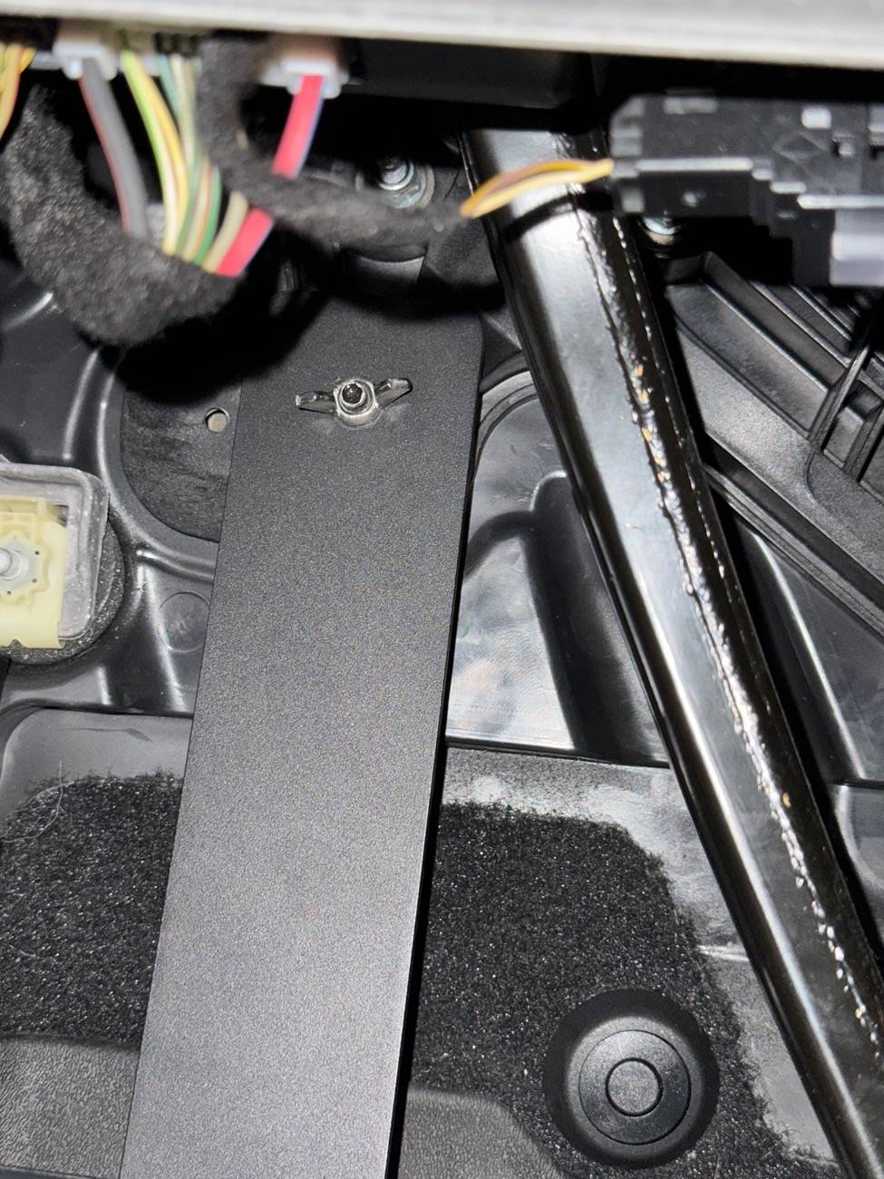

FWIT... Go to the hardware store, get a wing nut - if forget the metric size and pitch and just install your pedal over the OEM nut .. Plenty of threads to do this.. I know.. I have run this way for 3 years.
Thanks everyone for their feedback, ended up going this route. Works perfect and there was plenty of thread. The pedal makes such a difference.

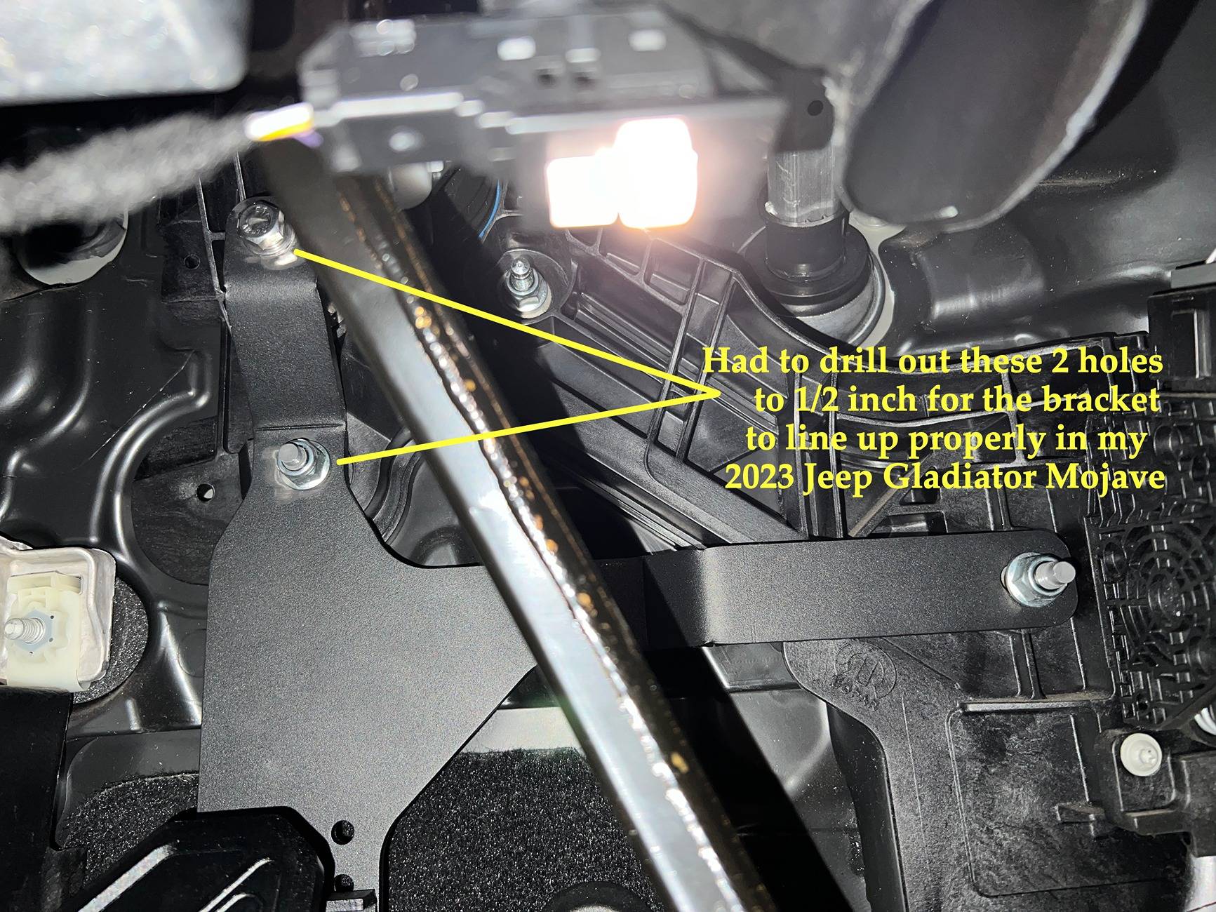

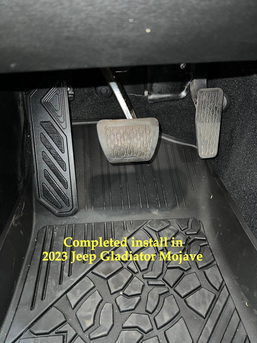

I just installed this dead pedal over the weekend. I chose this particular model because it uses 3 mounting points for extra strength/rigidity. Also the pedal is super thick with rubber strips on the pedal. Unfortunately the manufacturer needs to revise the bracket because the top hole didn't line up on my 2023 Mojave. It was off by about 1/2 the diameter of the bolt. I had to enlarge 2 of the holes to make it fit. Once I did that I was able to install it. I didn't have any issues with getting the 3 factory nuts off with a ratchet. The kit includes a standoff for the top hole to bring it out for the bracket.
https://www.amazon.com/dp/B0BS8PC37Z

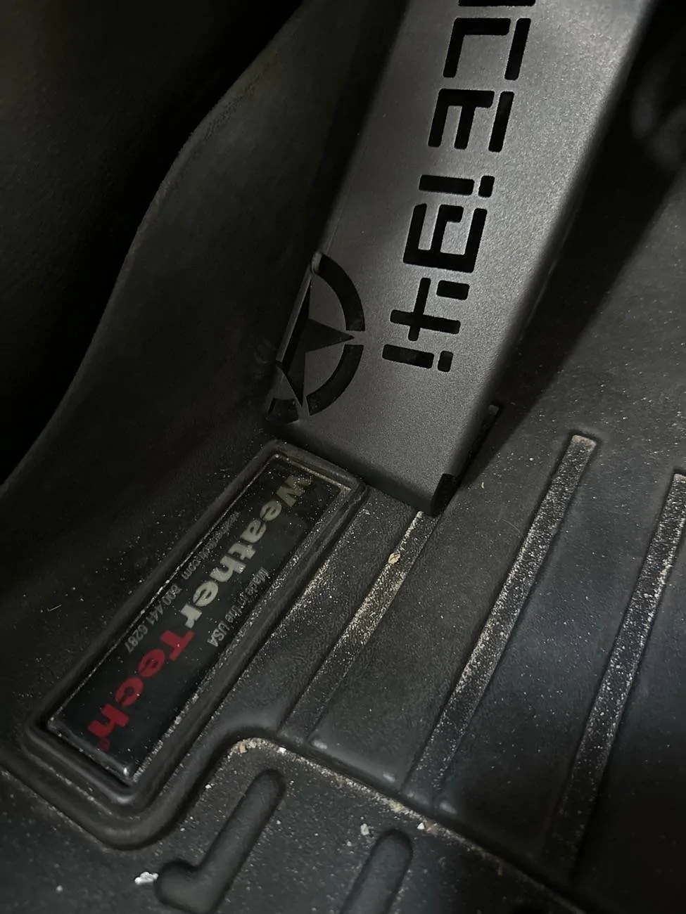

Posting for others who may look at this later in time, just install it over factory, use a M8 wing and you’re all set. And luckily, it fit just before the weather tech emblem.
