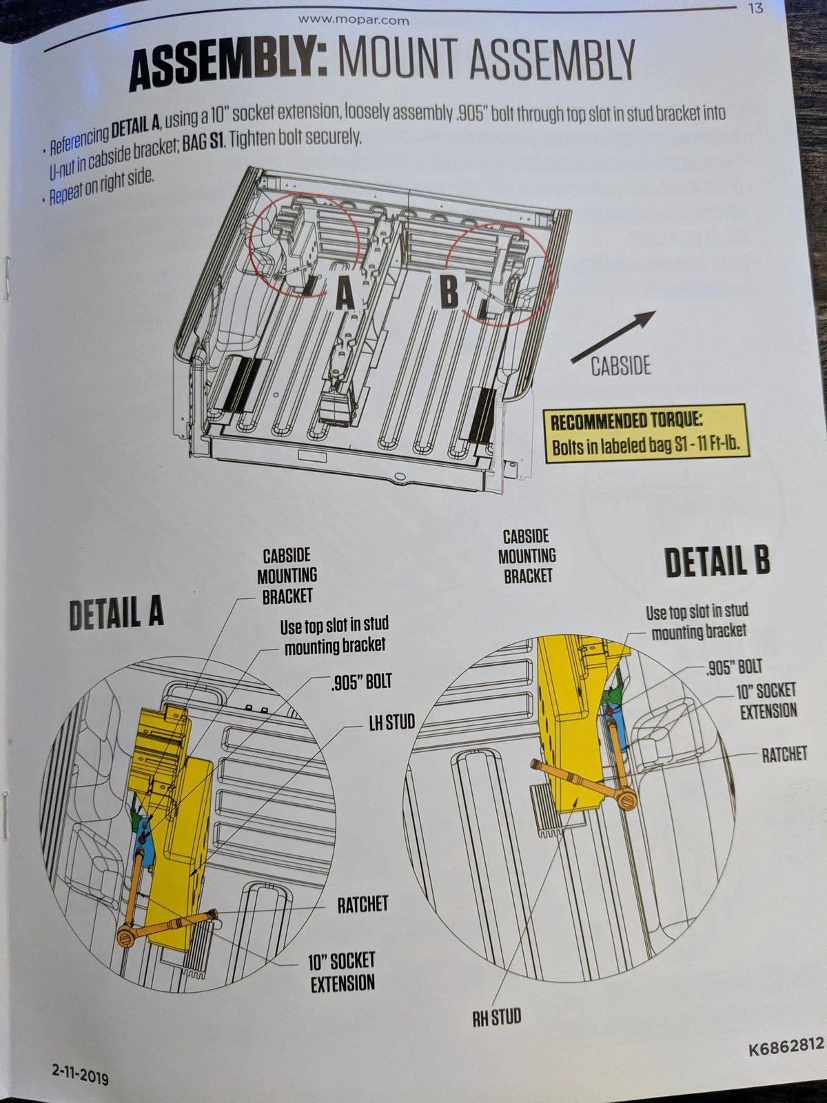

Removing the system should only take you 15-20 minutes if needed. You remove one drawer and then the tie downs. Then you remove every other screw on top of the system and remove the system in two pieces.
Maybe with longer beds that would be the case. With the Gladiator, you don't have the easy amo can tie downs near the cab. You have these bolts on each side that you can only get to with an extension and with the lid completely removed. So the only way I can see to remove the decked system is to remove both drawers, unhook the amo cans. Remove all screws going into the center vert and right/left studs. gotta remove the pretty ruler on the back too as it ties both sides of the top together and especially with the bed rails if your jeep has it, won't come out without splitting the top in two (that part sucks as there isn't a threaded insert for that part) Once you get the lid off then you can reach these two little bolts and can pull the rest of it out. I was under the impression when I bought the decked system that it would be a fairly simple removal if I ever needed the bed. After putting it in, I found that wouldn't be the case. Still like it, just had to come to the realization that it's a permanent fixture.
Fair enough. Glad to hear that you like it. You are correct in that it is more involved with the mid-sized system. If you are removing it often, you can contact us here at DECKED and we can get you inserts to use at the back with the ruler. This would be a good idea to add if you plan to remove the system on a regular basis. From experience, the more times that you remove the system and reinstall it, as you would expect, it becomes easier and faster.
