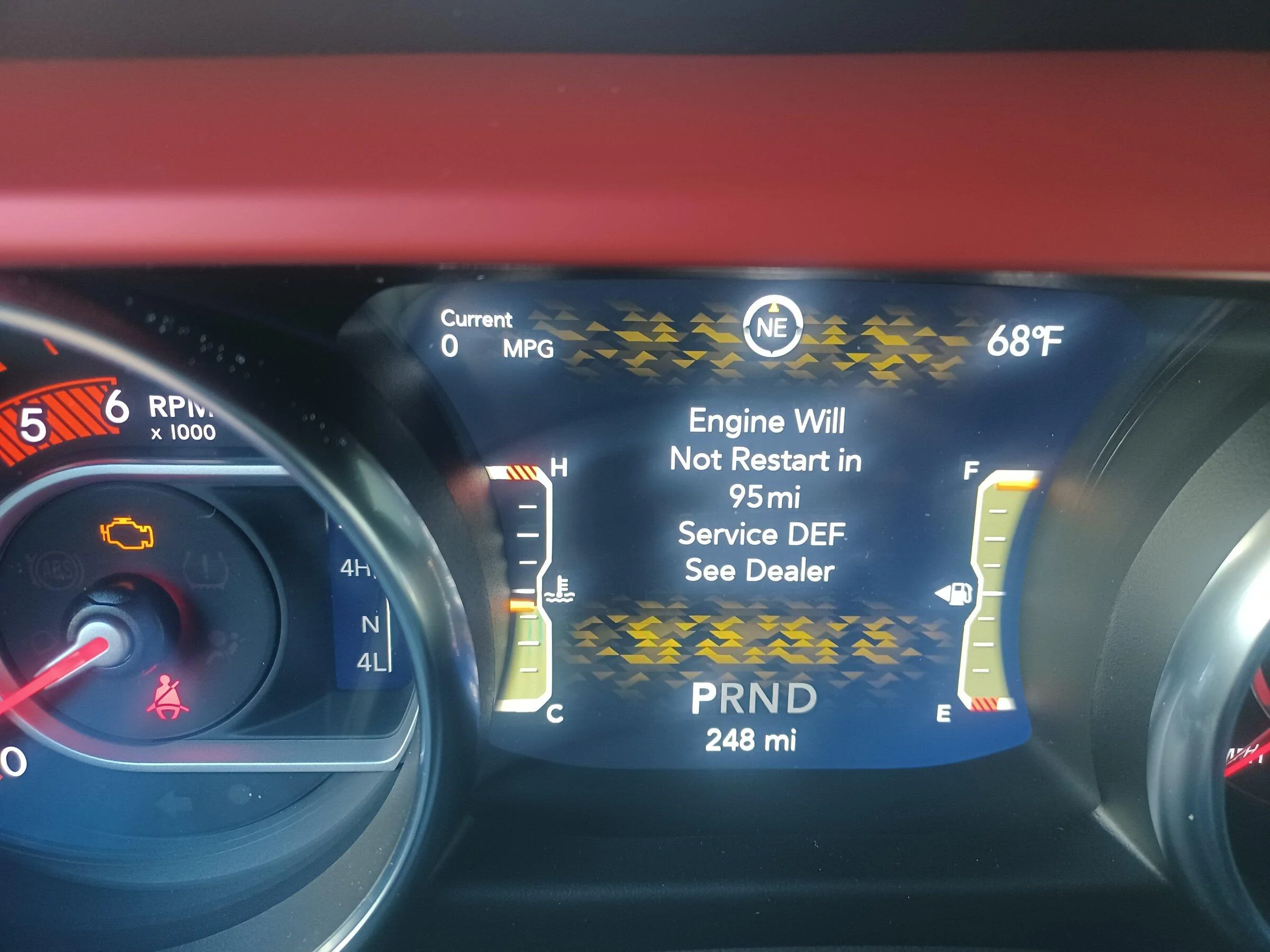

I got the same countdown-of-death at 600 miles. Still back at dealership. They’re trying to replace both nox sensors

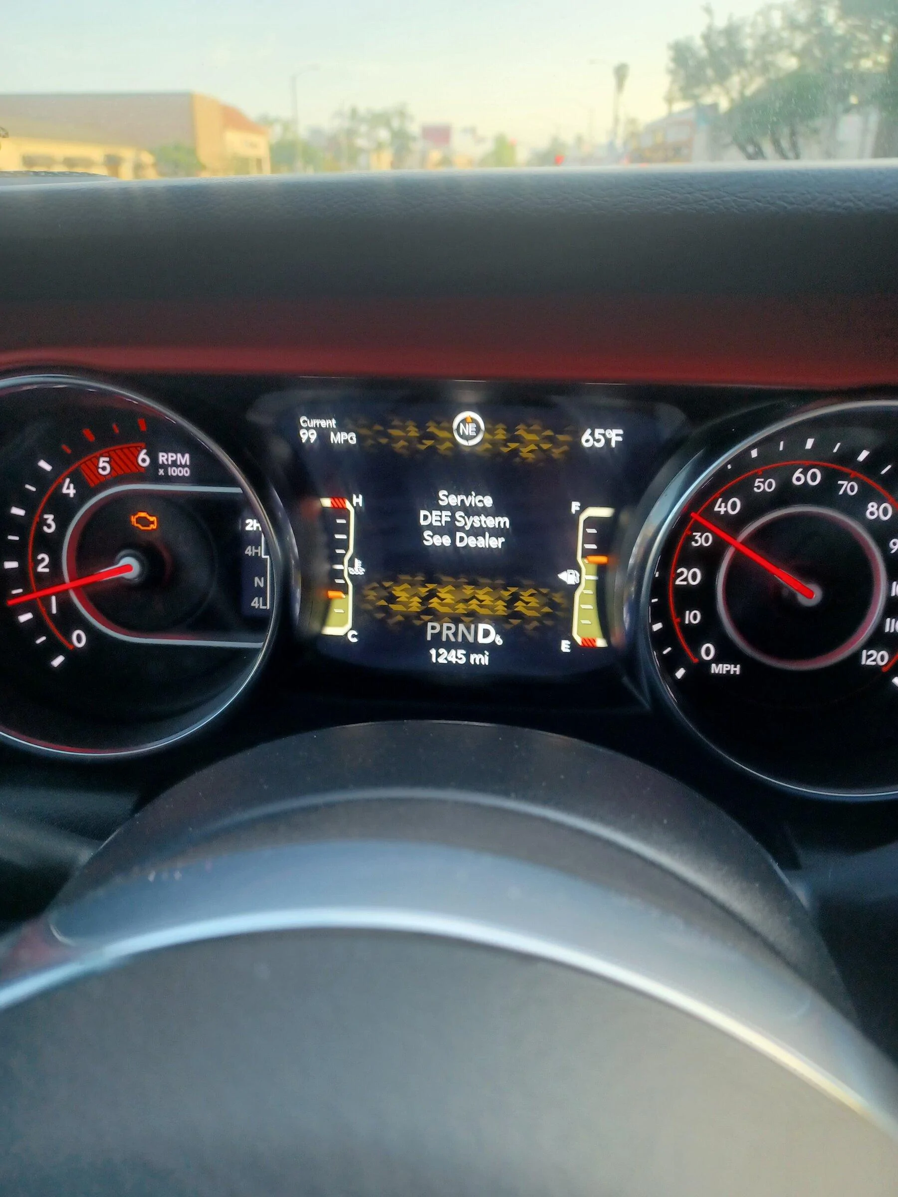

OP, did they resolve your issue? Bought my JTWD last month and I had the countdown almost immediately. 25k on the clock. Love the truck, hate the DEF system.
anyhow, service dept I took it to stated it has been in shop before for same issue 3x. Ecm and both nox sensors have been replaced more than once but not the tank, injector or heater. They refused to work on it so I had to ship it to the dealer I purchased it from. They are in process of doing a fix…

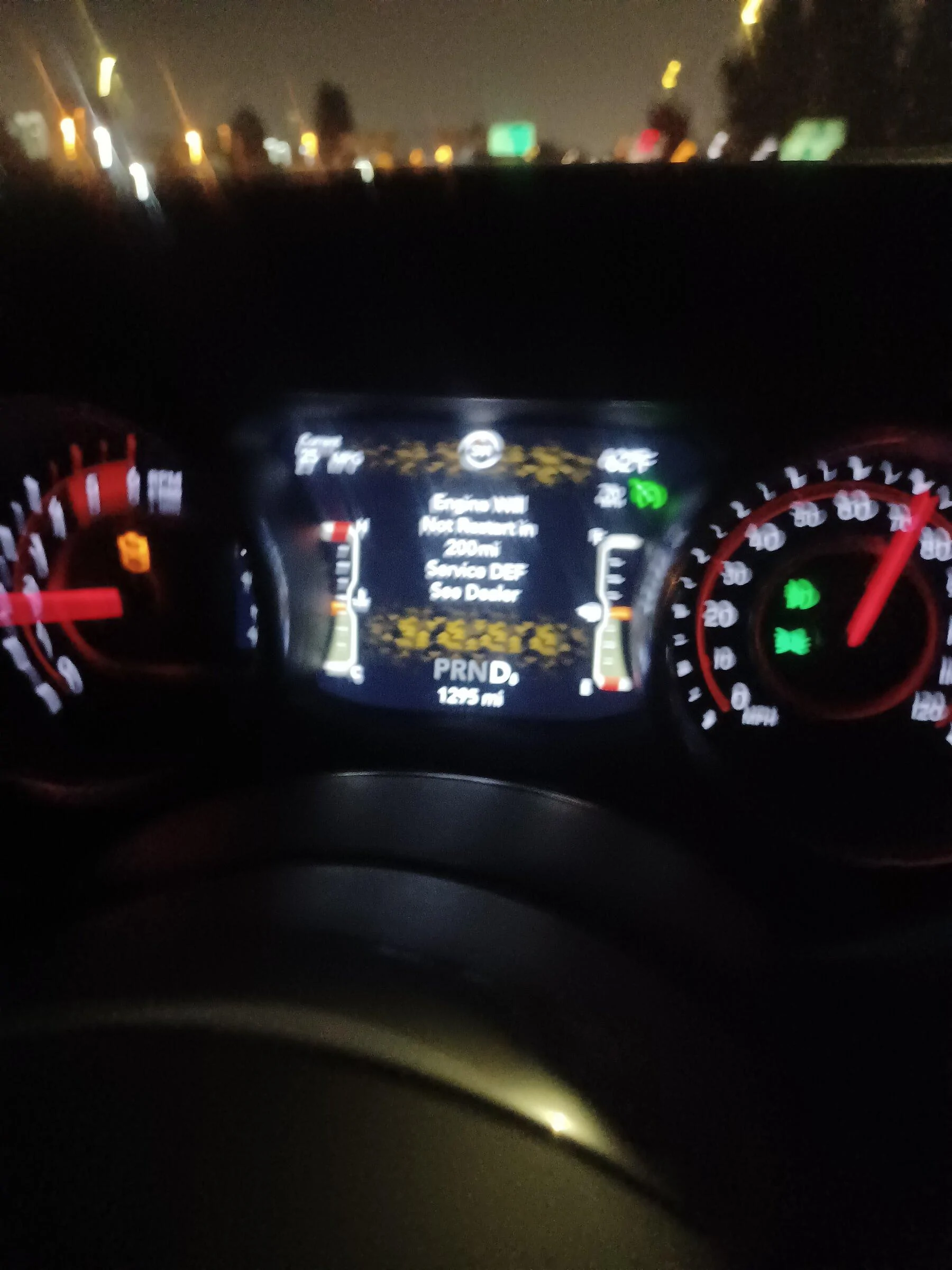

Ate my own words. 27k on the odometer and just got the service def see dealer message. I was in the middle of a trail on Sedona 6 1/2 hours from home. It was in the low 30s, don’t think temps were low enough to freeze.
