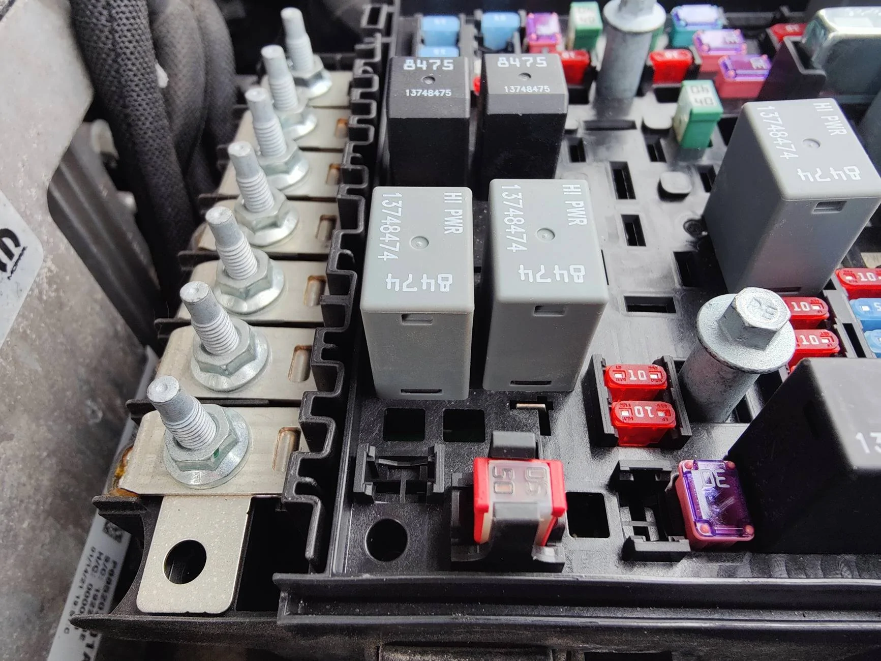

If anyone gets stranded in a remote location with that stupid DEF countdown to 0, there's a way to jump relays to start the truck.
Just connect pins 30 & 87 on START/STOP relay, then do the same with STARTER relay.
This saved me from calling a tow truck, I hope it helps someone else.

Can you post some pictures when you get a chance of how you did it ?

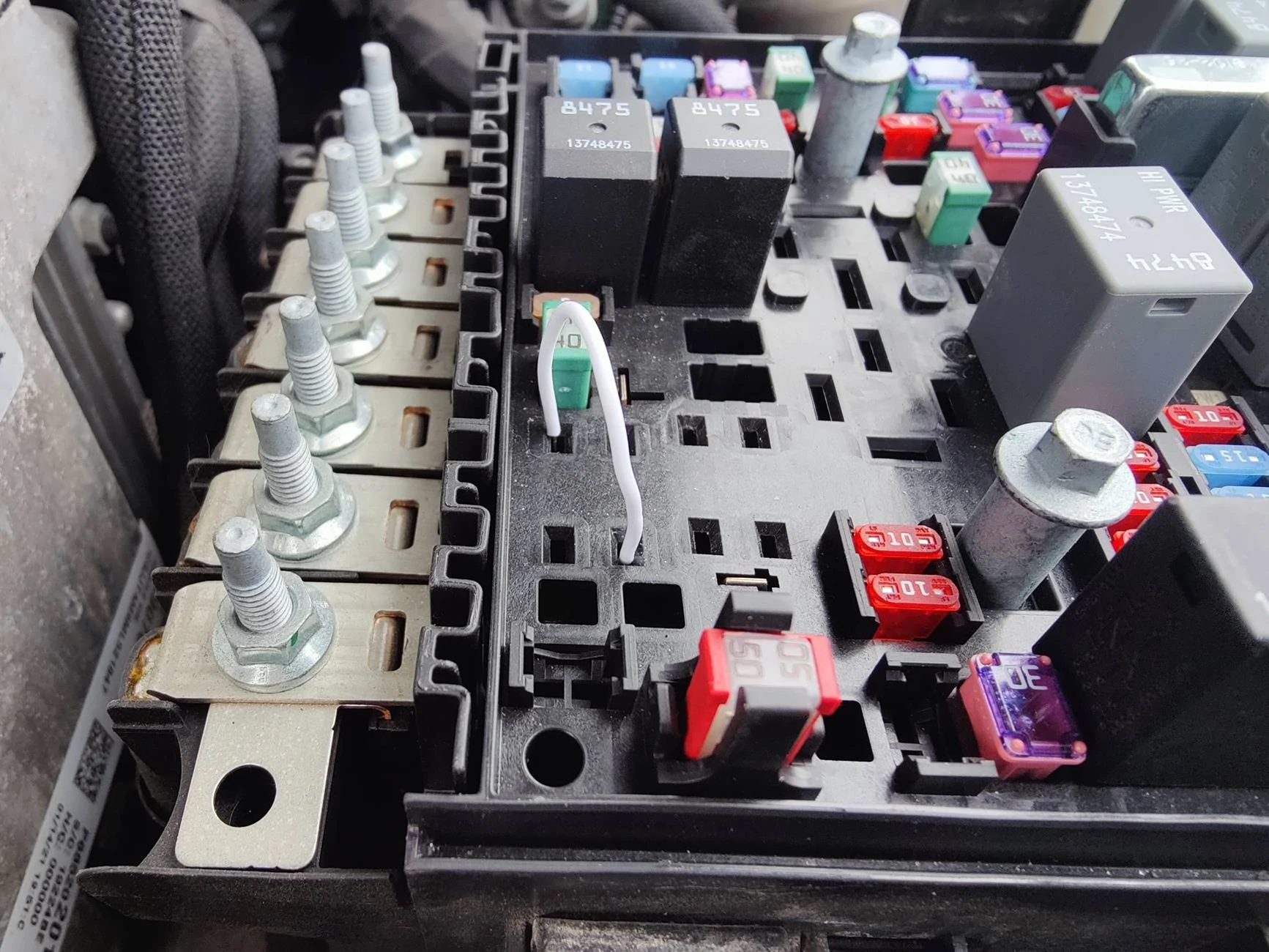

Do you have to remove the wire once started and put relays back in?

So then take jumper out and reinstall the relays?!
Technically you don't have to reinstall the starter relay, but must keep the run/stop jumper in place though.
Edit: better to make a jumper with a momentary switch so you don't need to removed until refilled with def.
