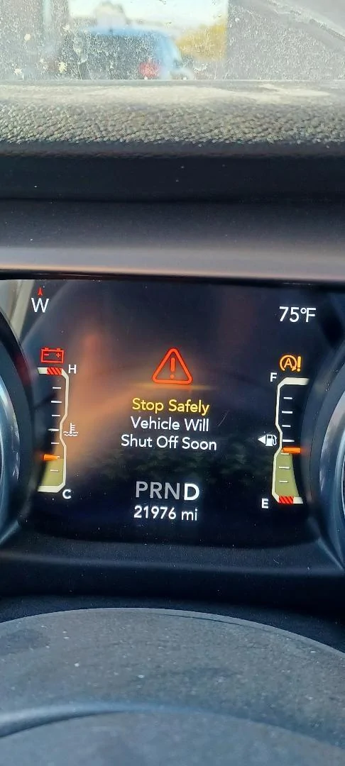

Okay so i changed the small battery under the fuse box because i was getting the service the start stop system. when I got done a picture of a battery came up on the display and it said "stop safely the vehicle will shut off soon". Anybody else seen this and know what did wrong while putting the battery in? any help would be appreciated

Was the battery fully charged when you installed it?
Did you disconnect the primary battery while you did the swap?
Disconnect both batteries and battery grounds.
Make sure both batteries are fully charged.
Reconnect the batteries.
Make sure all connectors under the fuse box are properly seated.
Make sure all fuses and relays in the fuse box are properly seated.
System will take up to 24 hours to recover from reset.
If still having issues, will need a dealer visit.
