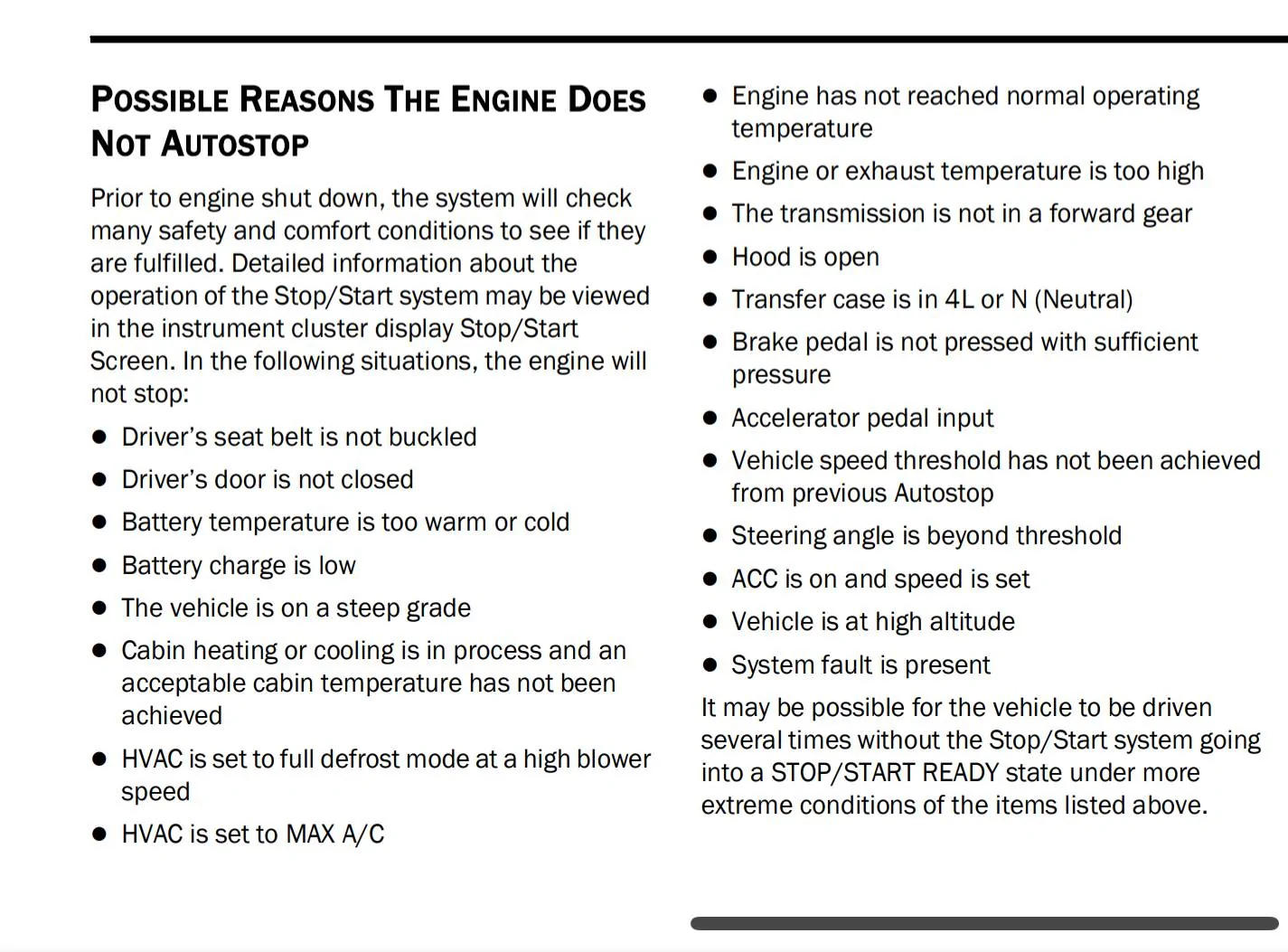

Yes and no. The batteries that the dealer put in may not have been fully charged. It is normal to see that message after the Jeep sits for a few days. Once the batteries start to age you may see that message on for longer periods. The fact that you saw it after after new batteries, would indicate that the batteries need a charge.
Since both of your batteries are new, pick up an AGM battery charger. You can get a AGM trickle charger at a good price on Amazon. I like the NOCO Genius 2d.
Other things to consider looking at before messing around under the hood are the
IBS
Fuse array, (be careful hooking up chargers and disconnecting cables)

For me it's always a few minutes, generally the engine has to get to its normal operating temperature
Yes. But if the batteries are up to speed it should go from cabin heating and cooling if selected on to ESS Ready. If Climate control is off it should say that the engine is not warm enough before saying Ready. If it says battery charging, the batteries need charging. Depending on how long it says battery charging is your clue on how discharged the batteries are.
The first start of the day ( especially on a cold day) you may see battery charging after warm-up. I would not worry too much if it goes out after 10-20 minutes.
12,004
32,045
There is a bunch of parameters that have to be met before the auto/stop works. If you have the steering wheel turned too far. Not enough pressure on the brake pedal. A/C on high. Anything that puts a load on the electrical system. Etc.
