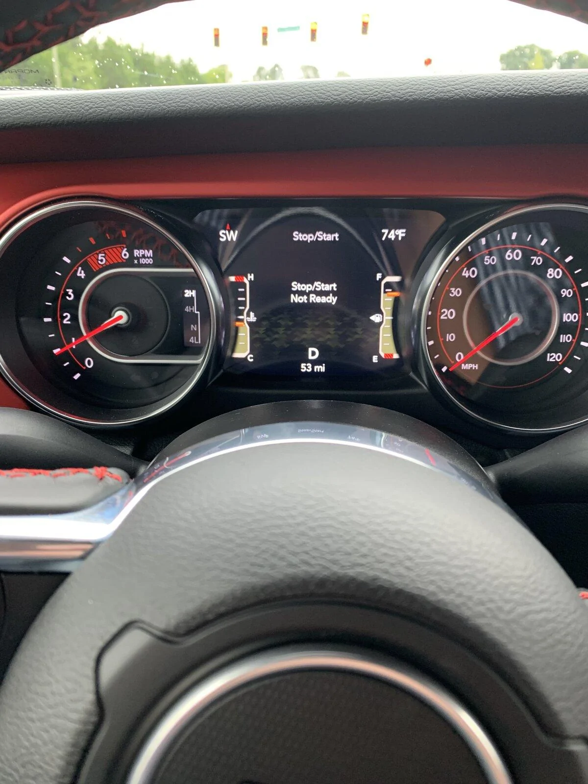

Thanks for the replies. It actually started working today. It was probably either the battery or the outside temperature. Here is the pic with no explanation.

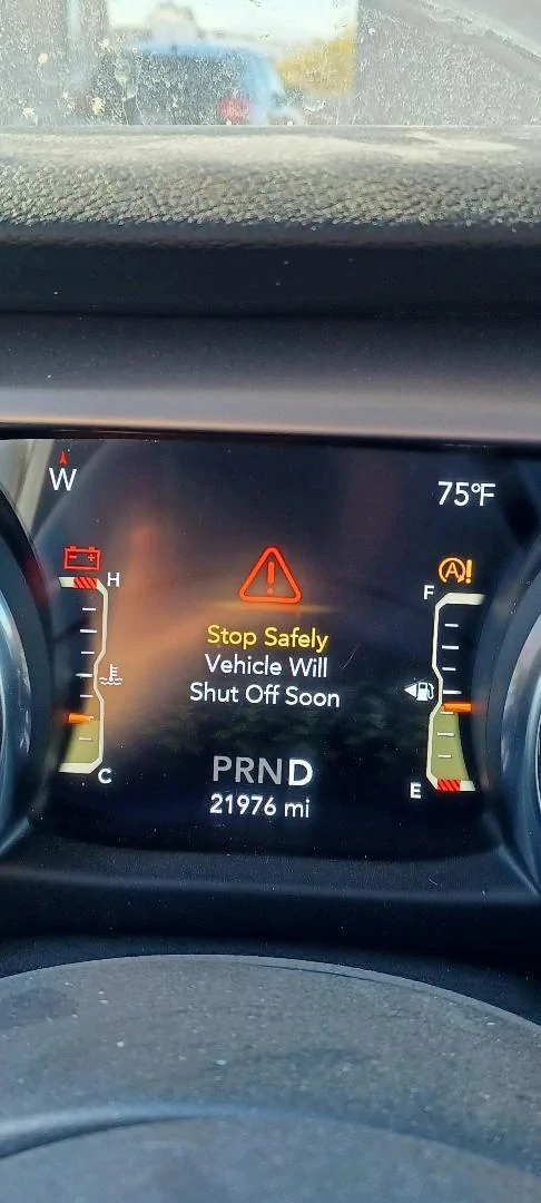

Okay so i changed the small battery under the fuse box because i was getting the service the start stop system. when I got done a picture of a battery came up on the display and it said "stop safely the vehicle will shut off soon". Anybody else seen this and know what I did wrong while putting the battery in? any help would be appreciated
Jeep Gladiator Auto Start / Stop not ready on new JTRD? Jeep warning

Hi, just picked up my JTRD today. The auto start / stop is not working (not necessarily a bad thing) and I keep getting a message that the auto start / stop is not ready. No explanation as to why. I assume normally the auto start / stop should work right off the lot on a new diesel? I thought it might be possible that it's disabled until the engine breaks in a bit (unlikely). Any suggestions other than taking it in for service? Thanks
AutoStop-Start work once the Engine is hot enough, otherwise it will give a message AutoStopStart is disabled

There's a lot more to it than that. In the cases being discussed here it's not a matter of the engine not being warm enough.
If it's not warm enough, the cluster will tell you that. If your steering wheel is turned, it will tell you that, if the battery is charging, it will tell you that. These guys are getting a message with no explanation.
