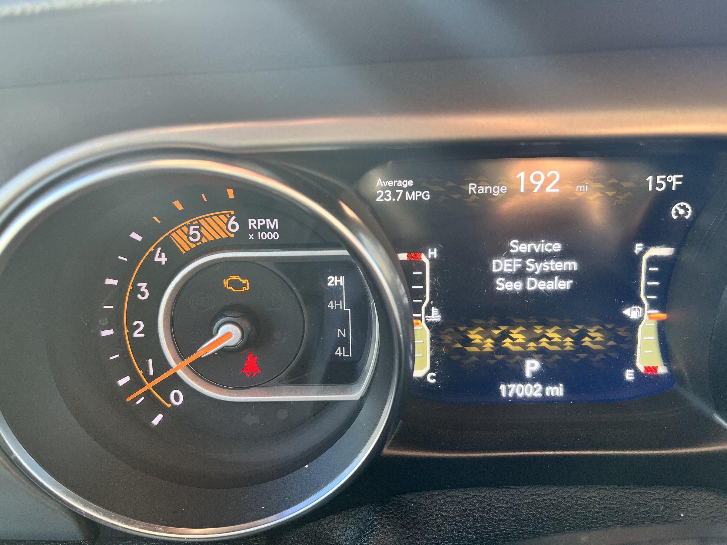

Goes in Friday. But now for this , I’m betting the heater is part of the reason the battery has been charging.

So I’m sitting here waiting for them to charge the battery…. They say cold weather is tough on battery’s … I said no shit but driving two hrs a day should keep them topped off. Uh ummm yea it should but the charger says it’s low. Well do you think maybe there is something wrong with the charging system?? I’m uh well yeah perhaps but we can’t test that until the battery is fully charged…

Well, they are right in that it's hard to totally check the charging system in modern vehicles if the batteries aren't up to snuff. Even on my test bench doing legacy type alternators, I can't get good info if the battery on my test bench is low.
Yes, driving 2 hours a day absolutely should keep things up or topped off. I understand mine not keeping up in cold weather as it may sit 2 or 3 days and I can drive it 2 hours before ESS is ready (in the summer doesn't take long at all)
I think the batteries Jeep is using are not so great.......... too many fail. I also wonder if the IBS isn't working as it should on a lot of these.
