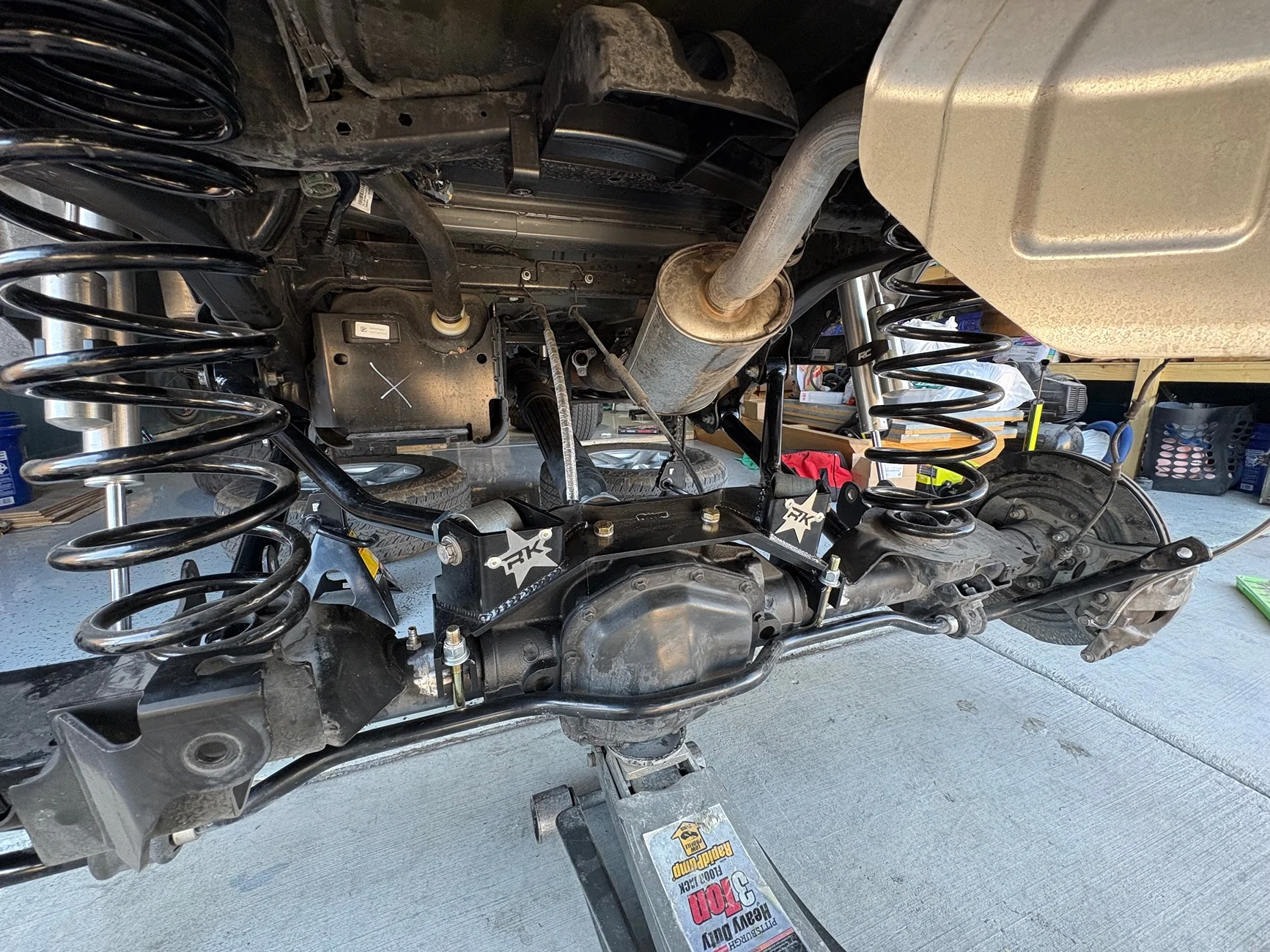

I think I used 16 gauge. I just turned it into a four link suspension system as I purchased the arms to be able to do that from Rock Krawler when I purchased the five link kit. I need to be able to drive the vehicle in the winter and was concerned about the Def freezing up here. Also my wife really didn't like driving it due to the articulation while driving on uneven roads and I still have a lot of warranty period remaining.

That’s surprising, most people say doing the four link setup improves on road driving. What was your experience like on road ?

Yes, when I changed back to four link it was much better on the road

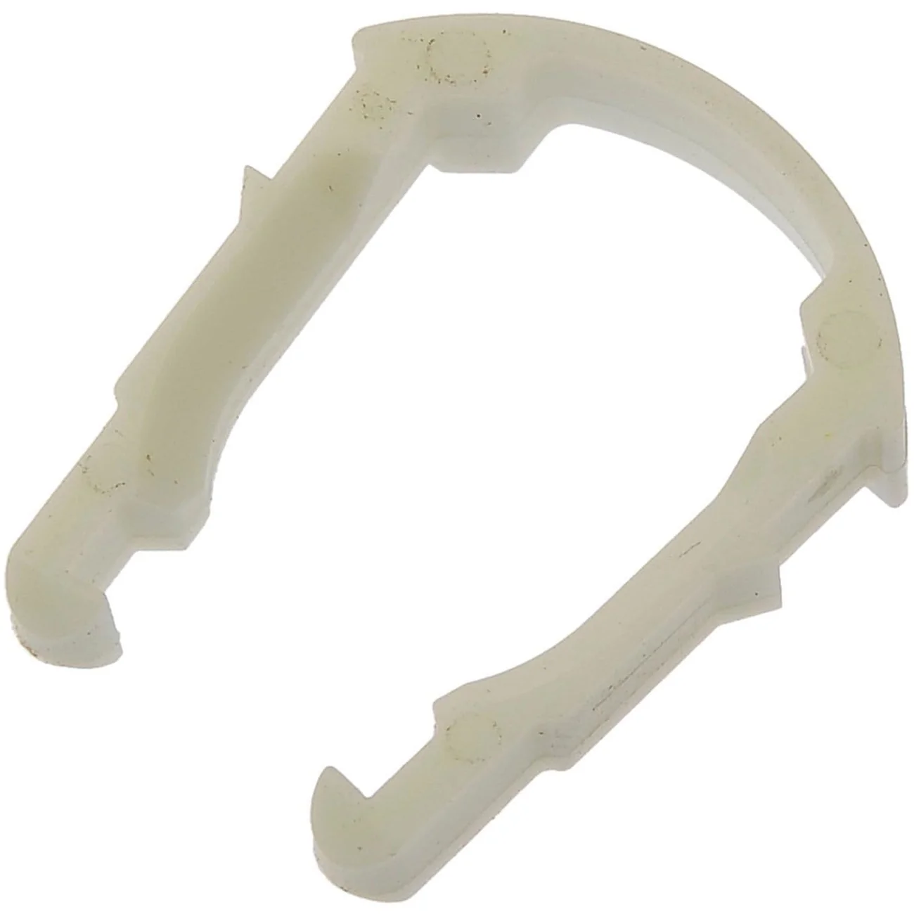

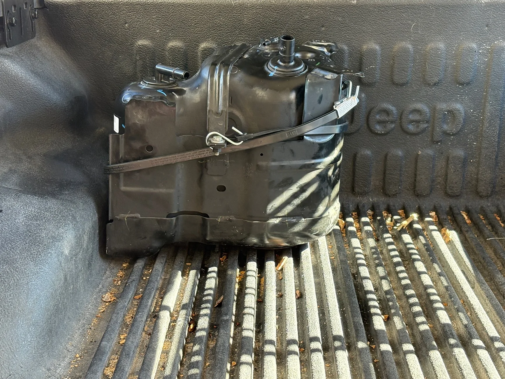

Well it’s in. I temporarily remounted the def tank until one day it goes missing. Just hole sawed through the bed of truck, uncllipped the def injector line and wiring harness which had enough slack to not need any extension of wires/line. I’ll weld some brackets together at some point to hard mount it into the bed but for now it works. Only issue I’ve run into is a very slow def leak due to breaking the plastic clip that secures the line, the generic clips I’ve found at autozone don’t fit, if anyone know a clip that works let me know.

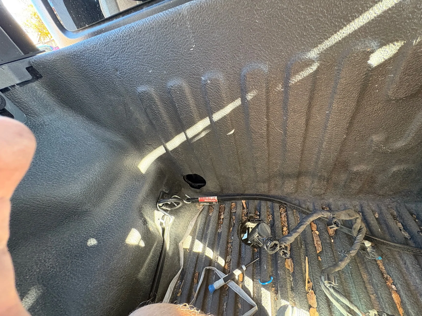

Do you have additional pictures showing where you went through the bed and with wiring ect installed. Thanks

this is where I hole sawed through. Just gotta be careful cause the gas tank feeder line is below.
