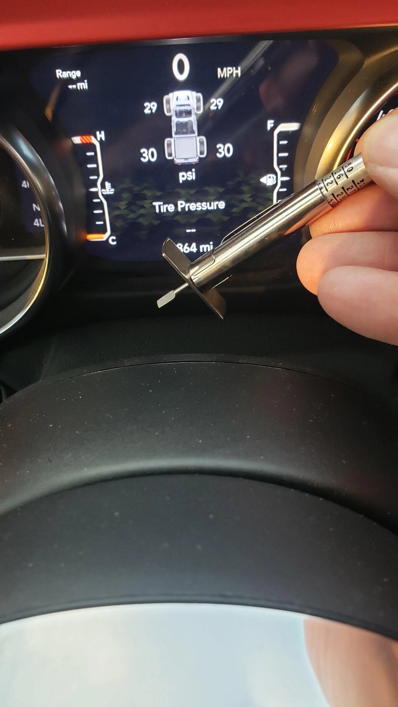

When I purchased my Rubicon, I watched my falken 33's very closely for the first couple of thousand miles. The best indicator for me was the wear on little tits from the mold. I noticed the front wears faster in the center of the tire at the same pressure. I settled on 28lbs cold at about 60 degrees outside. At 70-80 degrees my tires will read 29-30 cold then warm up to the low 30's. When it's cold in the morning my pressure drops to approximately 25-26 at start only to come up to 29-31 within about ten to fifteen miles or so.
I also purchased a tread depth gage on line for a few bucks. I keep a pretty close eye my tires for even wear. This pic was taken at 78 degrees. Good luck!

I did at first with the Jscan. But I turned it back because its a quick look at tire pressure every time I fire up the engine. Just a good fyi for me whenever I get started.
