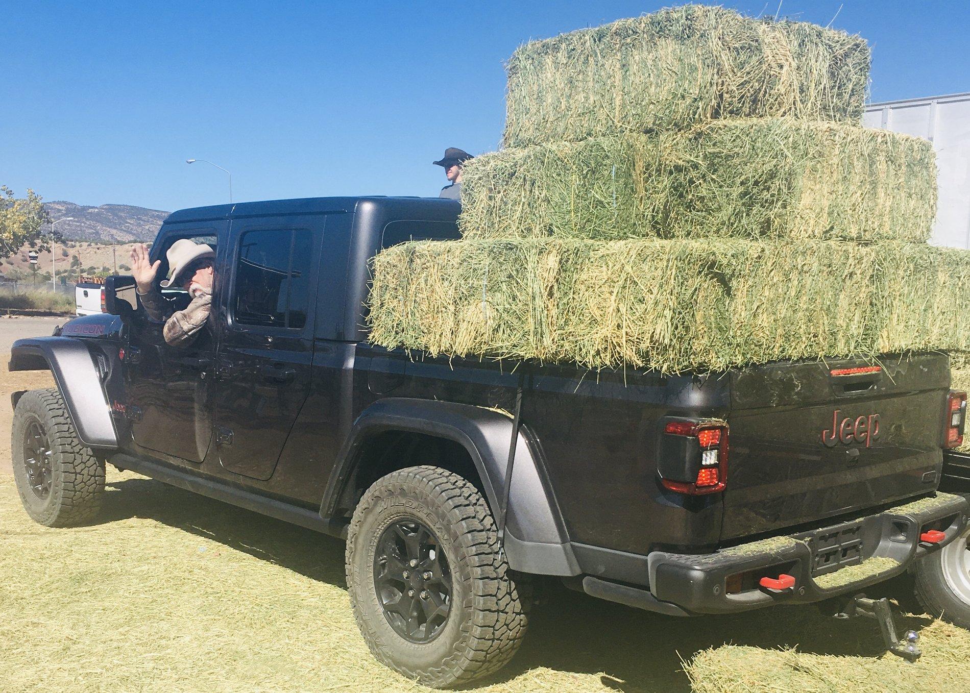

I face a double whammy... I live in the Mountains outside of Santa Fe (NM) at 8500ft. Not only do we wake up to low temps, lowering psi, but altitude also lowers psi. So, on a cold morning, I start off with 29 psi, which is fine for our dirt roads and snow (offgrid wilderness cabin) getting to a paved road. When I do hit the pavement, the speed and heat raise the psi to 32, 33... then when I go down (in altitude) to Santa Fe or Albuquerque, it rises to 34, 35... and when I hit the low country interstates, it goes up to 36, 37!
Course, when I picked it up from the dealer, psi was 45 cold and 48, 50, at hiway speeds... (just a little floaty on the pavement)! I only drove a mile or two before pulling into a Walmart and airing down! ;{
