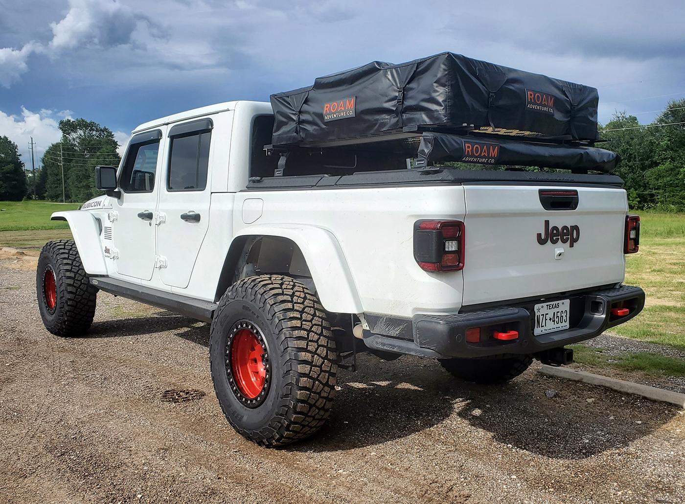

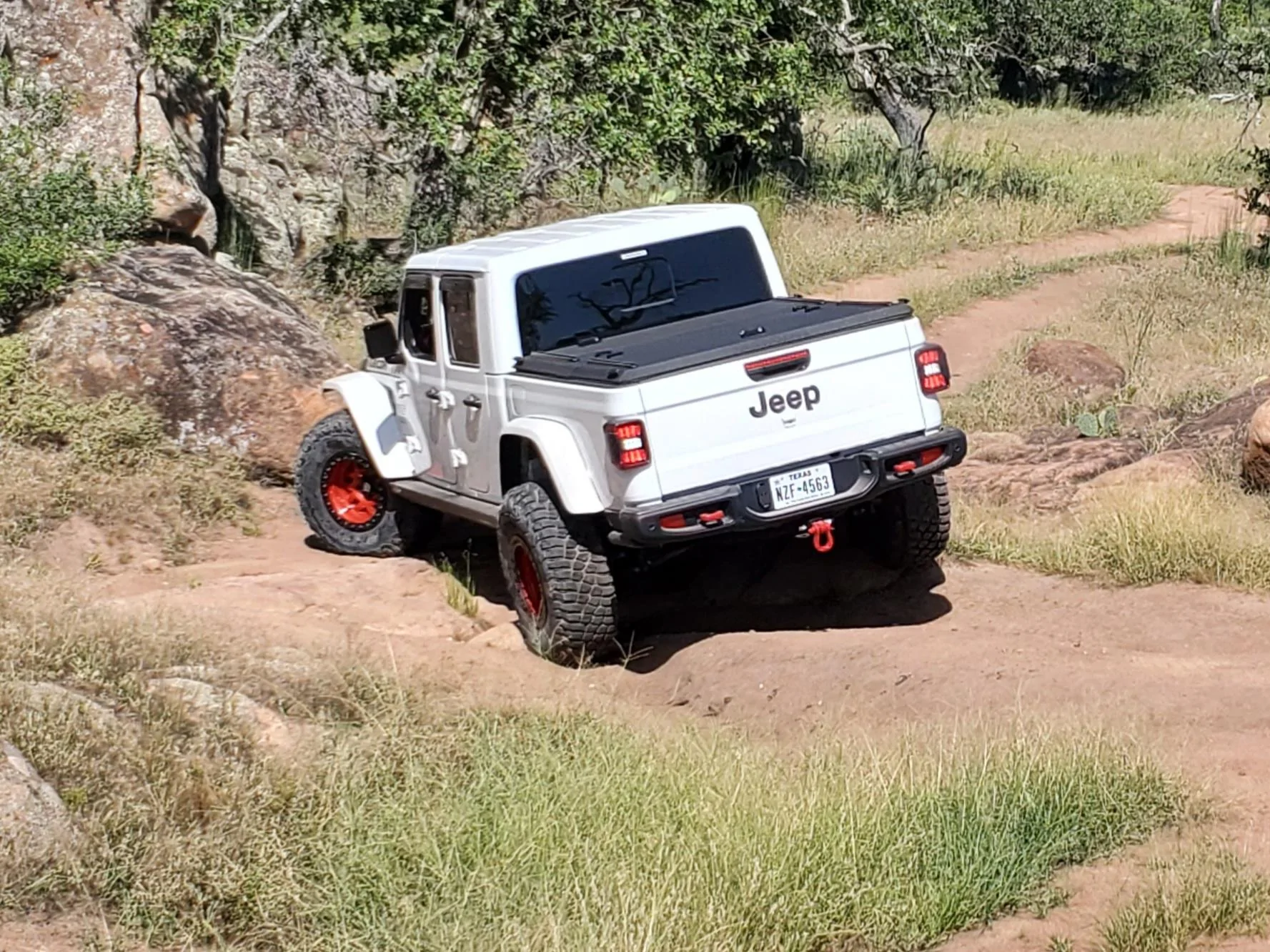

Absolutely love my Diamondback. It was definitely a bit stressful to start drilling into it but it sure is worth it when you're done.
Jeep Gladiator DiamondBack Covers | General Thread 20210714_172351
Took the rack/tent off to go wheeling this past weekend. Super convenient and still looks great with the base rails attached to the cover.
Jeep Gladiator DiamondBack Covers | General Thread 20210904_110921
Very happy customer. Highly recommended product!

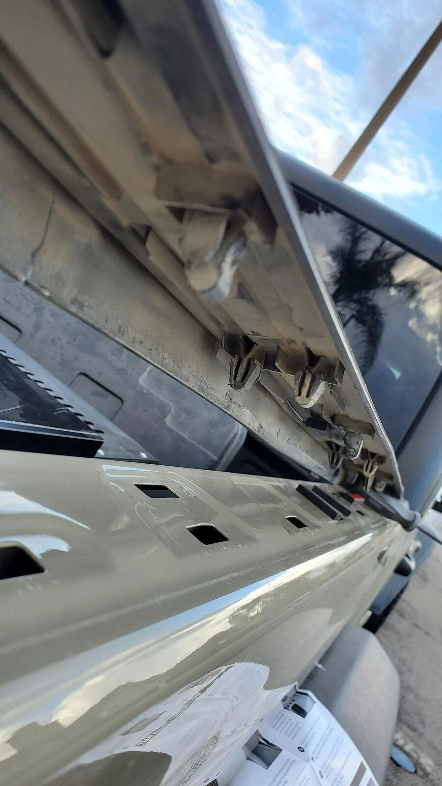

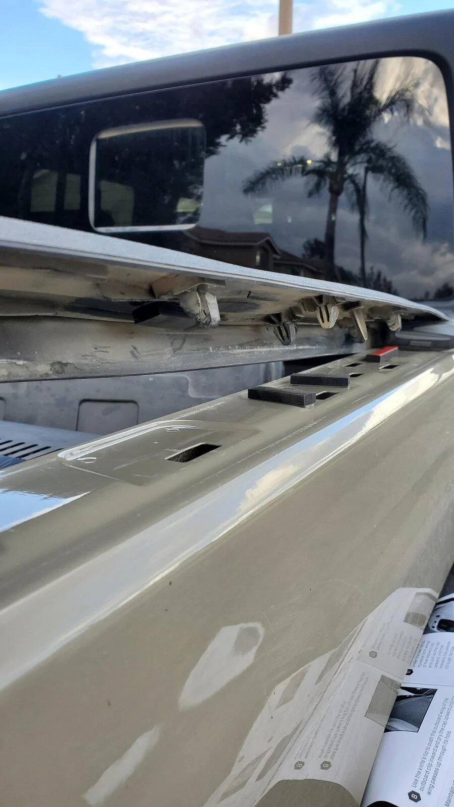

How do you ā€˜pinch’ the clips effectively? I can barely reach the damned things
been told a pry tool or butter knife works. There’s downloadable instruction DB has online that recommends that.

Glad it worked for y’all….me? Not so much
I haven’t tried it yet. I still haven’t purchased yet personally. I will be very soon. And I’ve done a bunch of research on the shim install. I’m hoping to not have problems myself. But I’ve got a general idea. I haven’t heard many people not at least breaking off 1 clip.
Broke a few but got the DB on; ran out of time and will finish and fine tune in morning. Looks awesome.
