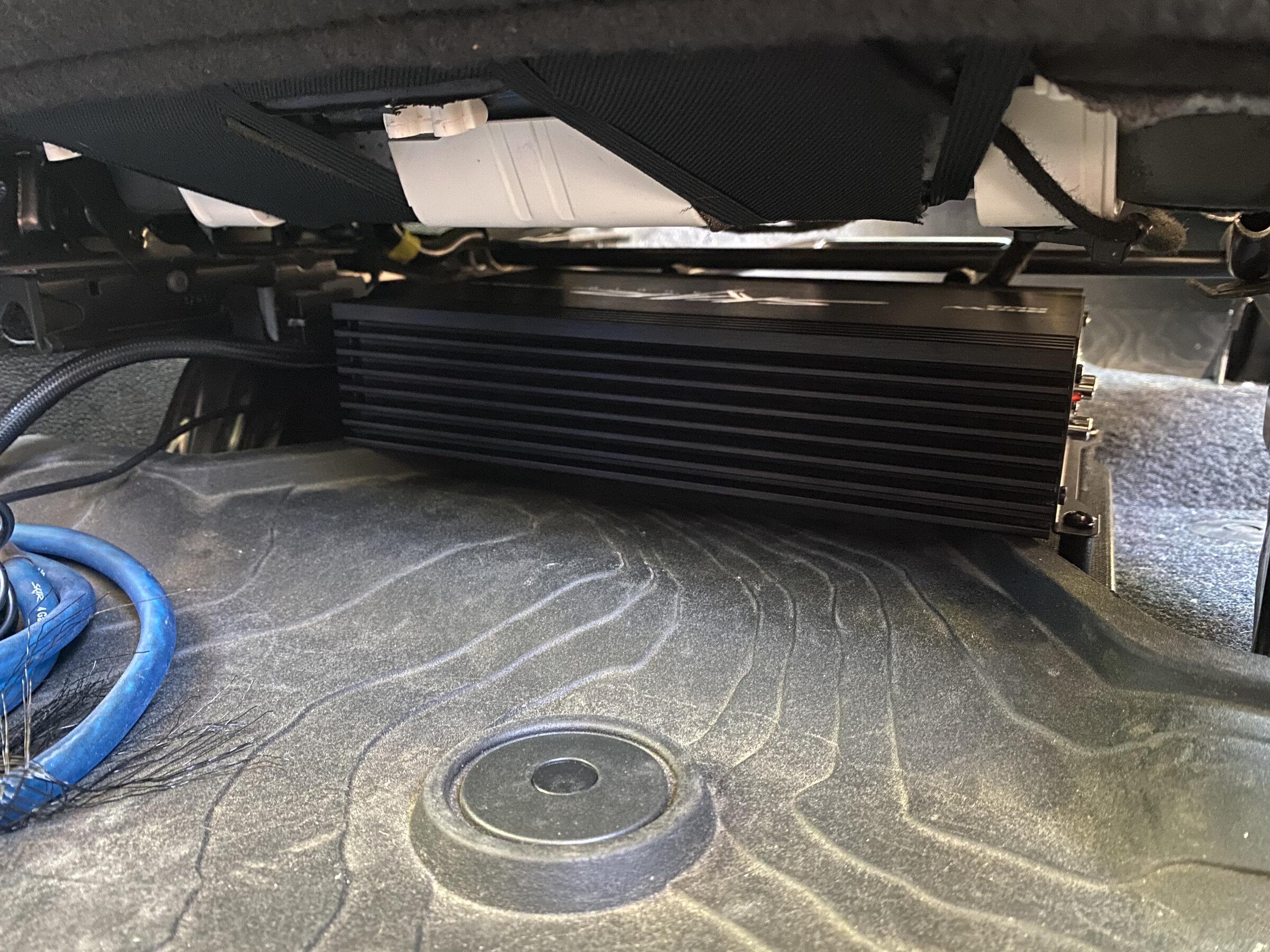

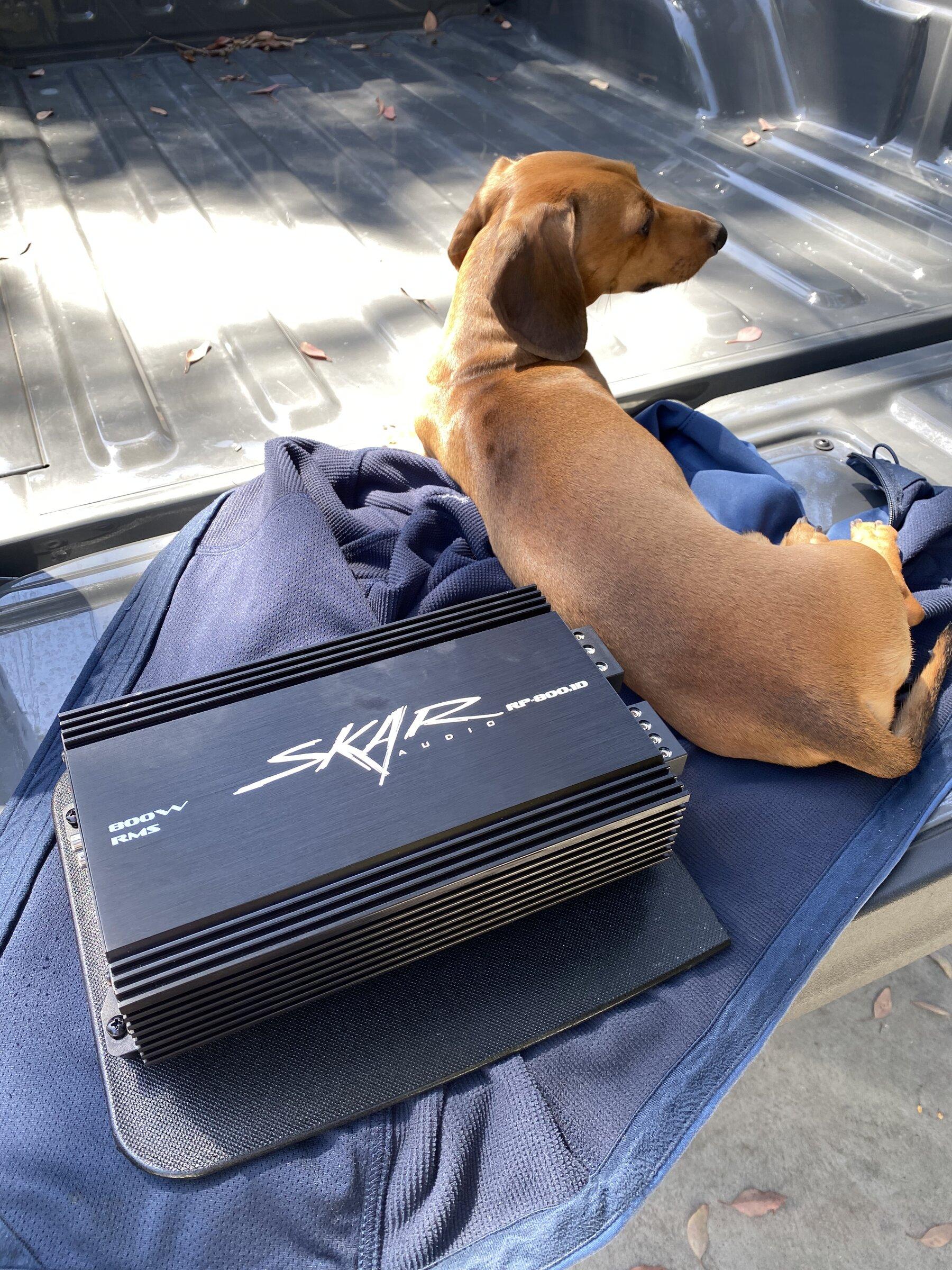

Hey guys,
So I am wanting to install my amplifier under the passenger seat. I ran the wires there and have a plan in place.
I wanted to make a mount with risers for the amplifier for 3 purposes.
1. To have something sturdy to affix the amp
2. Clear the floor mat
3. Clear the floor ac/heater vent (somewhat)
Jeep Gladiator DIY Amp “rack” on the cheap (cutting board) 76E7E207-F5EB-4342-A559-CEFD82F76B42
I’ll show you finished pics up top and then the process.
Jeep Gladiator DIY Amp “rack” on the cheap (cutting board) E59FDD3A-BE52-4B84-9DA9-8821E2CA2CD0
Jeep Gladiator DIY Amp “rack” on the cheap (cutting board) F5C8A5EF-2202-46A4-986D-475522308399
Jeep Gladiator DIY Amp “rack” on the cheap (cutting board) 688D0B25-9D14-4CC2-A314-049EC425910C

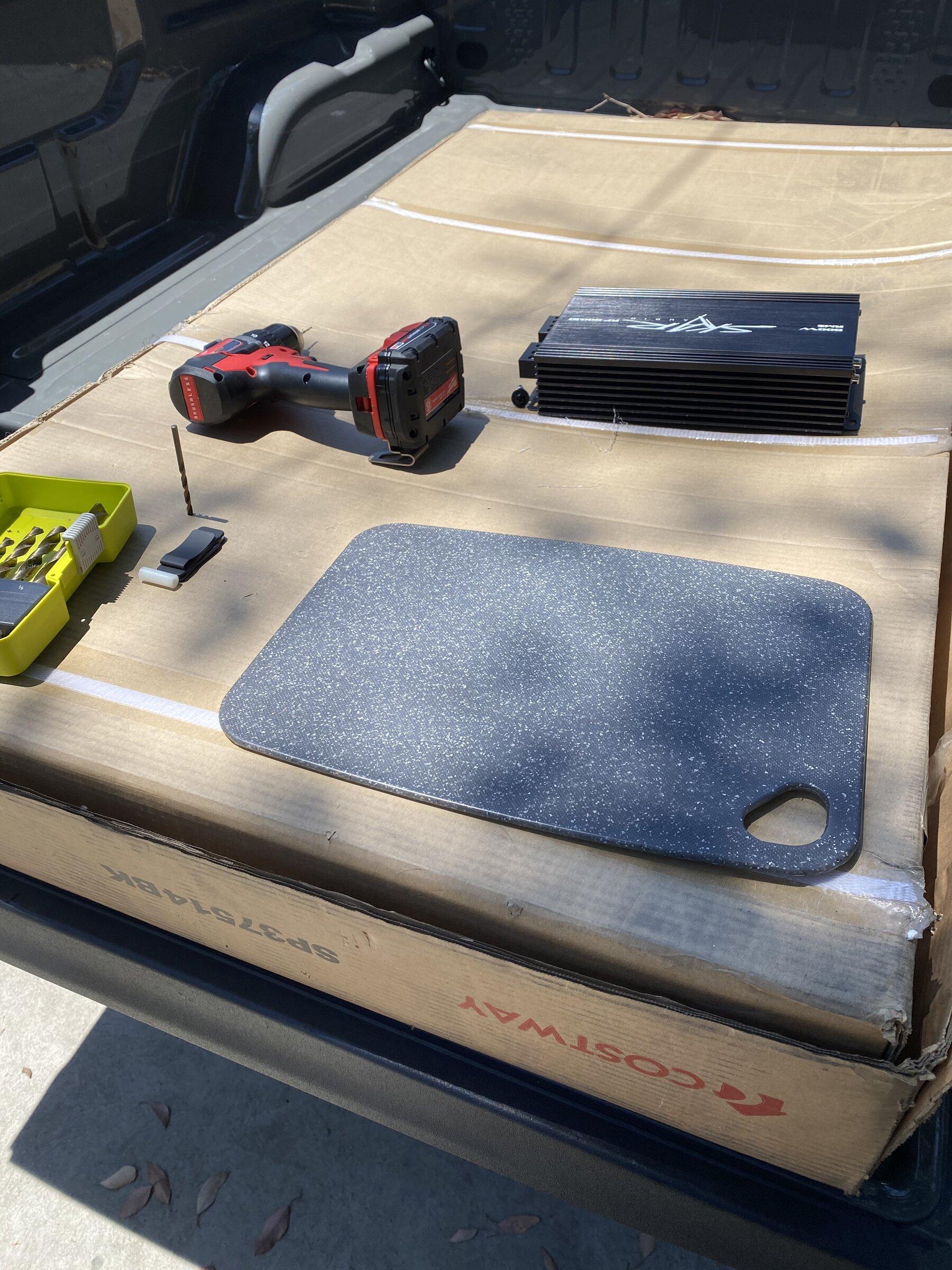

Step 1 was finding a good small sheet of plastic. Asked my dad for ideas and my mom chimed in ”a cutting board!” Perfect idea.
Small and cheap. $5 at Big Lots.
After that I measured, drilled my holes and test fit.
Jeep Gladiator DIY Amp “rack” on the cheap (cutting board) 4F477D7B-BE55-46C5-92FE-2F4DBC75C6C3

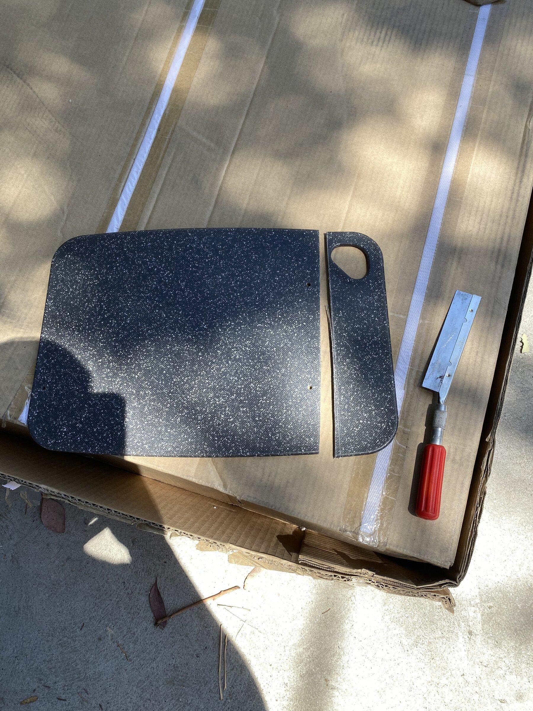

The board was a little wide so I had to trim about 1 1/2” off. I know. It’s very crooked and janky 😂
Be thankful for your workbenches and powertools gentleman. Apartment life is rough.
Jeep Gladiator DIY Amp “rack” on the cheap (cutting board) 427E046C-5E78-422F-91F8-D02106631A76

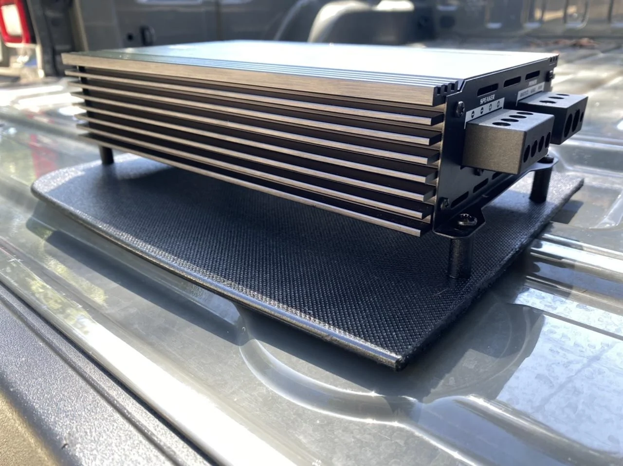

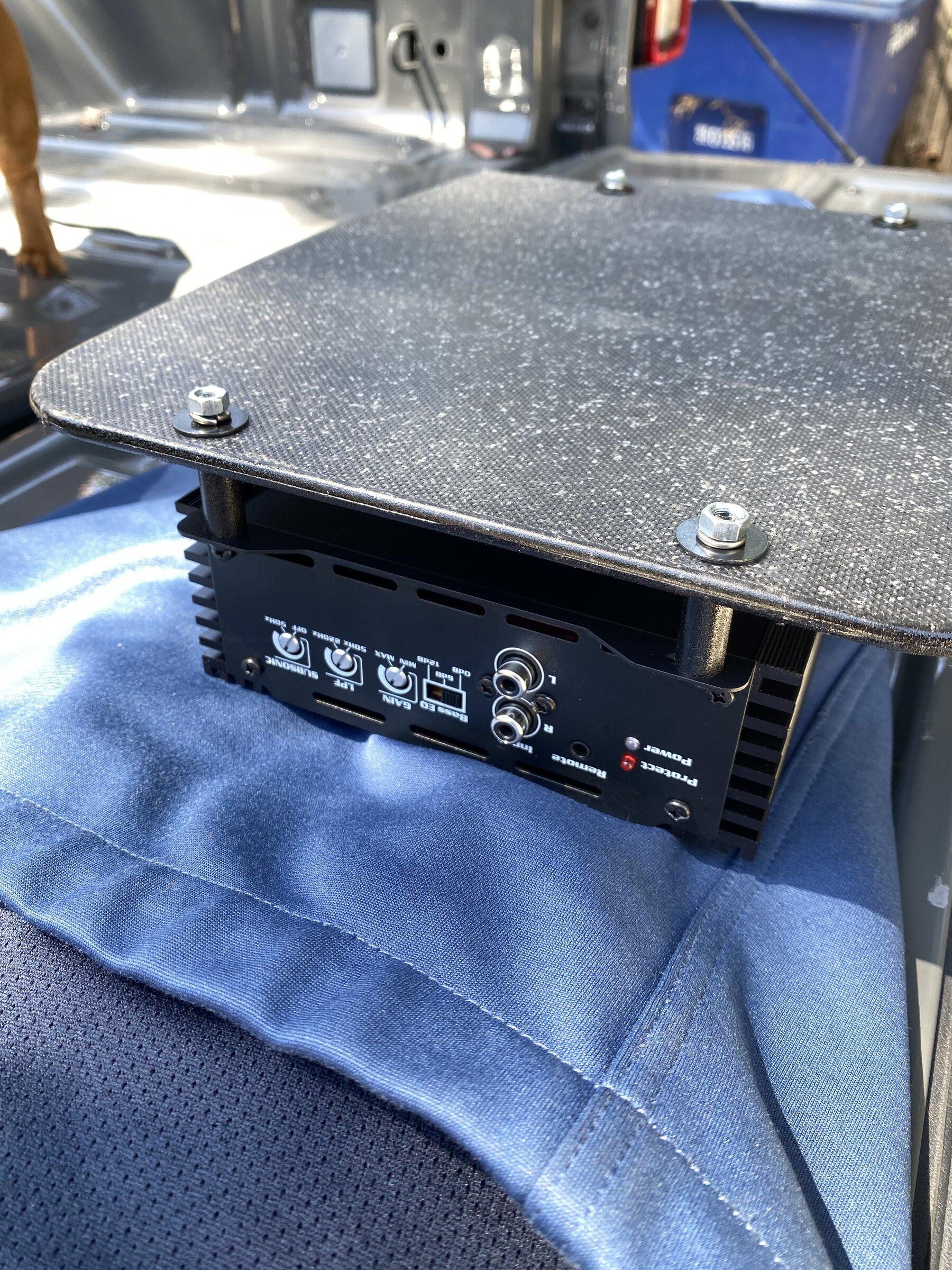

After test fitting, all looked good, I hit my spacers and board with some leftover spray bedliner I had. I attached my hardware and voila! Not very elegant but hey. It works and checks all my boxes.
Jeep Gladiator DIY Amp “rack” on the cheap (cutting board) 752D0FAF-ABA2-4E7C-9A34-E25642FAF97A

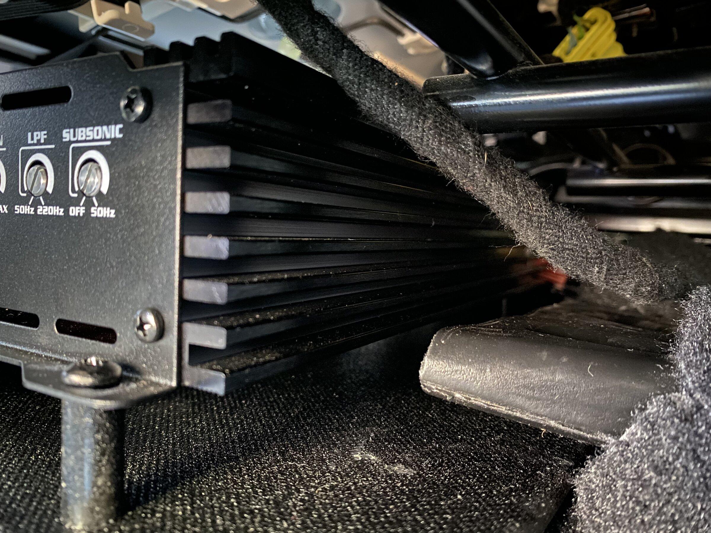

Here it is from under the seat. That floor vent tube at least kinda goes under. Before it was blasting right at the side of the thing.
Jeep Gladiator DIY Amp “rack” on the cheap (cutting board) B5677154-152D-4853-9033-00C0E96C6019
Jeep Gladiator DIY Amp “rack” on the cheap (cutting board) 613F4641-3599-440A-BA90-6CDB357BA289
Anyway, hope it helps and inspires someone to improve on the idea! Haha

Yikes! I can imagine! Truth be told I’m too chicken to ford any water. I’m a “Get a stick and check the depth first” kind of guy haha (NOT a euphemism 😂).
But at least I’d have 3/4” extra space thanks to those risers! Lol

Nice idea and writeup! So is the rack hard mounted to the floor in any way? I have to figure something out but cant bring myself to blow $220 on a bent piece of metal just cause JL Audio bent it. lol
Kirk_Dirksen
Kirk_Dirksen
Tony
Nov 15, 2020
47
106
California
2021 Gladiator Sport
