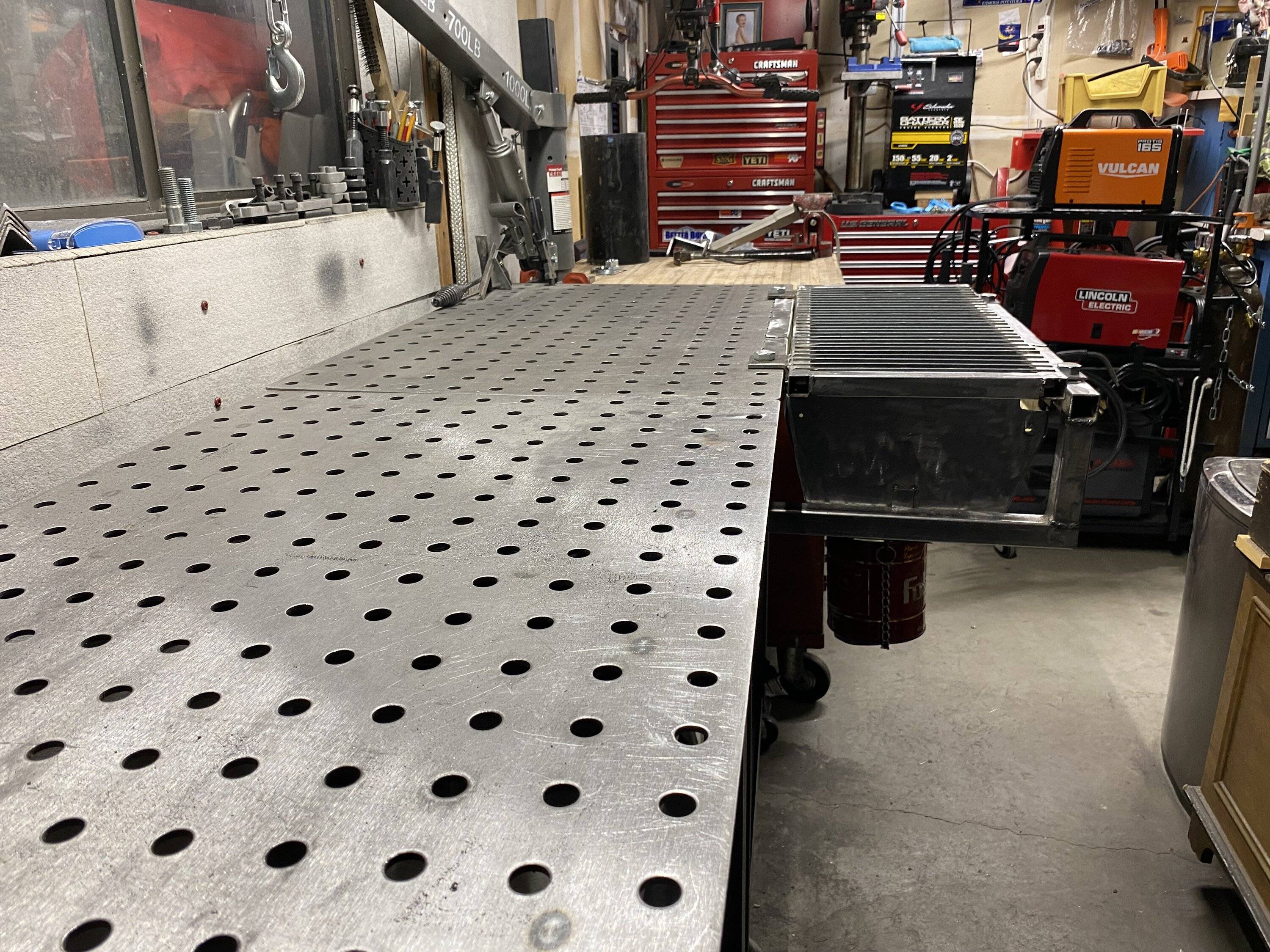

I'm just jealous of the garage. Fab table welder, mandrel bender? Fabricator by trade here.. Just not enough room in my garage

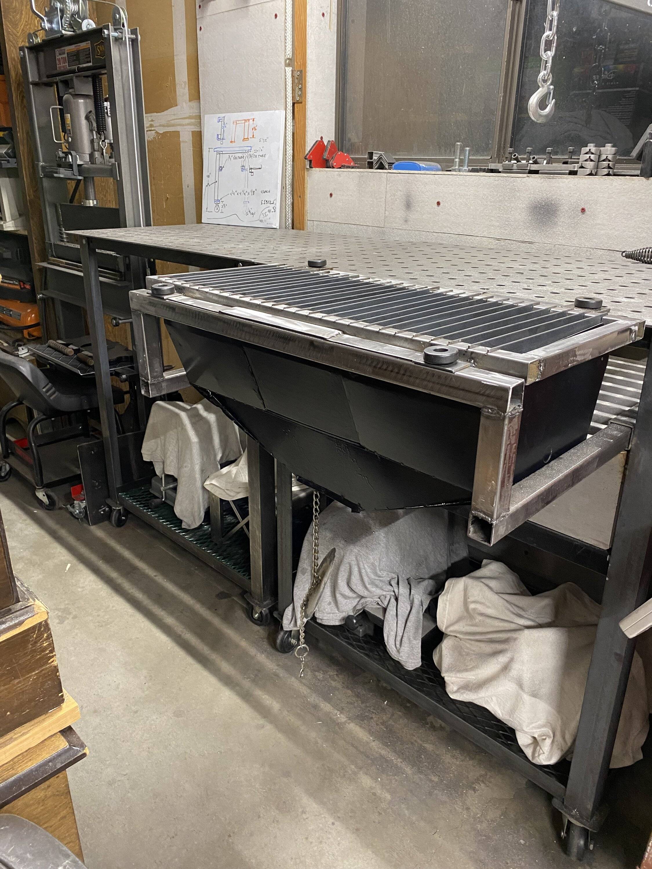

I feel you on the size of the garage to fab up projects, i took some action when I retired to try and make things better to do more fab projects in my small space. I’m attaching some pics that may give you some ideas to help overcome the issue. 2ea 2’x4’ Klutch fixture tops on casters and a burn table that slides into frame of the table. Every thing in the garage is on casters and can be moved in minutes to reconfigure the space, I hope this helps.

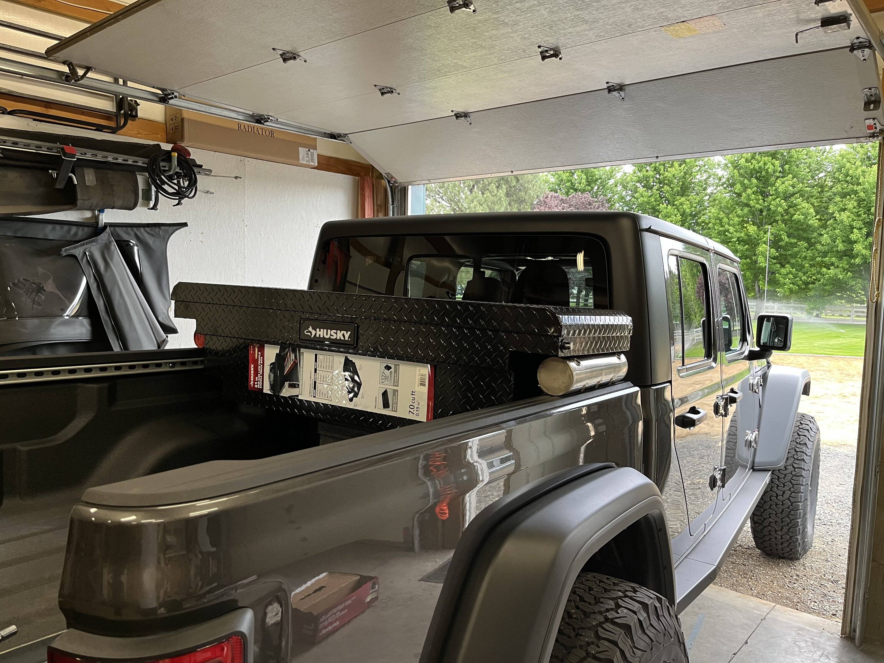

The air tank you built, did you pressure test it?
Yes, squeezed it incrementally up to 200psi. The ARB that feeds it cuts off at 150psi and I also have a blow-off valve set at 165psi. I don't leave it under pressure (unless I forget :facepalm: ) and I have used it at least a couple dozen times; knock on wood no explosions yet :whew: :LOL:

I’ve water tested a few old tanks over the years, they just go puff and spray water everywhere instead of going boom. Great job on the upgrades?

I guess I should have clarified that, I did hydro test... I don't like building bombs ;)
