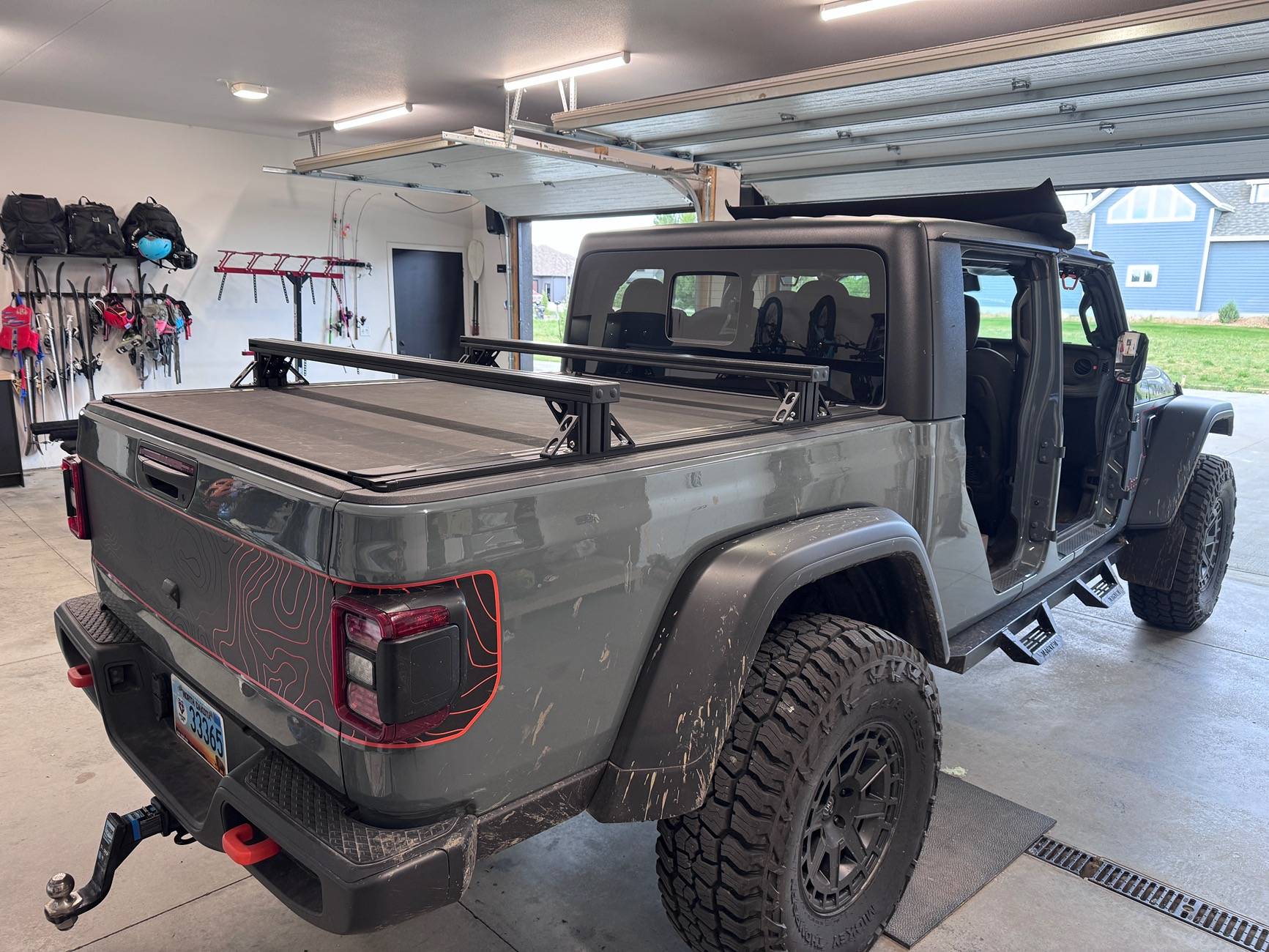

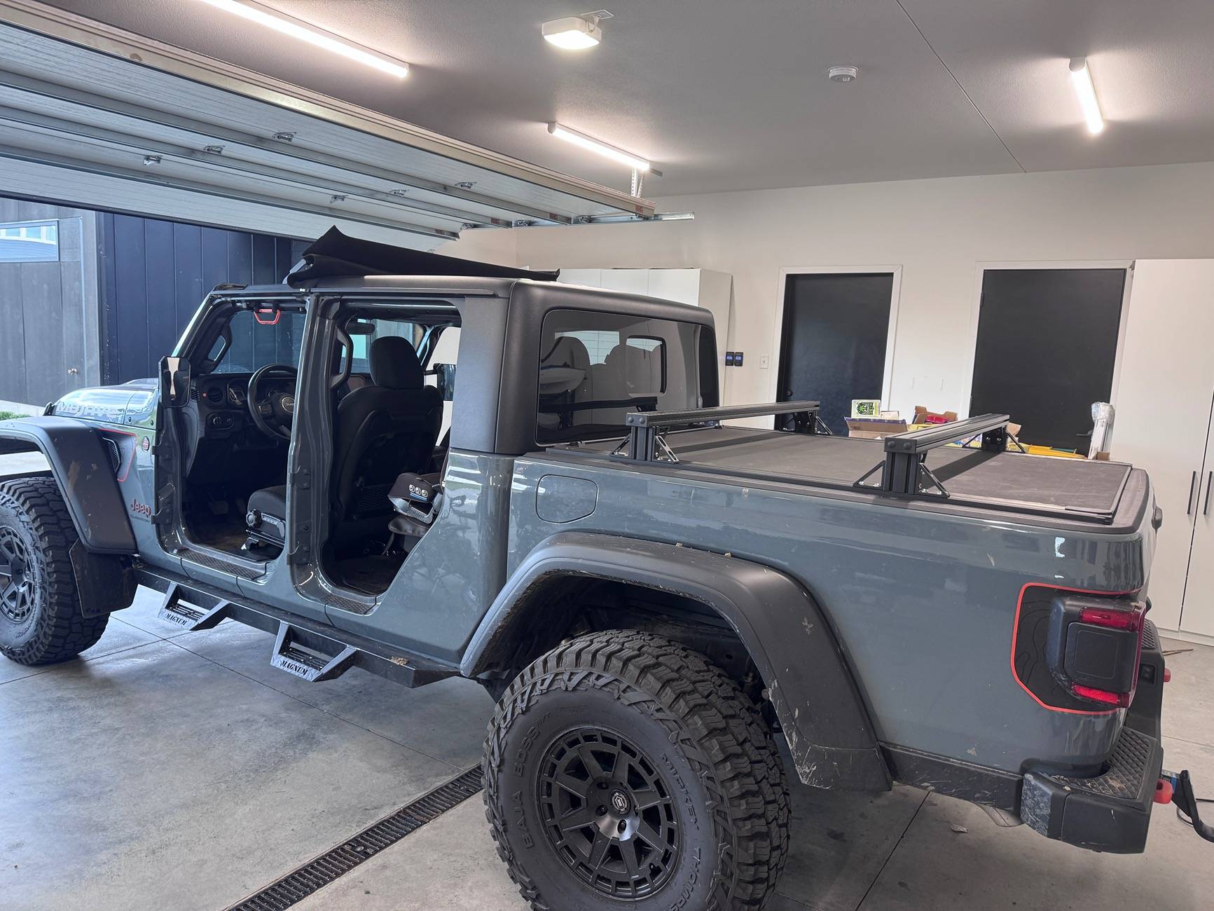

Wanted to share this as I got the idea from a different thread and liked the way it turned out. Spend around $300 and it is very sturdy. Used 59” crossbars and 4” risers. I ordered some quick fists, cargo box, and cargo basket to go on them when needed but I plan on leaving just the rack bare when not in use. It bolts into my backflip revolver rail nicely and takes a couple quick bolts on each side to remove. Probably 60 seconds to remove it. I hadn’t heard of Tnutz prior to the other thread on here and it was actually fun putting it together, felt like grown up legos!

Can you provide more details of what you did there? I'm looking to put something like that to go over by soft Tonneau cover to carry large items.

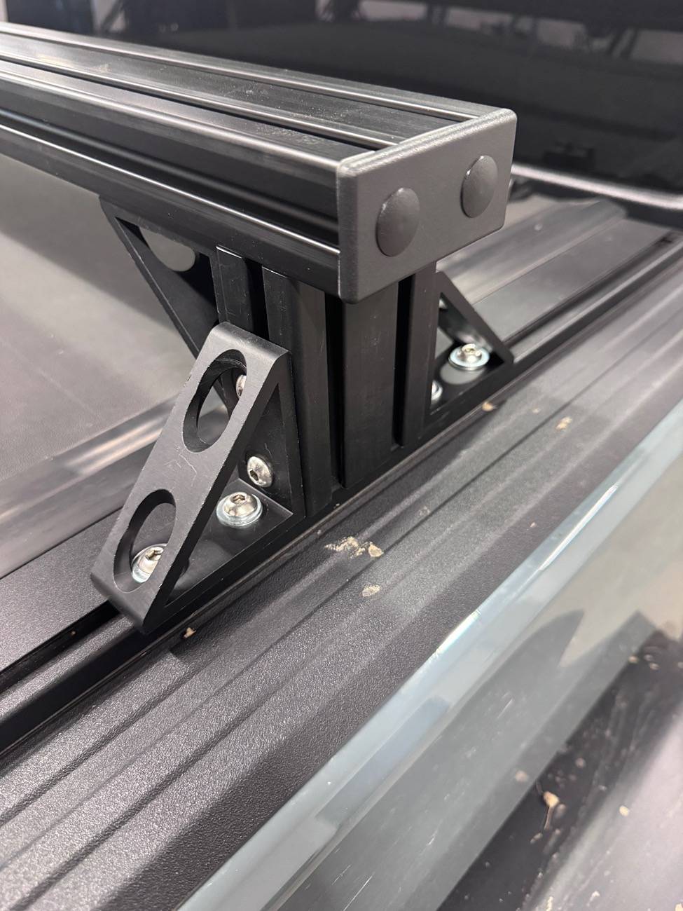

I literally can't tell how you attached this how about some close up pics. As it looks as if you drilled the bed rail which I don't drill the body at all .

https://www.tnutz.com/product/ex-1530-black-2/
I used this site to create the rack exactly as I wanted. I used the 1530 material for the bars and then I used the corner gussets on their site to bolt them together including plastic end caps and stainless hardware. It bolts into my backflip revolver rail easily. If you don’t have a rail, this setup won’t work. It feels stronger than the KB VooDoo rack I had before, which was also very strong.

If you don’t have the t-rail, go to Xtrusion Overland and get whichever bed mount you need - look in the different parts sections.
I have the X-O rack on my truck. Their t-rails are powder coated. I bought an extra rail from T-nutz and theirs are painted. X-O’s are better quality in my opinion.

Ya I thought of that but didn’t like the look of them being higher. I keep a ratchet and Allen bit in the truck to quickly loosen them and push to the front when I need to roll the cover.
Ordered a knock-off roam box and a small basket to mount on the top for road and camping trips.
