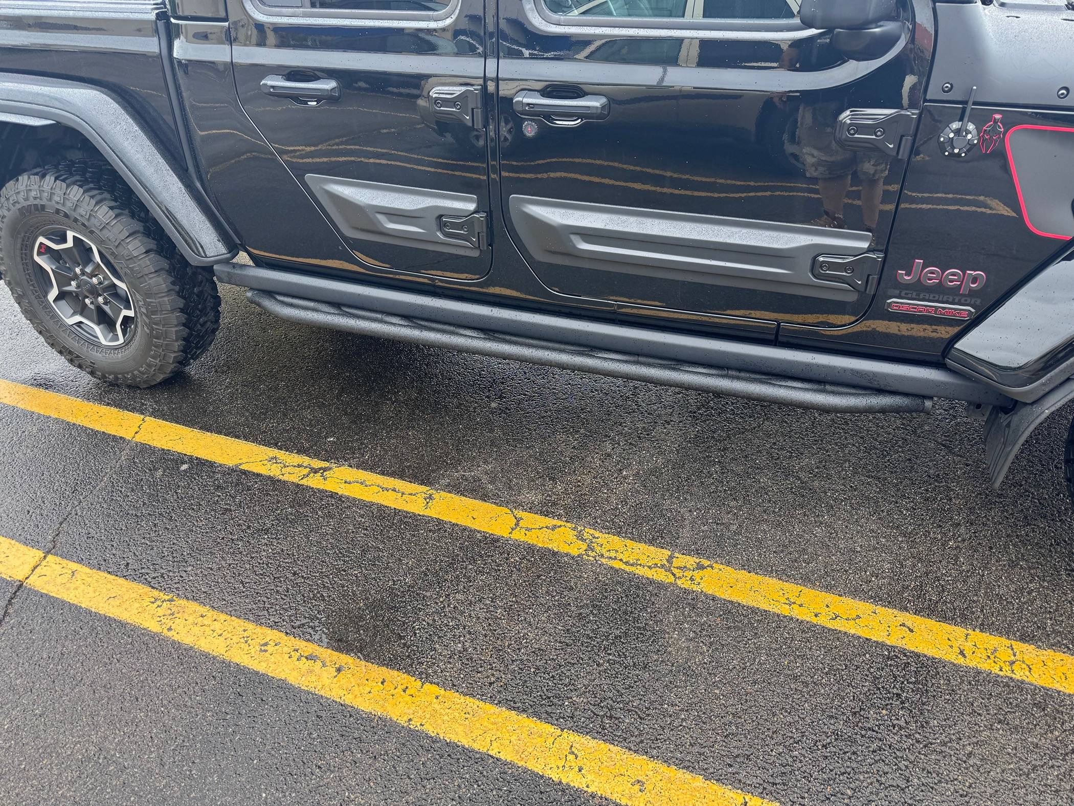

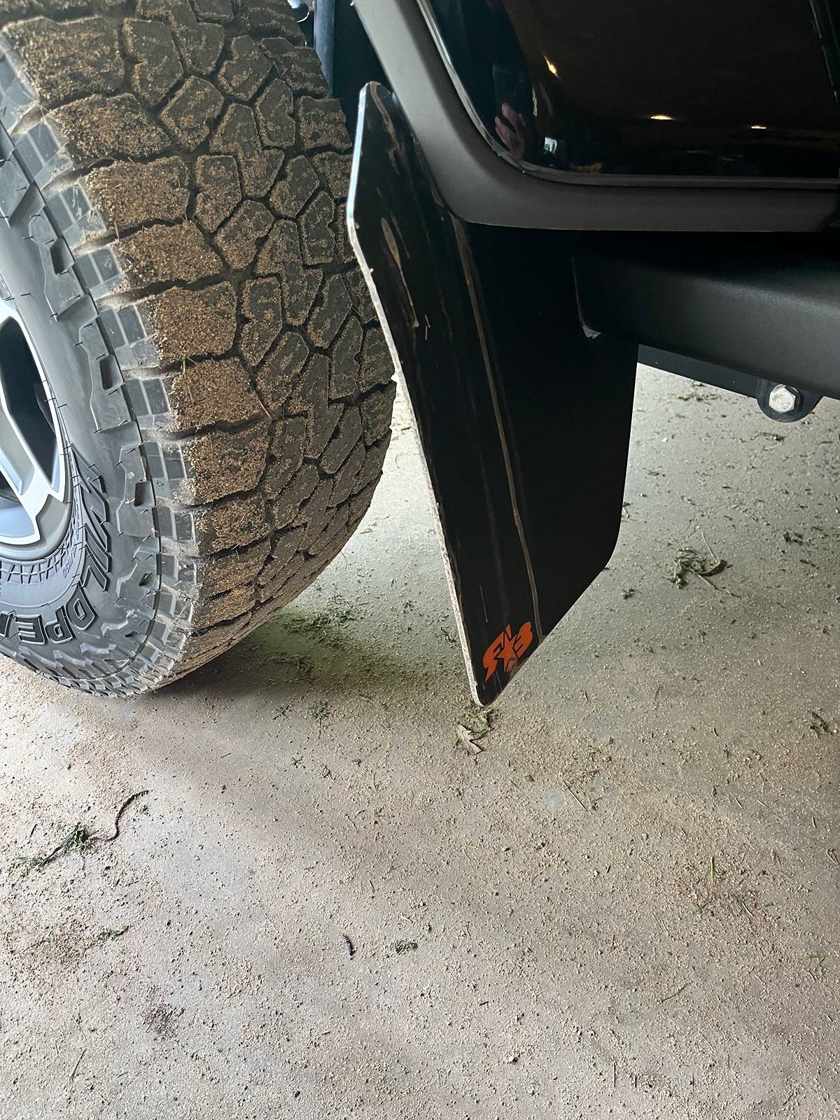

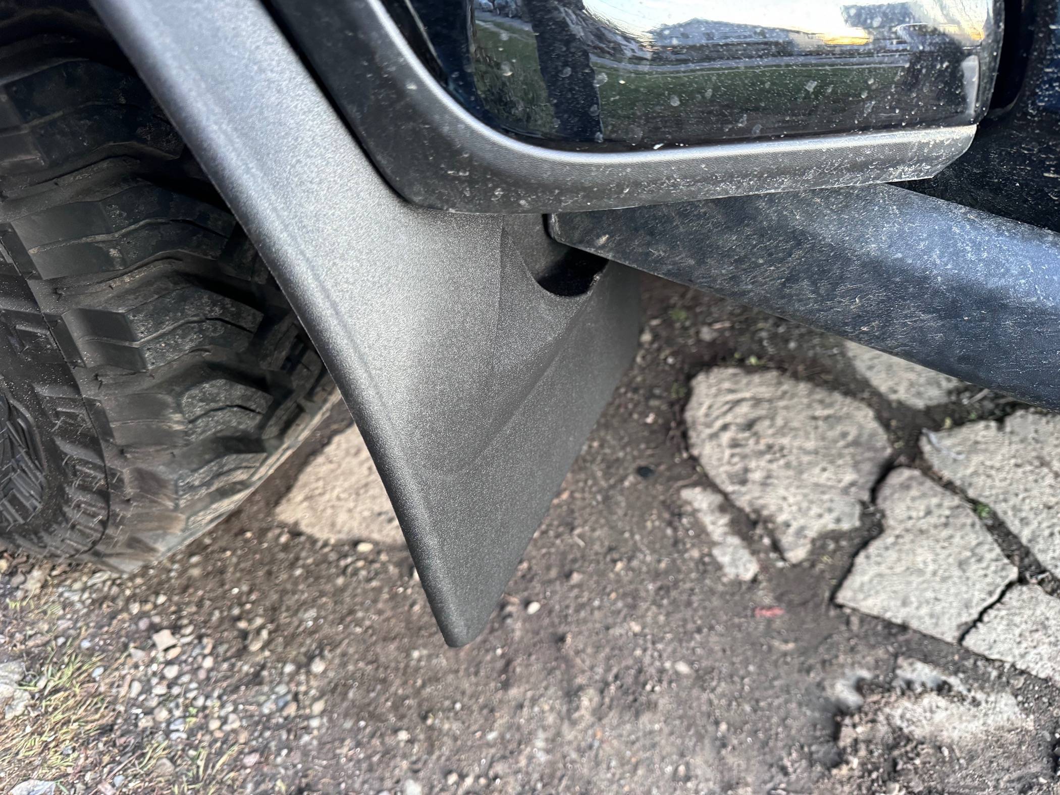

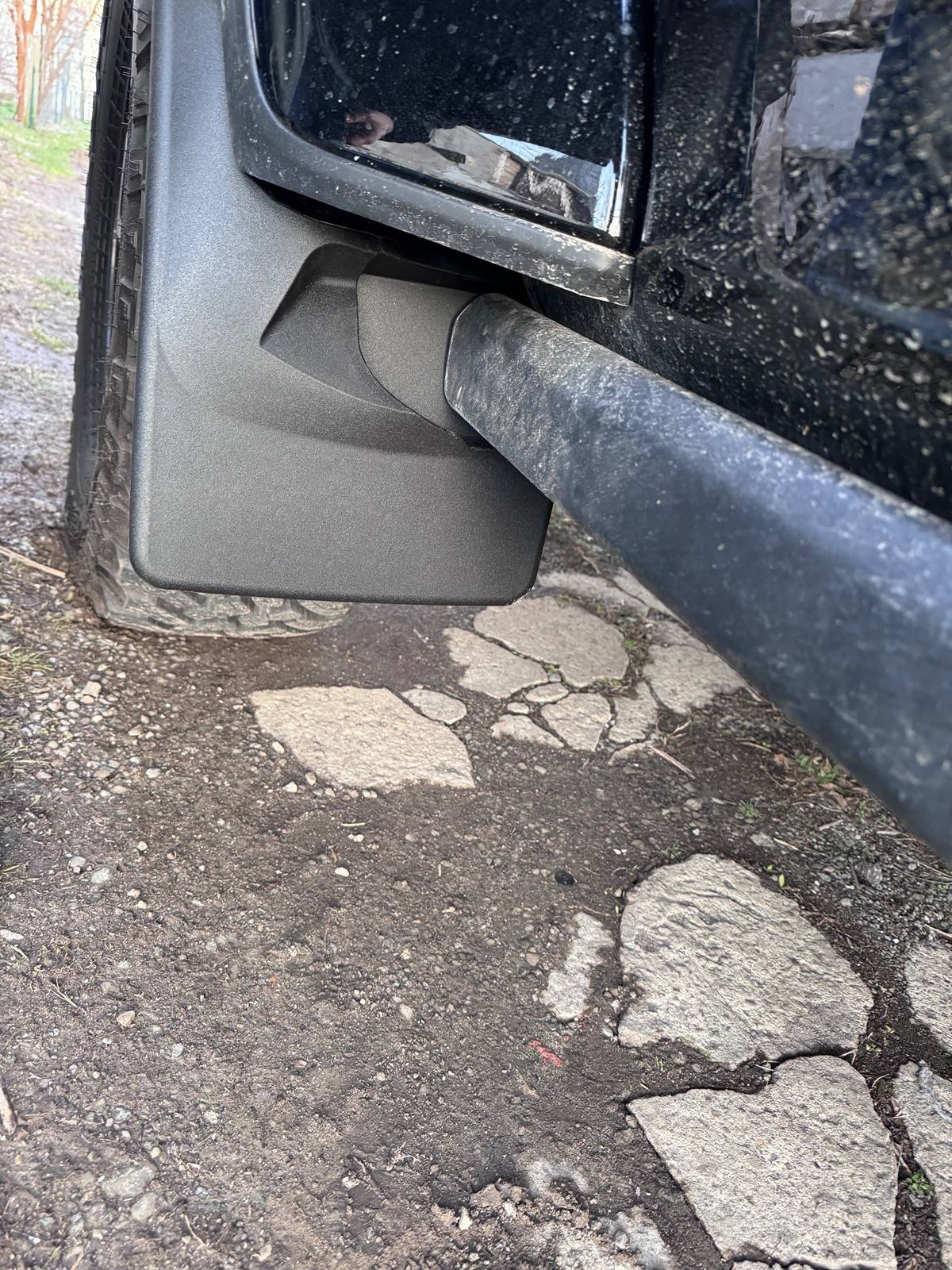

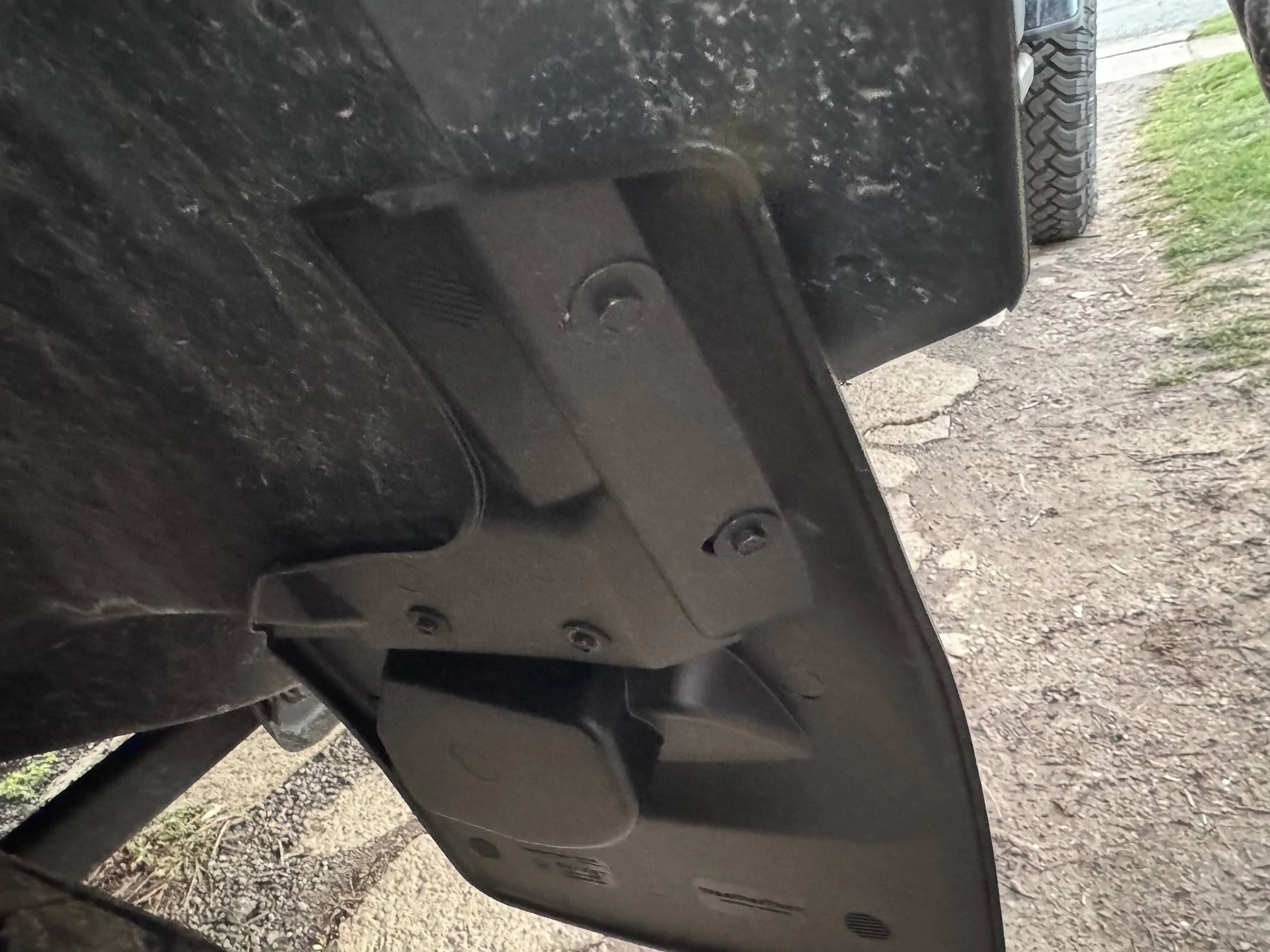

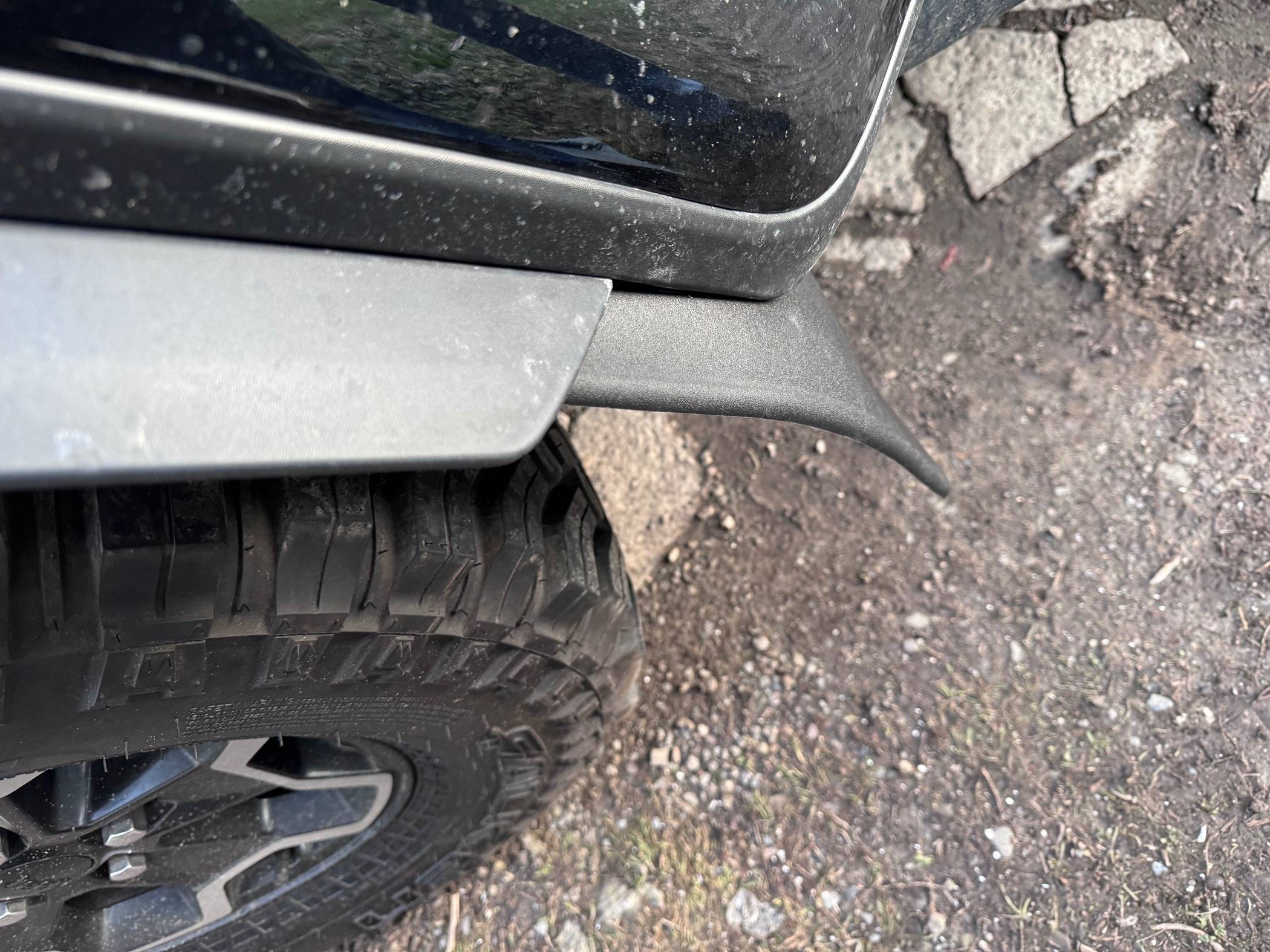

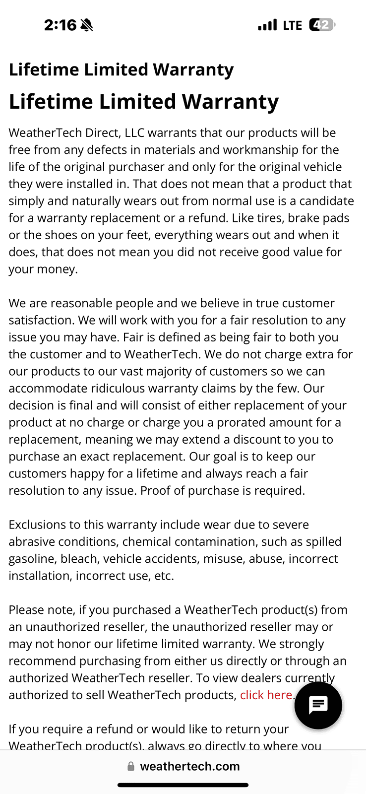

I have the weathertech fitted ones on. As I understand it, they are guaranteed for life. Zero sling on the sides of the truck anymore.
(Pics are from the day I installed them) last pic is after driving across town in A rainstorm

After driving in the rain.

I'm not worried about the warranty, I'd just rather have flexible rubber flaps
