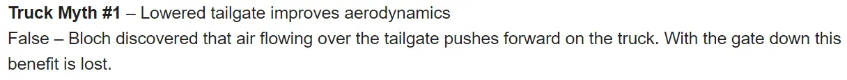

It doesn't help or hurt MPGs, this has been discussed numerous times. A bed cover will make no difference either way, just like riding with your tailgate down doesn't improve mpg's. If a bed cover would improve Mpg's then FCA would have put them on a JT standard to help them meet or exceed mpg standards. These post are funny though to read.
Look up myth busters I think they did a episode that said it made little to no difference either way

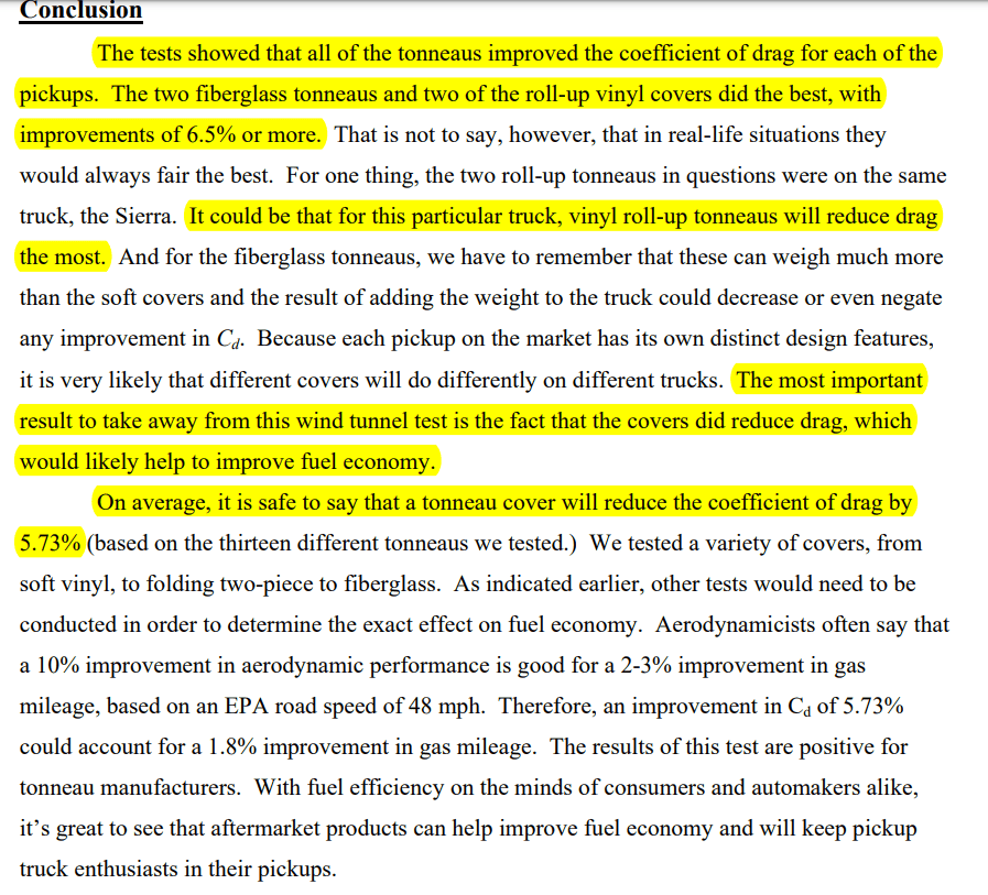

The Wind Tunnel Study
In 2007, the Specialty Equipment Market Association (SEMA) conducted one of the most scientific studies on this question. Their team tested four trucks of different makes and 13 different tonneau covers. The trucks tested were:
The 13 tonneau covers included all different materials of soft and hard covers. There were a variety of styles including roll up, retractable, folding and hinged. They decided not to release the data about any specific tonneau brands they used.
They tested the trucks in a full-size wind tunnel. They took their experiment to the AeroDyn Wind Tunnel in Mooresville, North Carolina, which is often used by NASCAR. The tunnel let them test how the trucks performed both with and without tonneau covers.
Their goal was to measure whether the tonneau covers reduced drag.
The wind study tunnel found that each truck had less drag when using a tonneau. The results weren’t huge, but they were measurable. On average, using a tonneau cover led to a 5.7% reduction in drag. That reduced drag meant about a 1.8% increase in fuel efficiency.
Even though 1.8% better gas mileage isn’t massive, it definitely makes a difference over a year of fueling up your truck. The verdict of the Wind Tunnel Study? Using a tonneau cover could give you a modest increase in savings on gas.
1.8% is going to save you maybe $60 over the course of 20k miles. Wanted to share this before anyone started questioning myth busters

GM and others have done more rigorous testing and found that the tonneau cover DOES improve mpg.
Real testing, not just short drives on a highway in a single truck, show improvements. These are longer studies using more covers, more trucks.

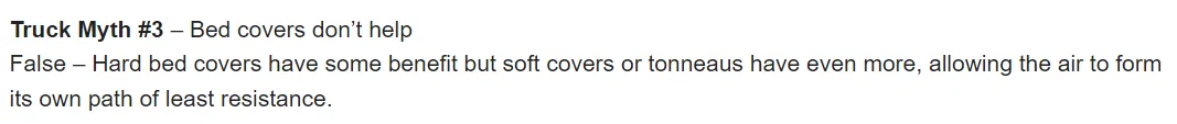

And one reason MB may not have been impressed with their test with a cover - soft covers help more than hard covers.
Jeep Gladiator Do I really need/want a bed cover? 1675788287137
Jeep Gladiator Do I really need/want a bed cover? 1675788431964
Jeep Gladiator Do I really need/want a bed cover? 1675788459085

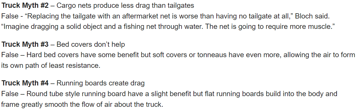

And finally, this from GM (others have said the same thing - covers help, soft covers help MORE)
Jeep Gladiator Do I really need/want a bed cover? 1675788583864

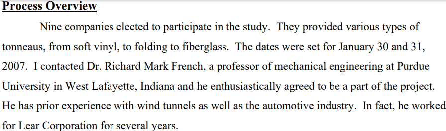

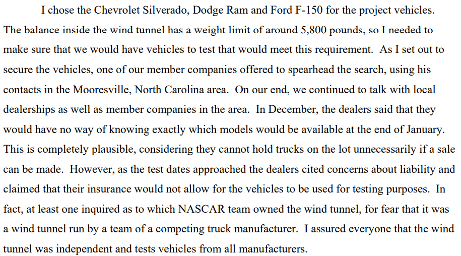

One of the sources of info I found was a study using multiple truck makes/models - Chevy, Ford, Ram. The one snipped I posted above in my prior message today was from that study.

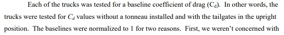

So here's their processes, the trucks used, and who participated -
Jeep Gladiator Do I really need/want a bed cover? 1675794864294
Jeep Gladiator Do I really need/want a bed cover? 1675794997405
Jeep Gladiator Do I really need/want a bed cover? 1675795049649

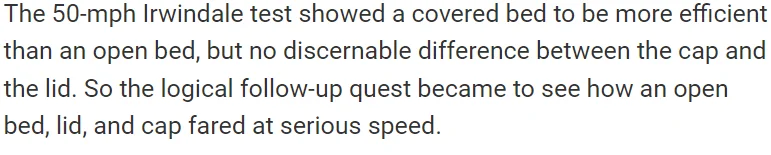

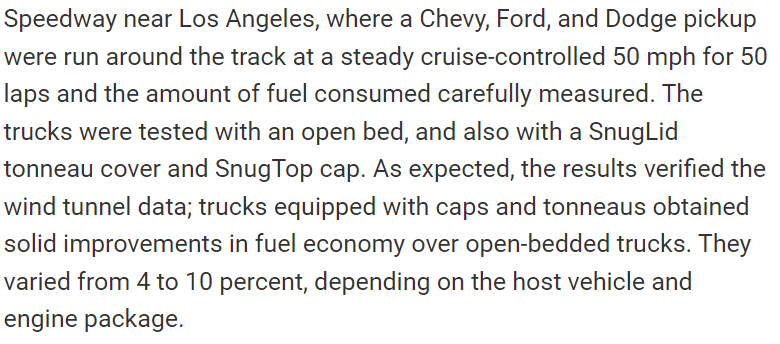

And unlike Mythbusters who only did one run each time at 25 and at 55 - this test was done at varying real-world speeds -
Jeep Gladiator Do I really need/want a bed cover? 1675795113892

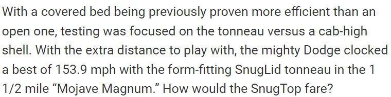

Even MotorTrend makes this comment -
Jeep Gladiator Do I really need/want a bed cover? 1675795266484
Covered bed previously proven more efficient.
Pretty much sums it up.
