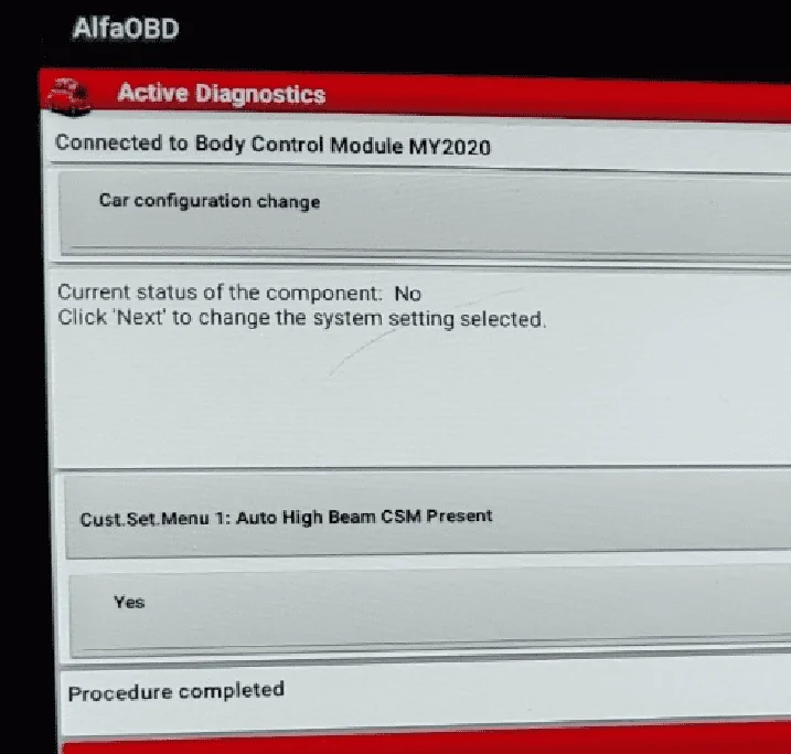

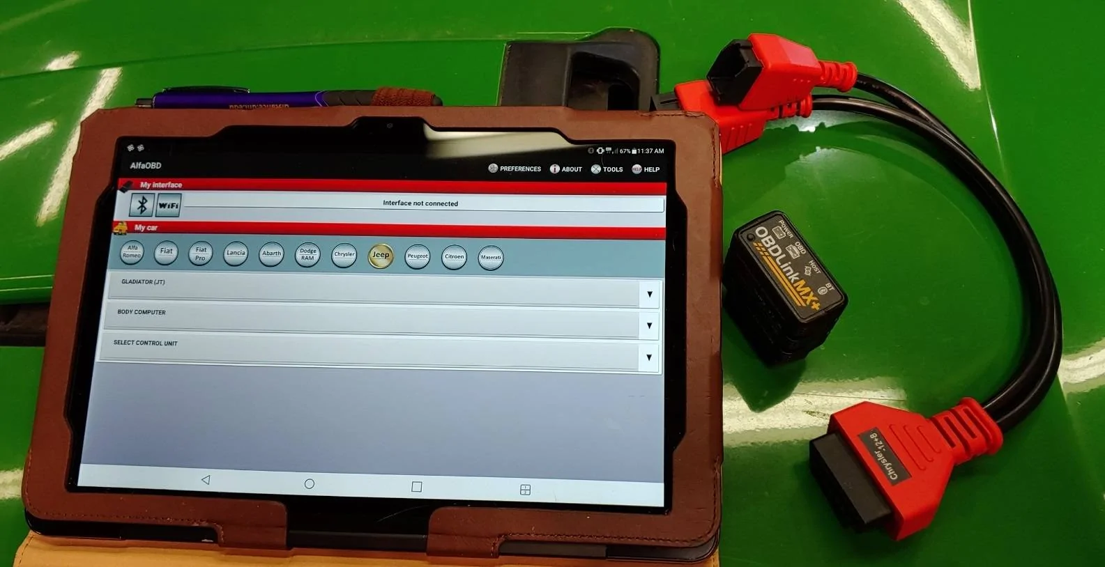

I got Alpha back when I had a Ram before the Gladiator and I did all kinds of things with it. Absolutely recommended (or Jscan). I'm not as familiar with Jscan, but I recall Alpha was pretty particular about the bluetooth adapter.
I tried a couple that didn't work reliably and eventually just got the MX+ they recommended. It wasn't the cheapest (more expensive now), but it works reliably..
Having said all that, I also have a Taser which I do like as it does a few things that aren't available with JScan and Alpha, primarily the live functions.

One comment, if you have the Tazer and wants to use any other ODB software like Jscan later, you don't need a security bypass cable. The tazer can act as one.
I know this because I have both.

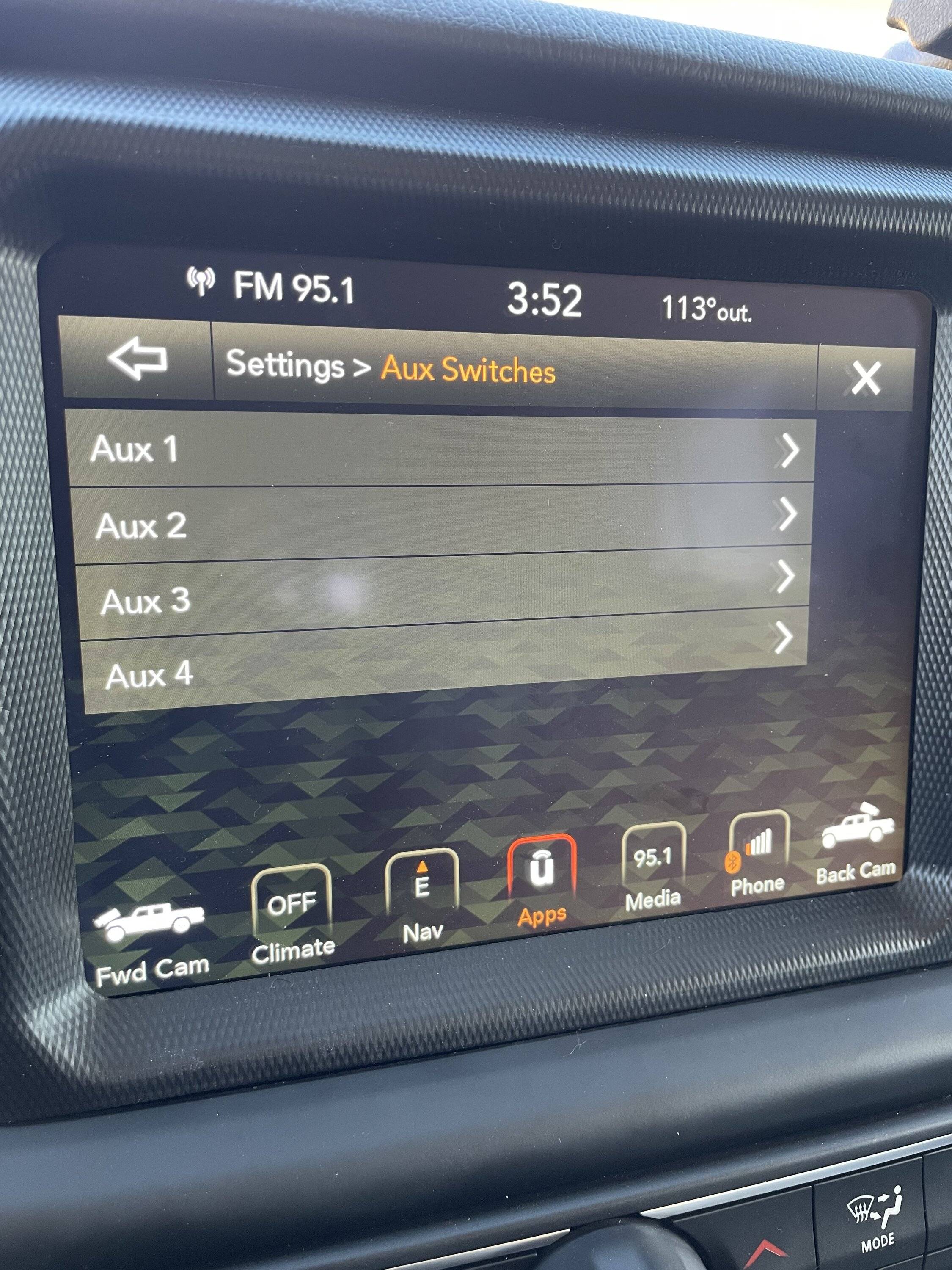

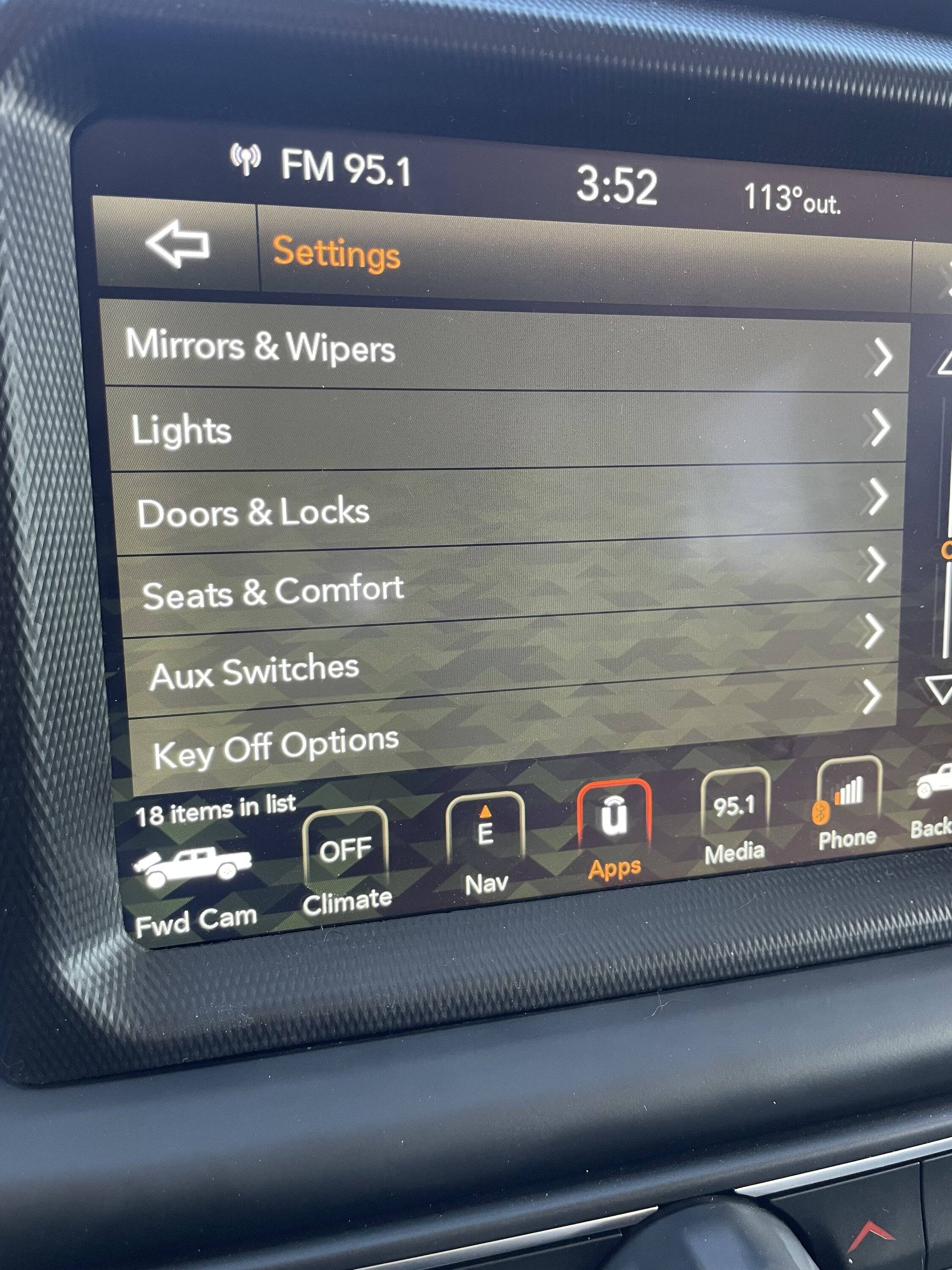

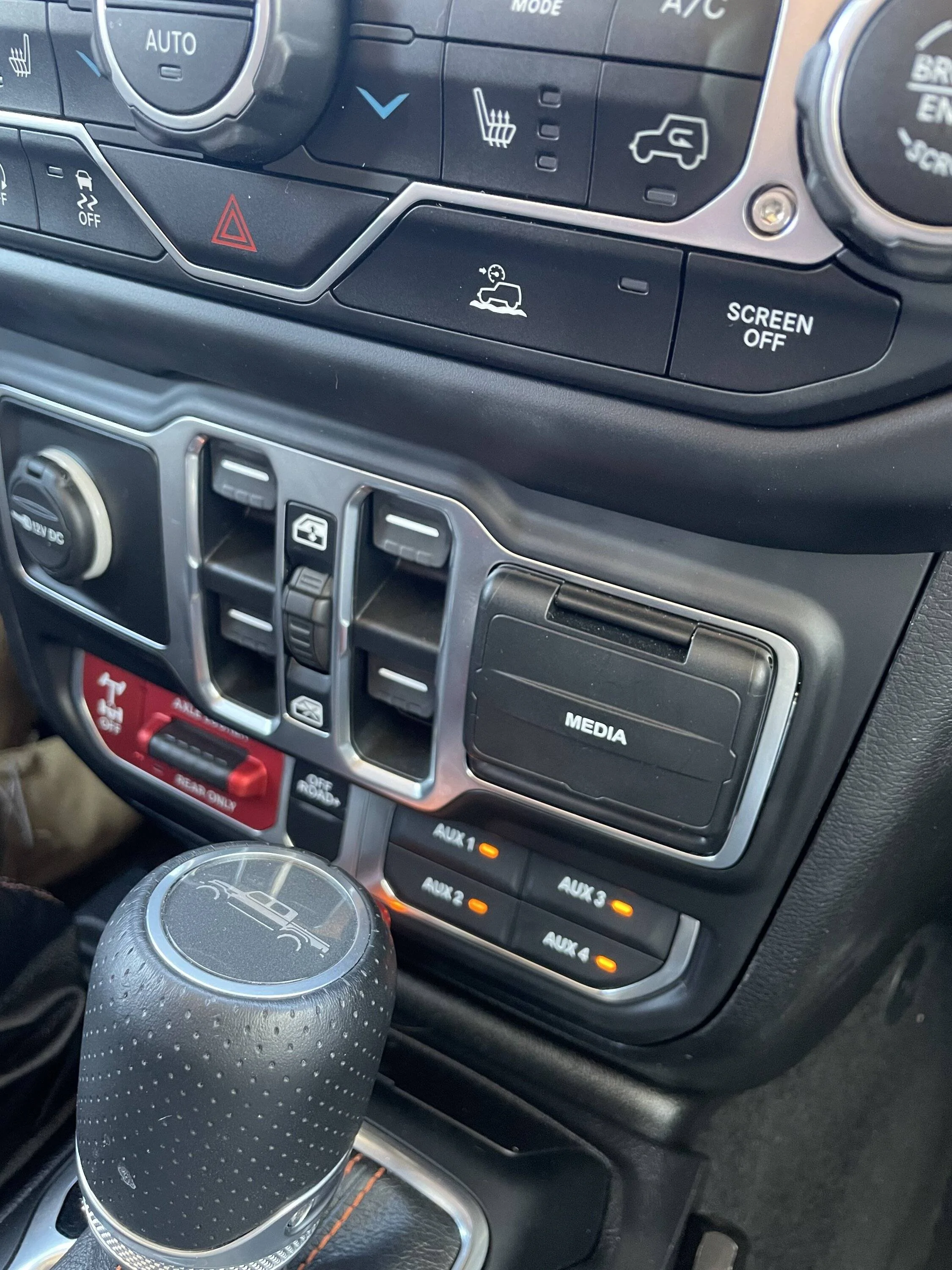

Guys the jobs done! Mopar switches installed and everything is tip-top. It took a little while after I turned on and off the vehicle a couple of times to finally bring up the Auxillary Switches in Uconnect after turning them on with JSCAN. Once they were on screen I still didn't have power to switches. Checked all fuses (good). Checked Orange wire under passenger side kick panel and that was the problem. Grab a small screw driver and pop the white plastic cap out of the connector. Take a good look at wire and reposition. Pop white cap back in and marry the two sides of the connector together and Tada! All good. Here are the links to products. Easy job. Don’t throw money at dealer.
https://store.mopar.com/oem-parts/mopar-auxiliary-switch-bank-silver-82215798ae. On sale $315
https://www.amazon.com/gp/product/B08ZL4LRVK/ref=ppx_od_dt_b_asin_title_s00?ie=UTF8&psc=1
https://www.amazon.com/dp/B06XGB4873?psc=1&ref=ppx_yo2ov_dt_b_product_details
Also purchase VIN # in JSCAN $20.99
Total cost installed by myself, including tax = $430.50
Additional note: the plastic fittings that secure our dash panels are pretty weak. If you happen to bend a crack in one like I did on the steering column lower cover, just weld it up with a wire soldering gun. Look up plastic welding. Can get you back good as new, no worries. Cheers???

Finish pictures.
Jeep Gladiator Do Mopar Auxillary Switches Light Up When Pushed? E16CA127-202C-41BD-A302-7715535DEAEB
Jeep Gladiator Do Mopar Auxillary Switches Light Up When Pushed? B0C21318-8205-4E2A-B51E-7A4D86A0ACB8
Jeep Gladiator Do Mopar Auxillary Switches Light Up When Pushed? A83EB21F-5AD8-485F-8E07-6B58DCDA3769
