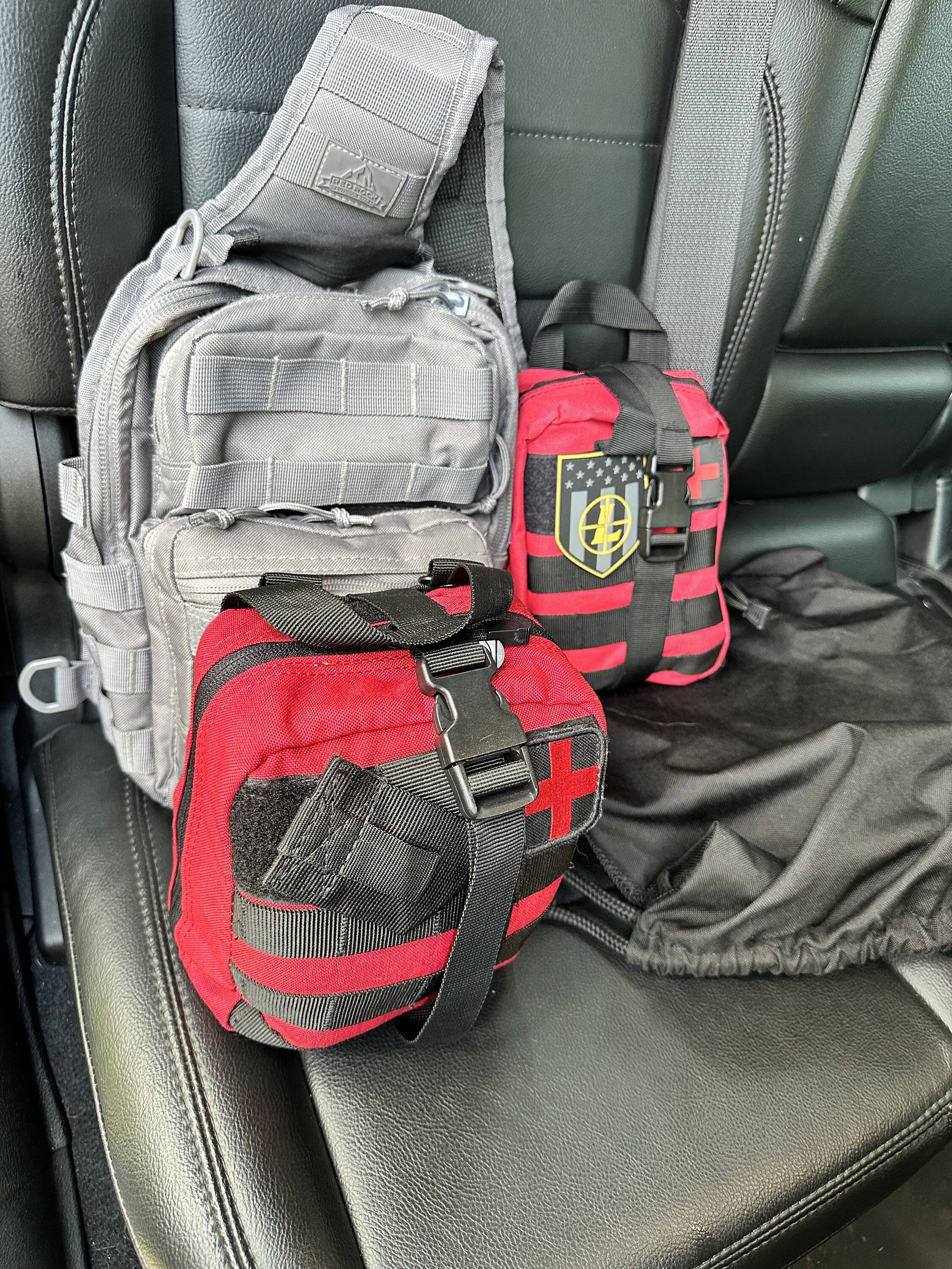

I have a my medic mini pro kit. Has all the basic essentials in an easy to use and well organized pack. I think it's important to not forget how crucial a well organized system with easy access can make a huge difference in an emergency situation. The system is color coded in a booklet that you can flip through. It's also velcro'd to a molle web panel that you can just rip the pack right off without having to mess with the straps.
