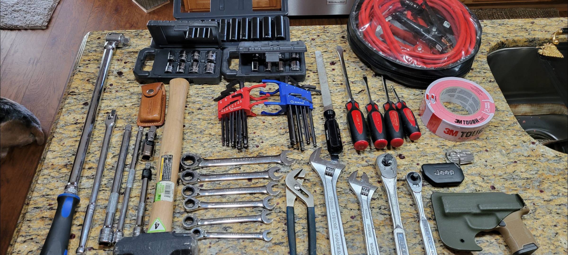

My Jeep's EDC, put this together when I first got my Gladiator. I have added to the mix and need to update. I do carry additional items like a torque wrench and a battery powered impact gun on longer/offroad trips. The storage area under the rear seats is packed with goodies.
is that holster for the keyfob?
