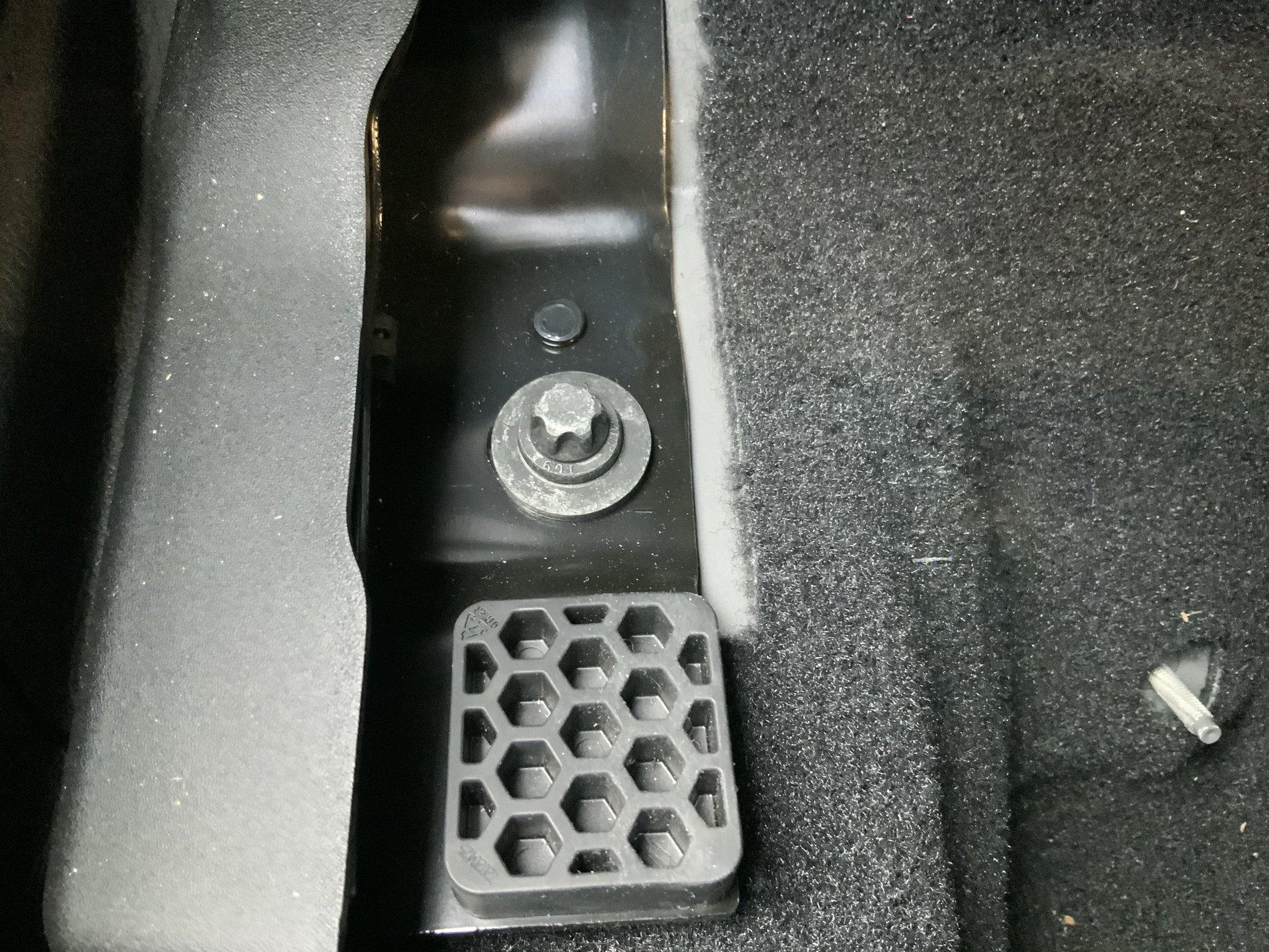

I want to remove the rear seat and build a platform to put my stuff so l need to remove these bolts but I don’t have a socket like this.
Does anyone know what kind of socket would work with these bolts?

In a pinch, try fitting a 12-point socket...not sure of size, so metric could fit better than SAE.
Those bolts are hardened, so it's unlikely you'll round off those points.

On the bright side is as said harder to round off. Unlike earlier jeeps.... Blanking seatbelt bolts!!! They strip out often..:mad: to include TJ's
FYI: Harbor freight has the correct bits for them fairly low cost, might be good to have, I haven't looked but that type is used on some brake caliper's and hubs too.

I have seen them usually called external Torx, sometimes E-Torx.

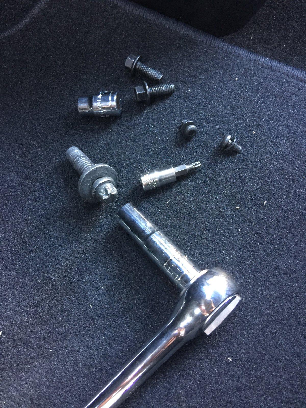

https://www.jeepgladiatorforum.com/forum/threads/rear-seats-removal.22980/
From the above thread...
Tools:
* E14 Torx socket (female) - I got a set at Harbor Freight for about $9.99 before the 20% discount coupon. Suggestion: don't get the deep socket as they'll come off the Torx nuts too easily as it takes a good-to-great amount of force to break them loose.
* Breaker bar - ⅜" Breaker Bar at Harbor Freight - it's not necessary but it was a huge help in breaking loose two of the rear Torx nuts - it's $9.99 before any discount coupon
* 10mm socket - to remove the 2 bolts that hold the rear seats together
* T20 Torx (male) screwdriver or socket version - to remove the 2 screws holding the plastic seat base shroud
You can see the 2 sockets and the Torx screw (socket version) and the hardware here:

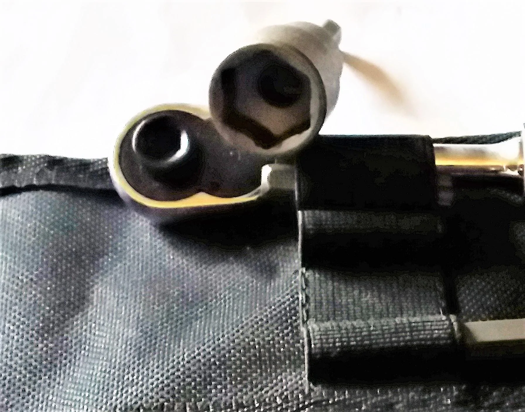

Look in the little tool kit that came with the vehicle, it's in there.
Jeep Gladiator Does anyone know what kind of bolt this is? 20211122_131504 (2)
This may very well fit but it is not the E-14 Torx. This is provided in the kit to remove the windshield wipers when removing or folding the windshield down.
