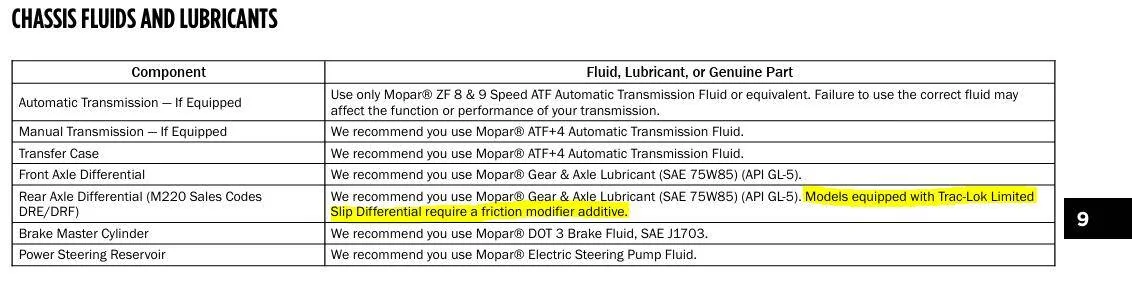

Granted, with a locker I don’t technically have lsd, but it calls for the modifier. I’ve never added extra and never had knocking.
The owners manual states friction modifier is required for Trac-Lok equipped axles. I don't see it mentioned you need it with your Tru-Lok locker. Where did you see it was needed?
