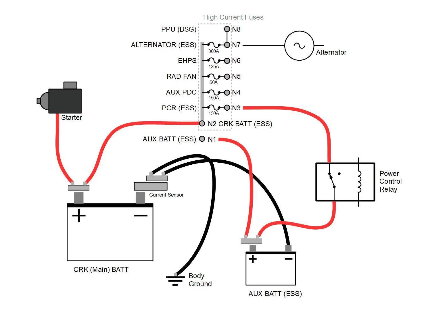

I think I downloaded this from a thread shadow Pappa, participated in. This might be his schematic either way great visual when just looking for a simple jeep dual battery schematic.
Jeep Gladiator Does the main battery call the shots? 36L dual batteries

Thanks, the visual helps.
