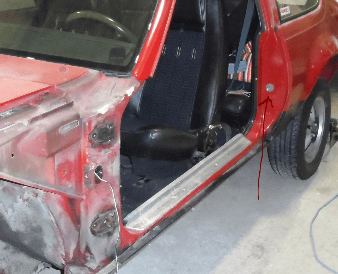

IF its a real issue I've found the best bet is to pay a good body shop to do the adjustment. I normally do my own but in the case of my show car the shop did it for me when I had them touch up the hood for a rock dent - they did it no charge but then I'd paid them well for fixing the hood and blending in the paint so well.
Every latch I've dealt with was held in by countersunk head screws/bolts and only the striker could be adjusted.
I'm used to latches that are set by the screws, door hinges that adjust 360 degrees and then some, and a striker that adjusts pretty much any direction and in a fair amount.
