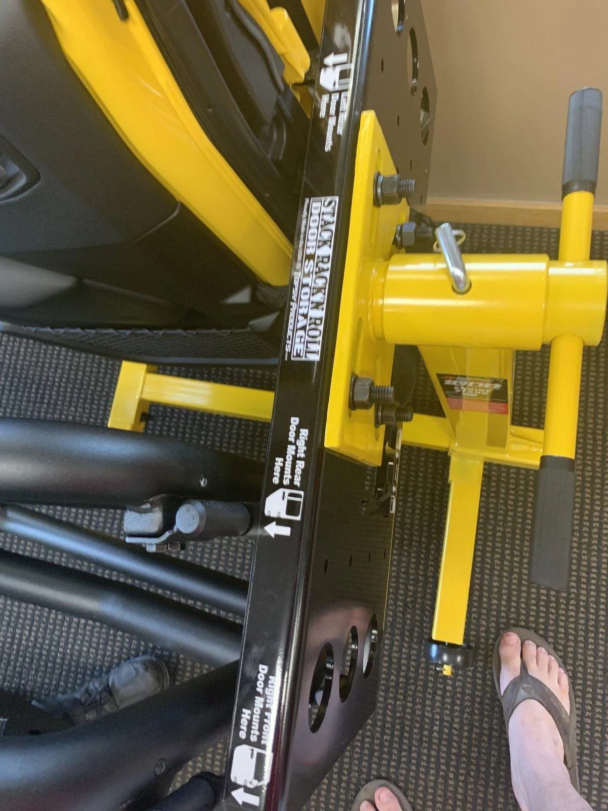

I use an engine stand and this attachment from Stack back n roll
