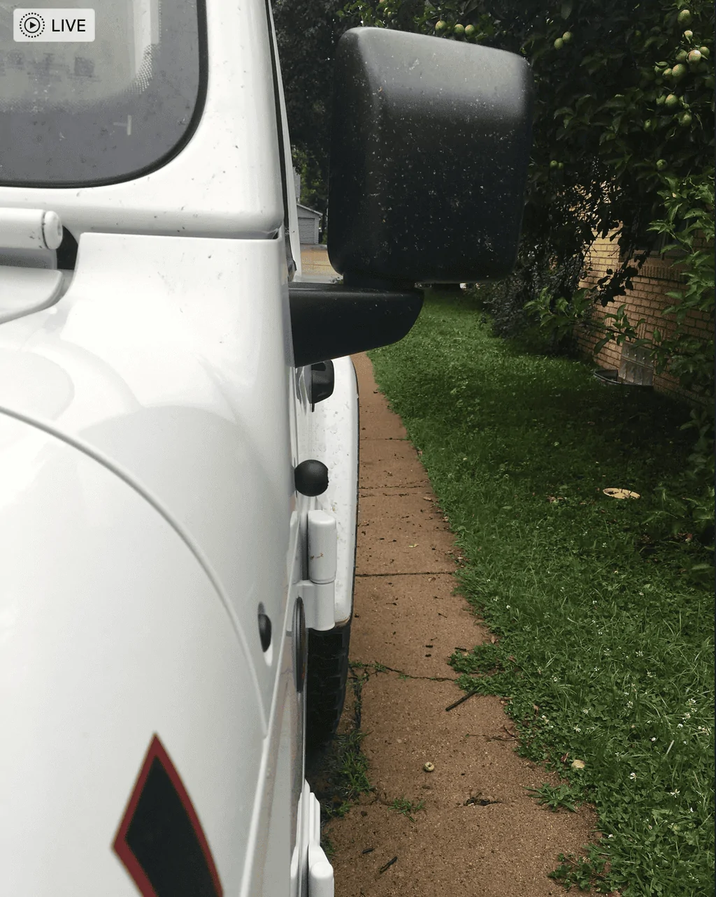

Silly question I know...but can someone post what / which mirrors you are using for doors off mode? I am in D status and getting distracted shopping for stuff...
jhale1800
James
Mar 14, 2019
378
605
Huntsville, AL
Gladiator Overland, 2000 Ford Crown Victoria, 2011 Hyundai Genesis Coupe, 2017 Mazda3
I haven't purchased yet, but I'm between 2 options.
Ram Ball mod that's discussed in this thread on the JL forum:
https://www.jlwranglerforums.com/forum/threads/doorless-mirrors.5579/page-11#post-697067
or these ATV mirrors mounted to the grab handle.
https://www.amazon.com/dp/B00898LAJ0/ref=cm_sw_r_cp_api_i_DaMiDbVQT278H

Interesting idea on the ram ball mount. I have those same mirrors for my dualsport bike. Only downside is a ball sticking out all the time...probably not a big deal.

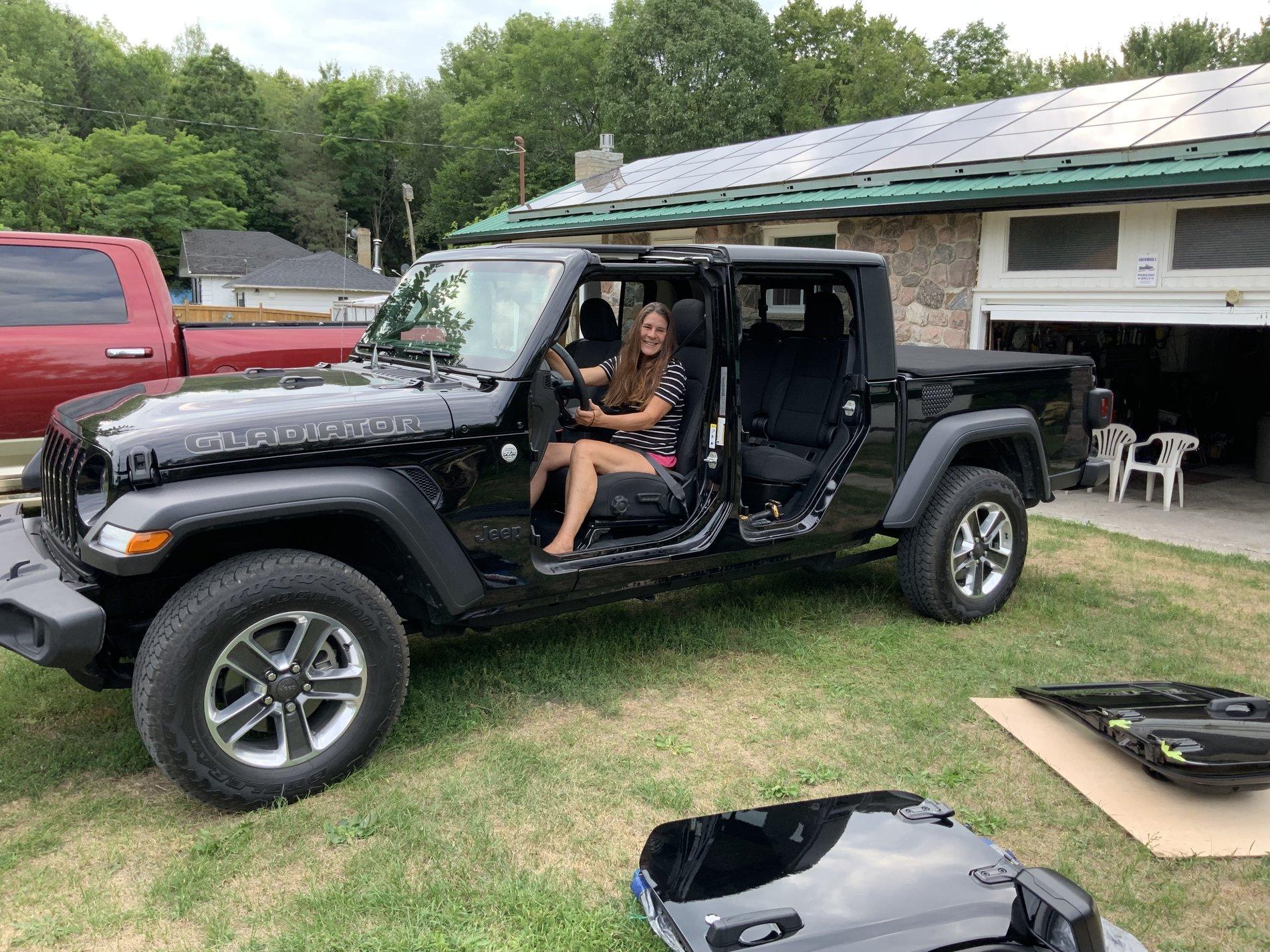

Glad I took off doors, bone dry hinges wearing in 2 weeks, put black locators on top hinges , works great
Jeep Gladiator Door removal ideas/questions 96F7BA41-EDDC-44BB-B8E4-24D85AFB4508
